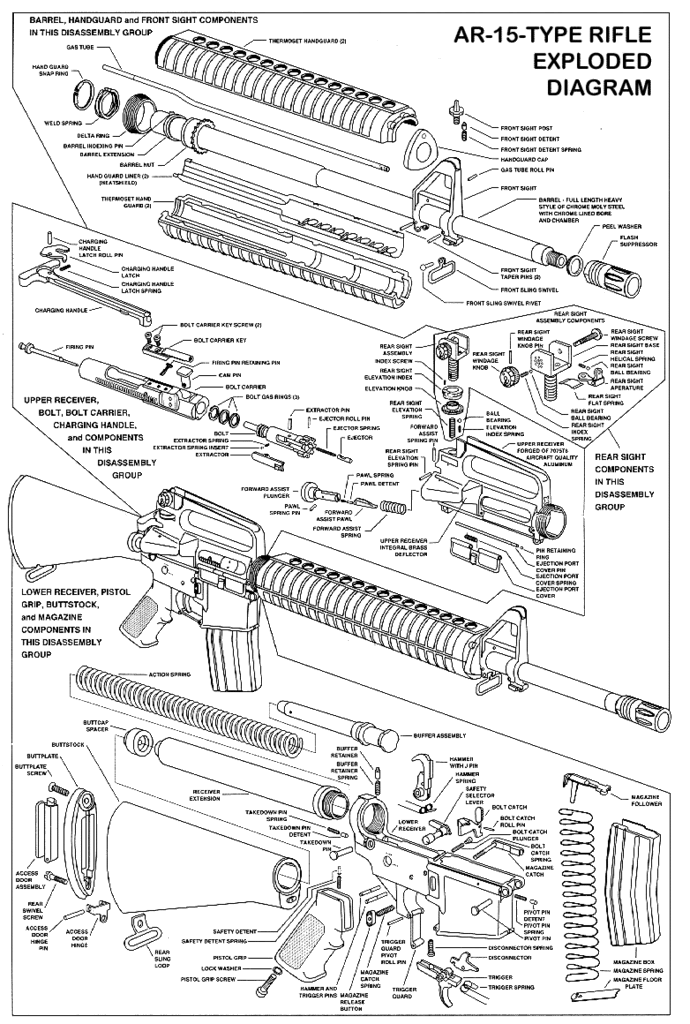

1. Get a stripped lower - whatever flavor you choose. I have Eagle/Armalite, Bushmaster, Stag, Rock River. There's others, and I think this is of less importance than some other parts.
2. Get a lower parts kit - again, many quality parts out there. The only thing I'd consider changing is the trigger. The spikes battle trigger I think is an improvement over a stock AR trigger from a parts kit, though you can get decent triggers in kits.
3. Decide and get which buttstock you want - A2? Collapsible? Something fancier yet? Lotsa choices here.
You have your complete lower. Now to the upper.
Are you wanting to buy a complete upper and bolt it on???? That's easiest, and if so, I'd just get a kit that has the LPK and buttstock you want, along with the upper you want. (and skip #2 and 3 above)
If you want to build the upper too...........
4. Gotta buy an upper - you said flat top I believe
5. Decide on a length of barrel and what barrel profile you want. You asked about chrome lined - increases durability but decreases accuracy, or at least that's what I have found in my research. I personally choose non-chome lined barrels. I don't shoot enough I'll ever shoot a barrel out! Don't forget a bolt carrier group and charging handle
6. Handguard?? Rail?? More decisions, which make the AR so customizable. Don't forget the gas tube/block/pin
7. Sights?? Even with optics, I would think you want BUIS
By far the easiest is stripped lower, and a complete kit. Probably cheapest too. But then you might not have exactly what you want. But easy to change parts. I took a GG&G Dominator upper, and traded out the railed forearm for a free float railed forearm, and sold the original. So, you can change whatever you want along the way too.
