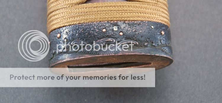

It began with me deciding that as a cornerstone of the piece was this antique fuchi (collar). All measurements and styling flows from this central piece. It was not an easy beginning due to the width but provided a source for a lot of inspiration.

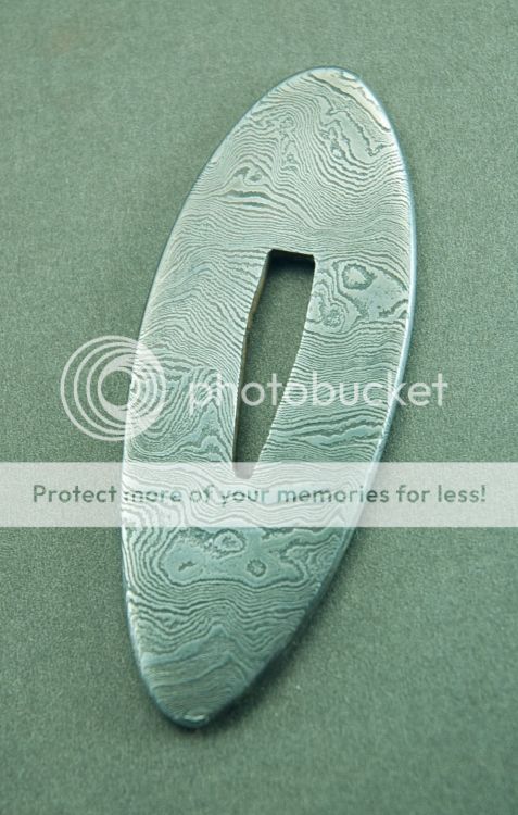

For the wood I used "waterfall" bubinga to keep in the water theme. For the tsuba or guard I forged it so that the laminations would show in the width to try to emulate the look of a rolling sea.

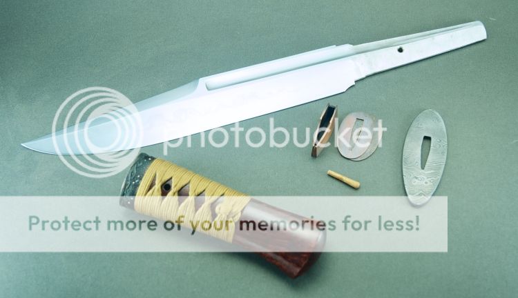

The blade is W2 and I used a hybrid geometry of a naginata style of blade but with a dropped top sharpened clip (hence the fighter designation)
I went for a stormy seas look in the hamon. My 6 1/2 year old son came down while was working on it and said "it looks beautiful Dad,... it looks like the ocean" so I take that as mission accomplished.:d
The habaki was shaped to look like the crest of a wave.
True to Japanese pieces, this is a take down in the Japanese fashion and held together by a smoked bamboo mekugi, or peg.
