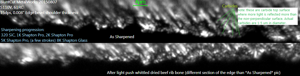

A follow up, which might interest some of you.
S110V 61RC, 15dps, 0.008" edge thick. Sharpened progression: 320SiC (apexed), 1K+2K+5K+8K Shapton.
Pic of edge *as sharpened* and after some light push whittled dried beef rib bone. 'light push whittle' is mostly as push cut with lateral load to initiate the cut.

Bluntcut, thanks for the pictures again. Those really help me understand things better in a thread and keep lines of words from skipping around as I'm often on after little sleep.
One thing I found from back in the day of trying to find out why my S30V was micro chipping was when I went up the line grit wise the first couple jumps could change things. Now I never go from 300 to 1K without one or two stops. I'd do a stop at around 600 grit, then again at 800 grit making sure that the sharpening was not done with too much pressure, especially at the coarser grits. When one gets up to the finer grit levels this becomes less important IMO. *Note* especially if beginning at under 300 and or using fast cutting stones.
The higher carbide the steel the more important this becomes IMO. Coarse grit stones used with too much pressure can set the edge up for early failure later.
I'm not suggesting you or anyone sharpens incorrectly but I do want to get this in this thread for future readers just learning about steels and sharpening. Because of this title people will likely be seeing this thread for years.
