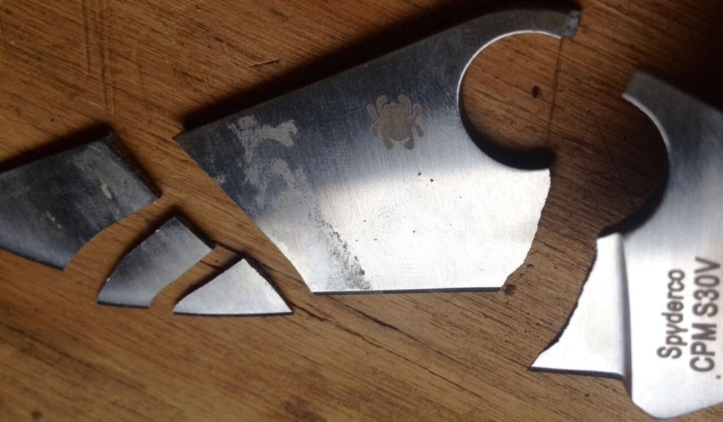

maybe not always, but I do have one extreme failure of S30V I was present for and I can easily say I've seen plenty of 440C, AUS8, 8cr13mov and a few other woker grade steels do plenty of times. It's not uncommon to use a light baton like a green stick to cross baton another stick to make it stake length or do a notch with an unlocked blade where the diameter is less than the width of the blade, so it's being hit only where it's cutting. I've done it at lest a dozen times with my current 8cr13mov blade and it does perfect. It's actually some pretty light duty.
A buddy who is in love with "super" steels wanted to prove the superiority of his S30V blade. He did one and the next stick shattered the blade. Maybe he hit too hard or had a bad hit, but I can tell you a stronger steel can survive a bad hit for that task. The blade broke like it was a ceramic blade being used.
We collected the pieces and this is what a just under half inch stick whacking the spine did to it cutting another stick to length.

Honestly I've had and or used S30V from 3 different manufacturers (4 if you include leatherman and I don't) and each one performed pretty bad for me too. Maybe each manufacturer just cannot really hit the heat treat right, but then that'd be insulting to the companies that produced them. Maybe they hit the heat treat pretty well and S30V is just not that good for anything but close to perpendicular cutting through clean, soft stuff. Who knows. Maybe there are just too many variables without any real conclusions that can be reached and the whole YMMV thing should come into play. But then what can we tell a new guy looking for a good knife? Ankerson's tests only measure one (important) aspect of a knife. What about the other aspects? A guy like you will come up with a very valid reason why S30V may not be the best choice and then you're dogpiled for using your folding knife too hard or whatever when there's clear evidence that another steel could easily handle the same task without breaking.
But I don't know, I don't believe you. I don't believe you cut only green wood and that caused it to break. I believe you were smashing the knife against a cinder block and rolling it over with steam roller. I also believe it was probably counterfeit knife. Your experience is different than mine so you must be wrong and stupid. :)
Joking aside, that spyderco logo looks a little weird.

Boris, do you still have access to those pieces of broken s30v knife? If yes, please post a closeup shot for these surfaces. I just want to learn w/o make & break s30v coupons/knives... Thanks
Something's not right about that blade !! I would suspect it may never have been tempered ! It has to be very brittle to do that !
Send it back to Mr Spyderco .
Looks like a counterfeit to me so likely not even S30V.

Uh something ain't right with that Spydie and I'm not talking about it being broken
Spyderco tends to focus on wear resistance and makes their knives more brittle and therefore less tough to achieve that end. It isn't the first broken spyderco I have seen. Don't mistake Spyderco for a sharpened prybar company.

If it is in fact a counterfeit, then what steel would it most likely be?
It WOULD likely be 8cr13mov, the irony being that its the same steel in his post that can handle this batoning that S30v supposedly couldn't.

What about it looks like a counterfeit?
The logo, writing, and choil don't look right. Compare the "S" in spyderco on both knives. That should show what needs to be shown.
And like what they said earlier the way, look at the way the steel broke apart. Zoom on on the photo ans look at the chips along the crack lines. If that's a cpm steel then someone nuked the hell out of it.
Vs this. Now that I look a little closer it doesn't look like it has jimping either.

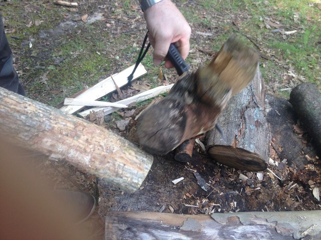

Honey locust before (during).

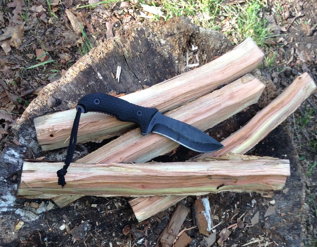

And after

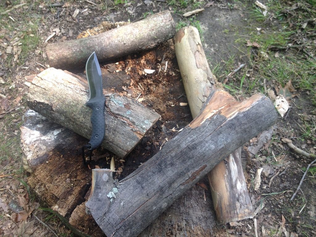

Next pile to work over. See that big bulgy knotted piece on the bottom?

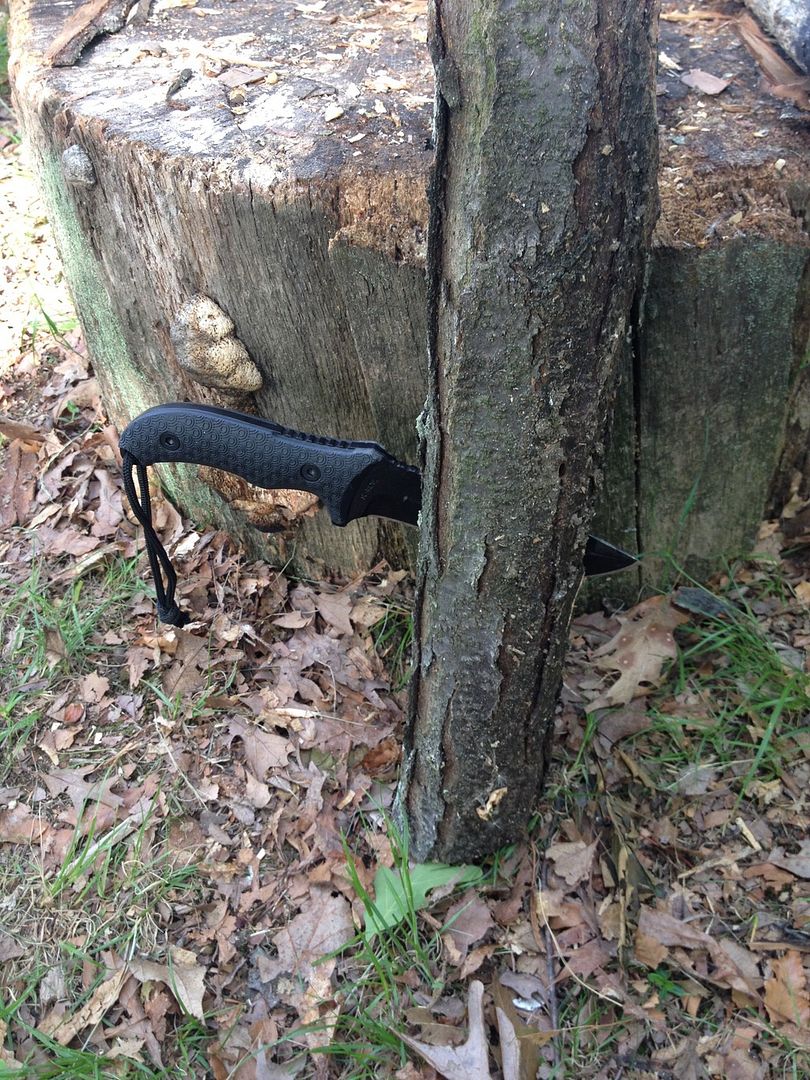

Working it over in this one.

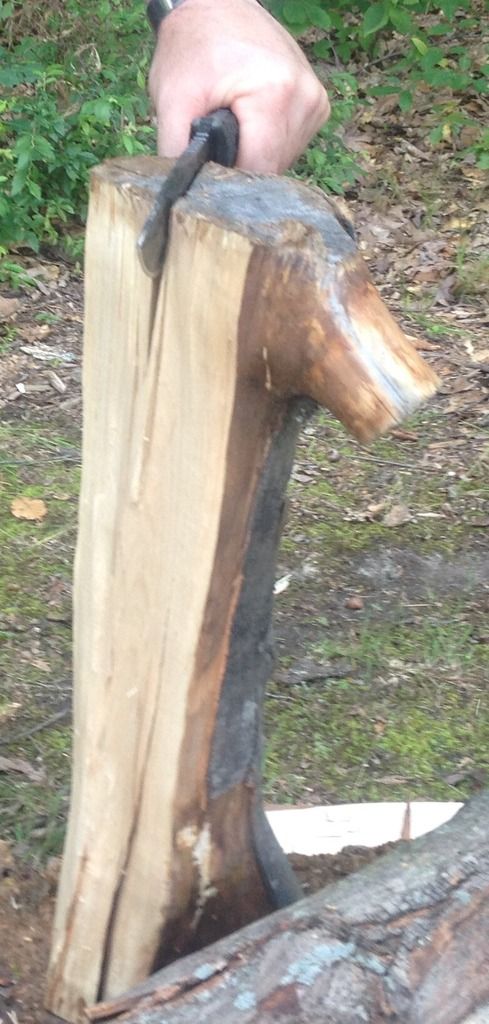

Working it over some more, it's not just popping apart either.
