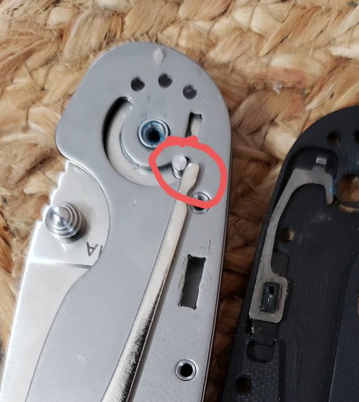

Hey Mr Dan, one last question and I'll leave you alone!
So I did order the assisted opening Rat 1 because I wanted the G10 scales. I'm reading one bad thing after another about the safety. I don't like safety switches anyway, so if nothing else I plan on gluing it permanently off.
My question is, can I just remove the "safety" mechanism altogether?
Thank you Sir!
Edit: Also meant to ask, does the knife have a detent? So if the spring breaks, will the knife still be usable like a manual Rat?

Hey Mr Dan, just for your own knowledge in case anyone else asks, the Rat 1A can easily be made manual by filing down this nipp part. Took five minutes once the scale was off.
My Rat is now perfect. Haha

Mr. Billy the Hungry- Ontario does not recommend removing the safety mechanism from the RAT-1 assisted opener. The knife does have a detent and will work like a manual RAT if the spring is inoperative but the action will be stiffer than the manual RAT. Thank you for your suggestion to offer a regular RAT with G-10 scales and I have passed on your idea to the appropriate people.

As posted above I did indeed deassist my Rat. The safety never worked anyway, straight out of the box. My knife is actually more smooth than my manual one, haha.
