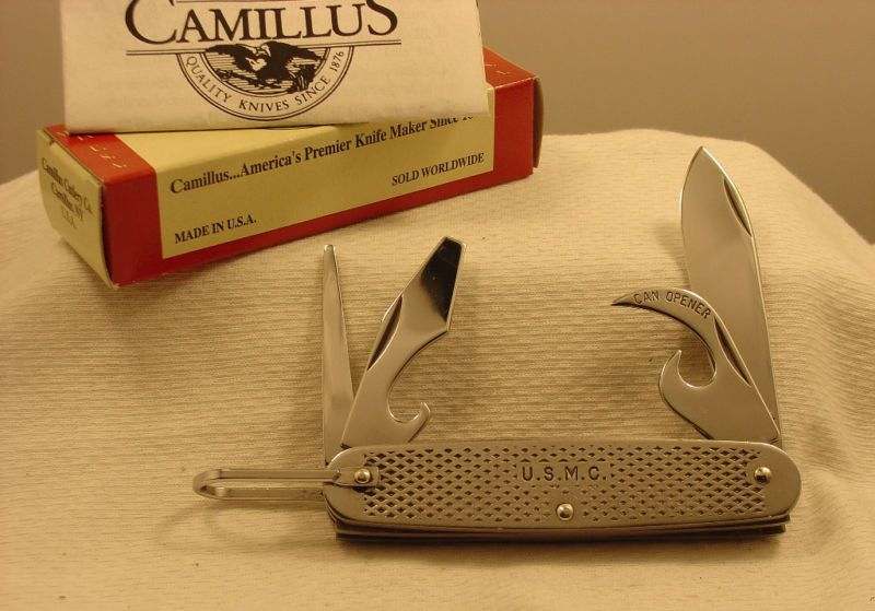

Hi Dan, the "demo" knife is the old standard military issue Scout pattern -
It's also cataloged as "Knife, Pocket, General Purpose" Mil-K-818. I don't think Ontario had an official version, but Queen did have a contract for them in mid 80's. A bunch of the old New York firms did also. Plus rebranded versions for commercial sale.
The NSN number is 5110-00-162-2205.
Edit - I see a reference that Ontario might have offered a version around 2010 ish.
Edit 2 - Ontario's full line catalog 2009 -
Old retail listing - https://www.knifecenter.com/item/ON8980/Ontario-Steel-Camp-Knife-Multi-Tool-3625-inch-Closed .
Thank you for the information and now I know which model you are interested in.
As you showed in the catalog supplement the knife was produced by Ontario not long after I started there in 2007 and it was called the "Camp Knife". This was based on the multi-tool folder which the military issued particularly in survival gear and which I first saw in the late 1960s. My father worked for an aircraft company which included the knives in the life rafts on the aircraft and the survival kit/rafts would be replaced every few years and the old kits discarded (hence I wound up with the knives). Ontario did revive the model for the commercial market and I believe used the prints and tooling that were originally from Queen. I also saw the knives being manufactured at Camillus when I was working there in the late 1990s and early 2000s.
