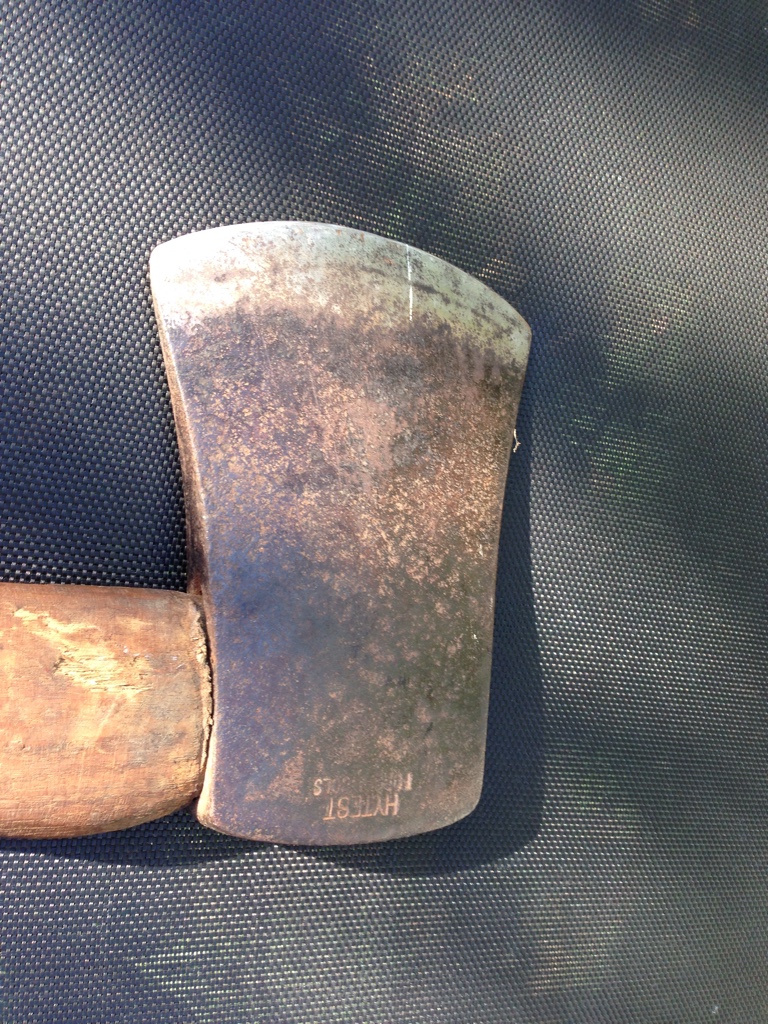

Here are some quotes from an interesting blog, "axemen's news online", which explains how North American axemen need to adjust their technique to do well in Australian hardwoods:
"What to do if you go to Sydney Australia and cut hardwood"
from Axemen's News Online, posted by Arden Cogar, Jr.
http://axemensnews.blogspot.com/2004/06/what-to-do-if-you-go-to-sydney.html
...you have to really work on your axe presentation. Axe presentation is a round bout way of saying "how you strike or present the axe to the log." There are differing theories on axe presentation, but I've watched and studied David Bolstad, Bruce Winkel, Matthew Gurr, Mitch Hewitt, Bill Youd, and George Quigg. All of these axemen present the axe to hardwood heel first with the handle slightly cocked on both up and down swings (as well as the drive and chip hits in the underhand). In addition, all these axemen strike the log with their arms completely straight. I know this may be hard to visualize, but I have prepared an additional article concerning axe presentation in a different part of the book. Note that in softwood, heel presentation is not as important as the full face of the axe can be presented to maximize the axe's penetration in the wood. Also note that when the heel is presnted to the log first, the axe handle should be at a 20 to 30 degree incline if you were to stand and face the scarf and the center line on the log was indicative of 90 degrees. The converse can be stated for the down hits. The same hold true for the underhand except the geometry is altered.
..........Try to get to where you can cut a 14" hard wood log with 23 hits in the front and 23 to 27 hits in the back. If you can do that in the 40 to 45 second range, you'll give Jason Wynyard and David Bolstad a run for the money.
...take two or three of your own old black hytests or pre 1980 keesteels (that are hopefully at least 6 and ½" wide and 7 and 1/4" long) and put the following grinds on them. A 16 to 19 degree flat 1/4" to ½" bevel, with in initial lift behind of the bevel of approximately 2 to 3 "thou" (that's basicly enough to where you can note a obvious depression behind the bevel, both by sight and touch - which is contrary to most hollow grind that cut softwoods in North America). The hollow behind the initial bevel will gradually taper to 20 to 30 "thou" 1 and ½" from the edge then gradually taper back to bevel hight at 3" from the edge. The reason for the big hollows is that the harder timbers require less axe touching the wood as to allow the axe penetrates the wood. The initial lift behind the bevel busts the chip out of the way and the big hollow allows the axe to travel further into the wood. When you put a straight edge on the axe, it looks like a big concave hollow that is uniform throughout the axe, particulary at the 1 and ½" from the edge

I got interested in axes a couple of months ago and dragged out my old Aussie-made Kelly Dandenong 4 1/2 pounder. I take that to have been shaped as a general purpose axe - with bit geometry to try and cover minor splitting was well as felling. The shape was way different from Cook's recommendations so I got to work slimming it down. Now I know next to nothing about this stuff but have kept the bevel angle around 20 degrees half an inch back from the edge given a concern about turning the edge, and I put a 30 degree micro-bevel on it.
I'm not sure that axe racing is a very good guide to a useful average bit shape and use. Those axes, and their users, are thoroughbreds honed for one thing.
My current thing is rehabbing double bit axes. They're getting a modified Scandi grind - flat bevel 20 degrees included angle but with a micro-bevel. Works pretty well on dry Silky Oak which is fairly tough stuff. Getting a cm (3/8") penetration with a 3 lb head. Tough is of course different from hard. Have played on that timber with a Hultafors Agdor felling axe (c. 4 lb) with a more convex bit and got similar depth.
Yeah, our home-grown splitters have a relatively high included angle. The Cyclone you buy eg. is a wedge on a handle. The Fiskars is slimmer. Gransfors Bruks by comparison looks like an axe.
Pics: green Eucalypt, a narrow-leaved peppermint, pretty soft stuff, and the Kelly. Then the Kelly on the linisher after some more slimming down.
