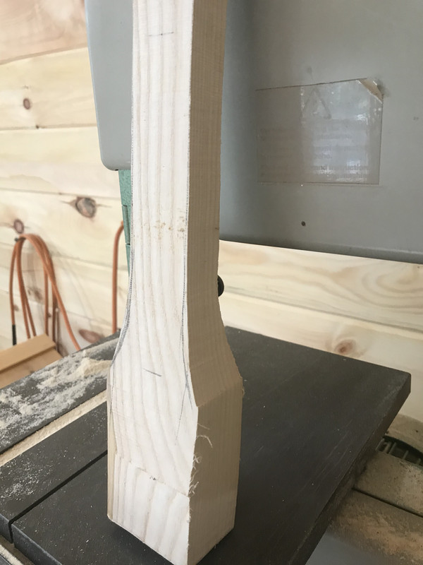

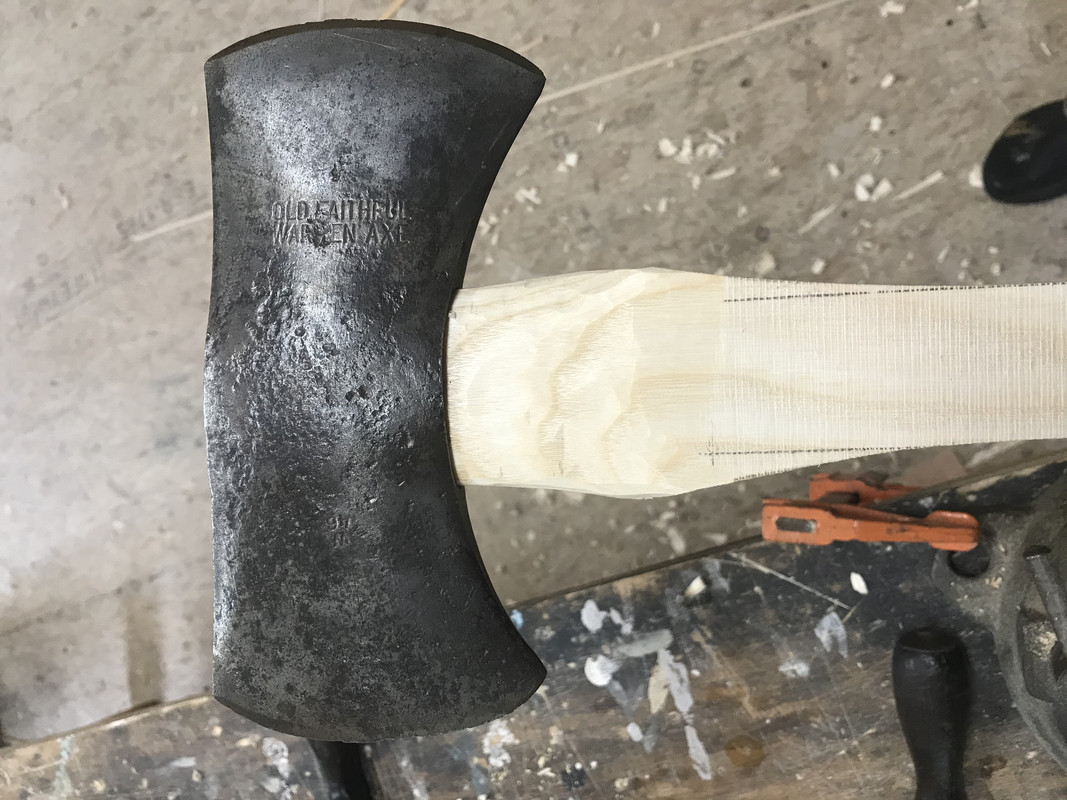

finally got around to making a handle for my warren cruiser. Made from an ash stave I cut and split almost 2 years ago. Didn’t get many pictures, This is it roughed out with a band saw. Used a draw knife, spoke shave and rasp to finish it from here. I will post the finished product in what did you rehang today.
