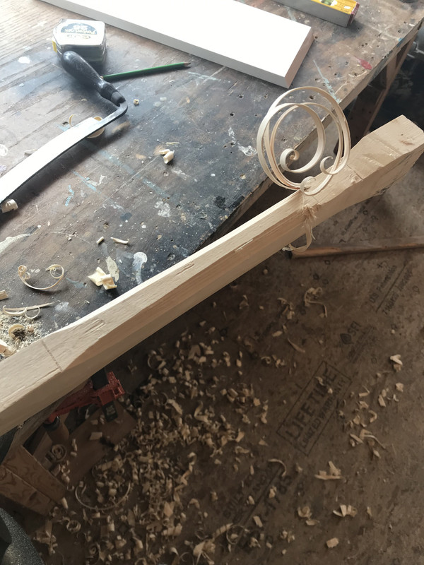

I’ll start it off with this handle build. It will be a 28” straight handle carved from Ash staves I split about 7 months ago
Getting some flat faces so I can run it through the table saw
After table saw
Roughing out
It will be draw knife, rasp and scraper from here. I will update as progress continues.

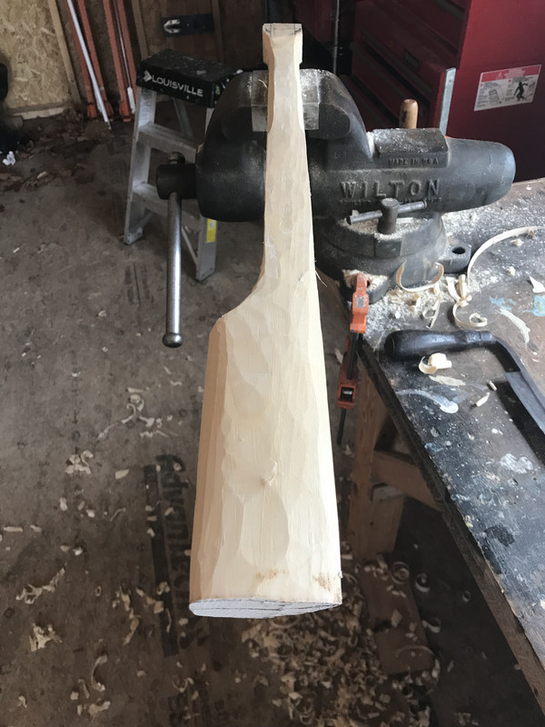

Starting to take shape. Really liking the draw knife for this work.

I got the axe hung and the helve mostly finished;
This line is 2" from the bottom of the kerf. It's driven home like miss daisy!
Unfortunately I had a little mishap. Damnit.
It broke off nice and clean though and I've got it glued up and clamped. All's well that ends well right?!
My jaw dropped a little in disbelief as the bigger part of my swell, that I've spent so much time getting just right, just sheared right off and bounced off the concrete! I said a few choice words and then put it back together. Haha. It may be tomorrow now before I can finish it. Have a good one!

I'll have to put this one here instead of "what did you rehang today". I left it clamped for 3 hours and then finished it. You can't even tell where it was broken! Measures 32" and it can be seated farther down someday if it needs it. That's one reason I like leaving a shoulder.
The blo still hasn't soaked in and I haven't oiled the tongue yet.
