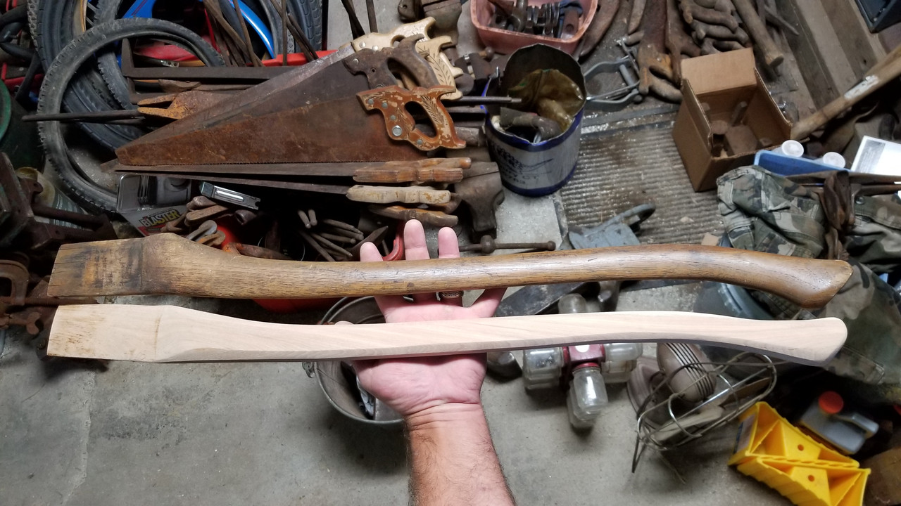

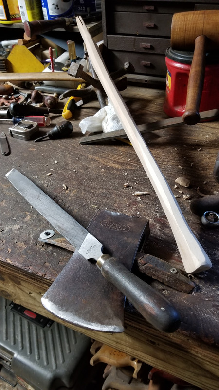

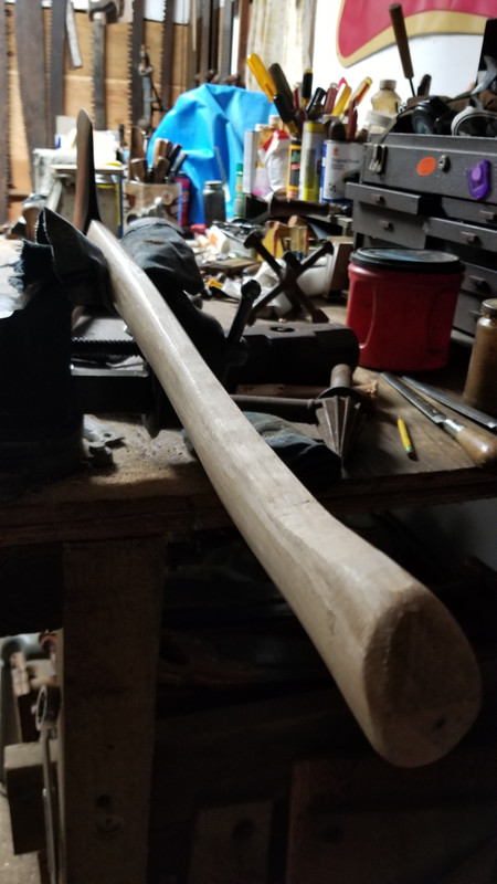

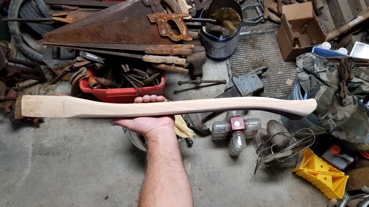

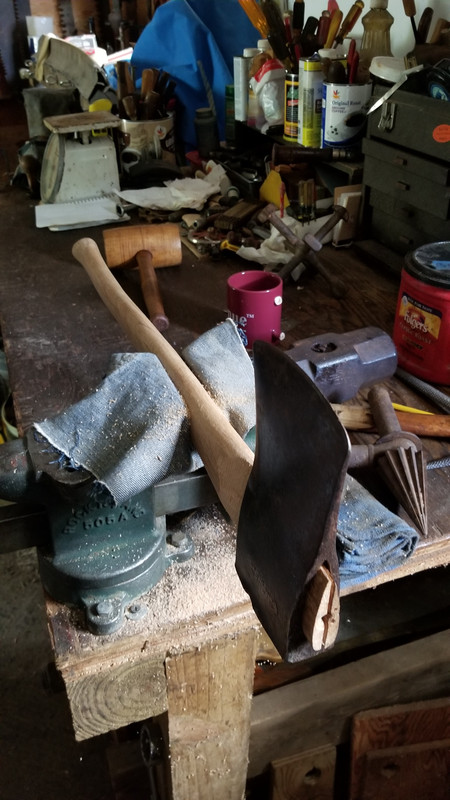

Ok...this is just a mod.
Shape, thin and octagonalize a 28" True Value Link of a club to hang my Mann True American with beautiful bevel, high centerline.
Got the hang of it real nice and fairly easy going with a couple rasps, coarse and fine.
Now the real work :D
My inspiration

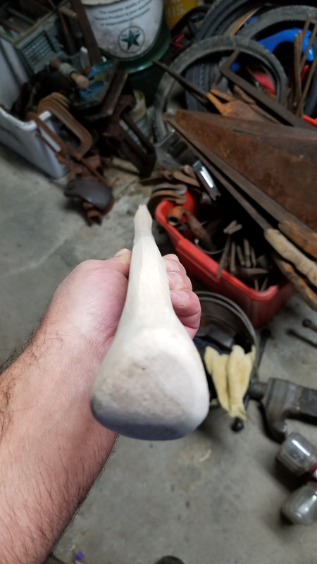

Started filing today
When its all done i will finish posting in the rehang thread, maybe something in the sharpening thread also.

Other than blo I've got it finished.

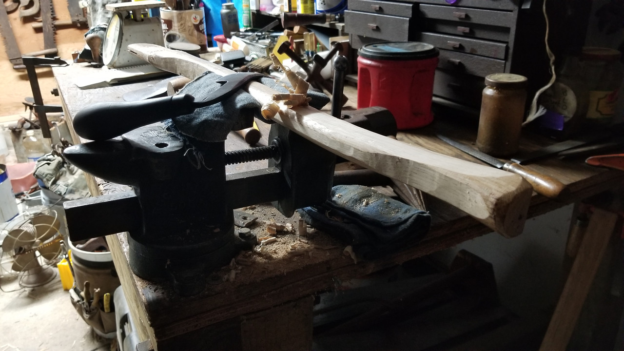

Here's 3 or 4 pics of its process from a log.
It was at this stage yesterday when I picked it back up;
And a couple before I hung it for the last time.
Here you can see the wedge I made specifically for this axe and how short the top of the tongue had to be to clear the bulge in the front of the eye.
I think it'll look nice once oiled. But in the meantime here's the finished product!

Forgive the noob question but what would one call that axe pattern? Is it a broad axe?
Thank you! It's a mast axe. Yes it's an early broad axe. It's ground on both sides(plus has an inlaid bit) so has a straight haft.
They made similar ones that were ground on one side only, chisel ground, and curved that were the next iteration of the broad axe. And they are hung on a bent, or offset, haft.
At least that's my understanding of how the broad axe progressed. Do you now have 761 questions left? Lol.
