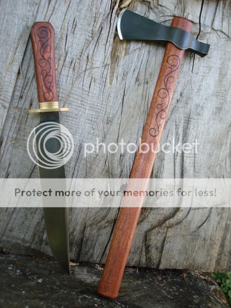

Heres a few "Wrap & Weld" hawks..Mostly 1018 bodys with a high carbon steel bit..We normally just use a cutting bit because its period correct..Originally they would have never used a full length bit back to the eye..That would have been a waste of good steel..Its easier to weld a full length bit in because its easier to weld HC steel to mild than it is Mild to Mild..It does give you more material to work with though.Also thats a good way to make a hawk from a rasp..Fold it over onto itsself with a full length bit.Anyway heres a few..

All hawks with 1018 bodys get a HC bit..All the rasps we use are tested individually to make sure they are made of suitable steel..If they are we'll use them alone..If not then we insert a HC bit..`There are a few rasps out there that are something like 1040'ish that are case hardened..They are just fine for the body but not suitable for a cutting bit..
Usually we have to cut off an end piece about 3" long from the rasp to make it the right length..We test that end piece by bringing it up to temp and quenching it..Put it in the vise and tap it with a hammer..A good one will break like glass..The others will bend right over instead of snapping..After you have done it one or twice its easy to tell a good rasp from the bad..
Right here is a picture I took once of three rasps broken after hardening..One was a Heller, one was a Bellota and the other a save edge..I actually overheated the save edge a as you can see the grain growth..The others are fine and silky smooth..
