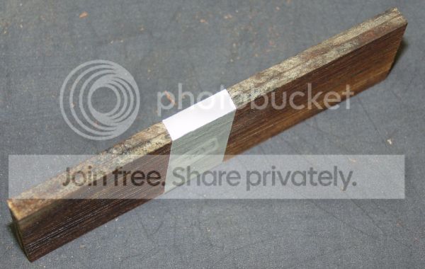

The reason I am so befuddled is I don't have the problem of stabilized wood moving for me here. I cut scales as thin as 1/8" and move them around from my heated office (usually at least 70f) into the storage area (often below freezing).
This is how I store them. Just 1 strip of masking tape to keep things from getting mixed up. These scales are 6 inches long and 1/8" thick.
I am not trying to argue the point. Just trying to figure out what is going on. That is why when I was called by scotsmanspride I sent a full refund while we were talking on the phone. He was very friendly, never even asked for a refund and agreed to try a few things to see if the stabilized wood could work for him in his climate. I figured the help he was giving by trying a couple things was worth way more than the $25 refund for the wood. It is sounding like allowing the wood to settle is alleviating the issue of movement.
