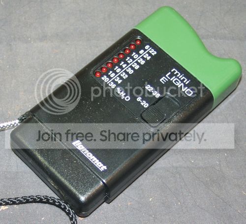

2nd the way moisture content is determined.
This photo is the moisture gauge I use. It is a professional grade moisture meter.
The way it works is electrode pins (7/16") penetrate into the wood and determine the moisture content inside the piece of wood. Readings are taken at the edge, face and end grain of the piece.
I do agree that it is a good idea to let any handle material have time to settle and adjust to your climate. I also agree that most materials natural or man made will move with excess heat. Not to sure about drilling a hole into the block for degassing. I will leave that up to you guys.
