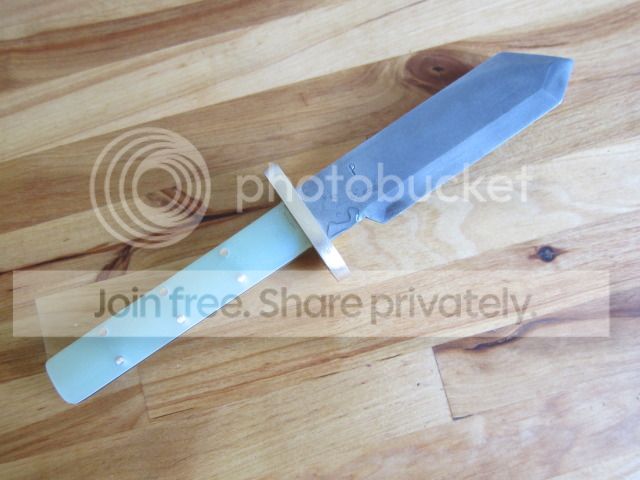

Back up knife, hand tooled, WIP. Pic's bonanza.Done!!!
Thanks guys!

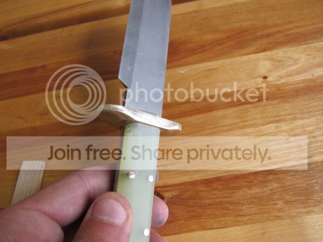

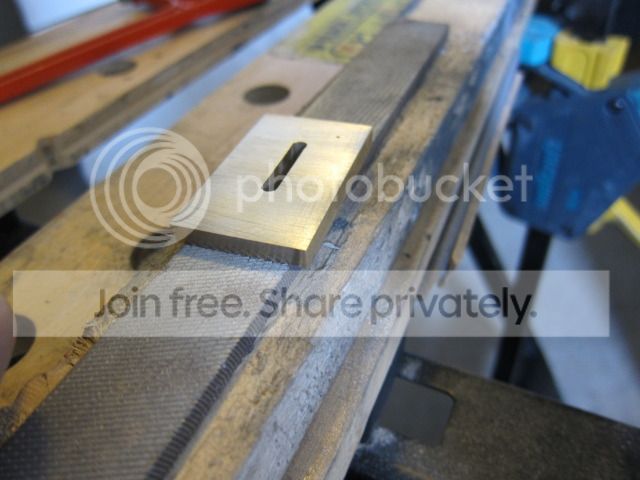

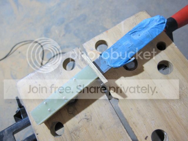

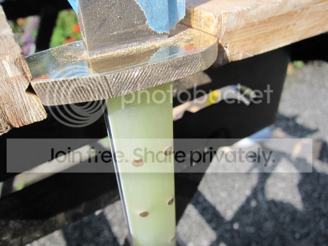

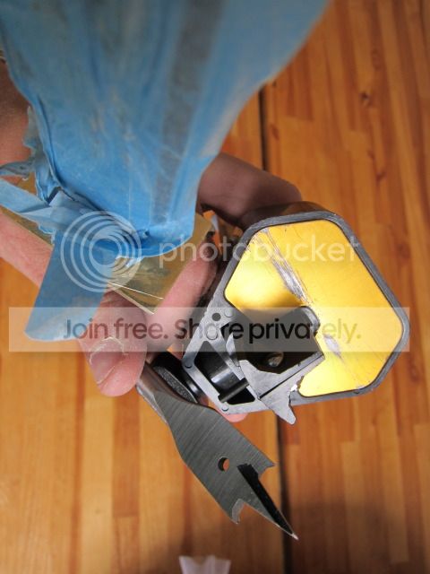

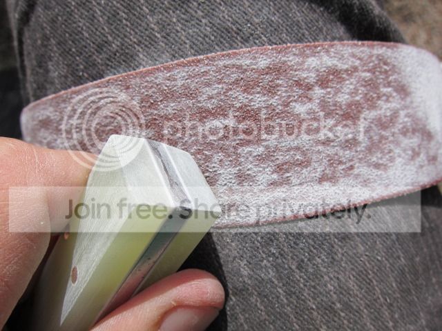

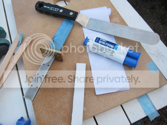

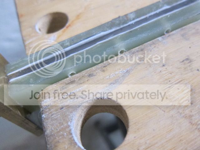

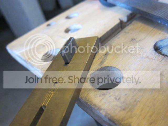

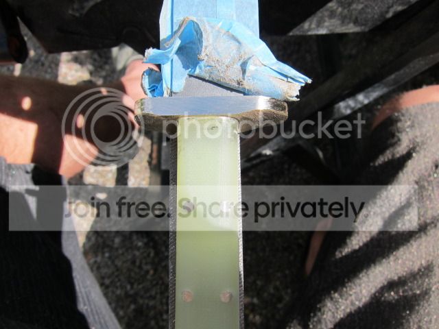

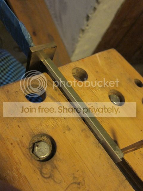

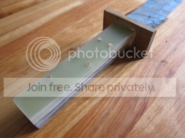

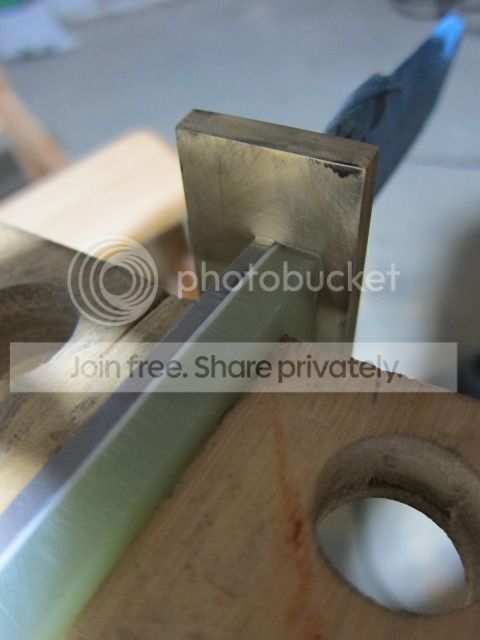

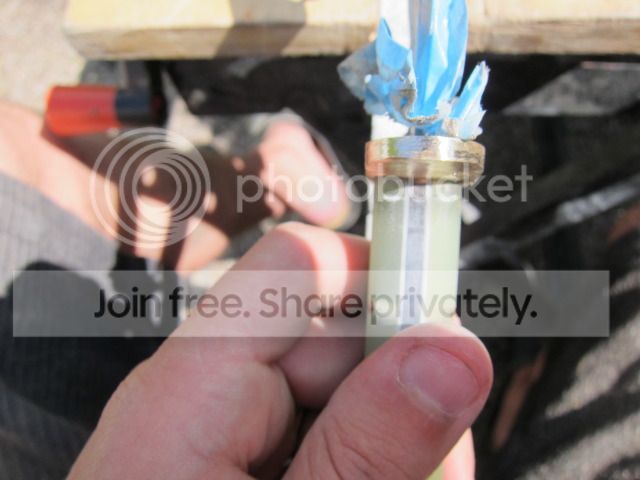

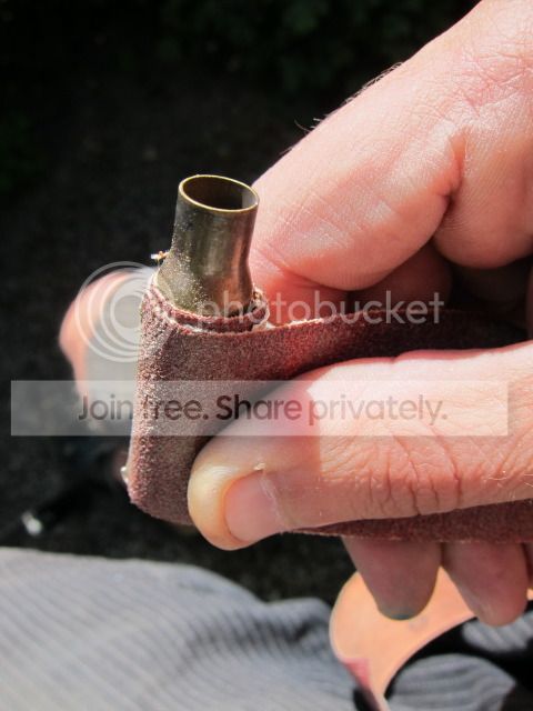

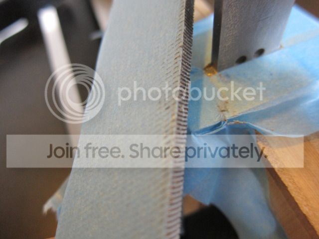

I decided to go for a press-fit whit two half nuts. First i even up the handle so the guard can be hammered on.

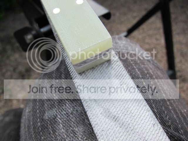

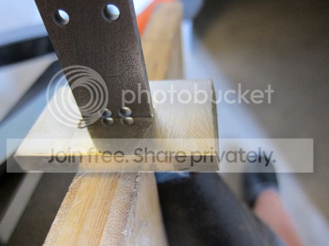

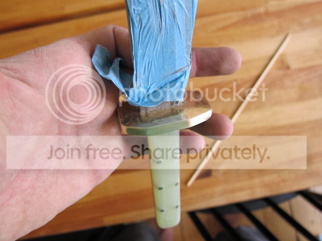

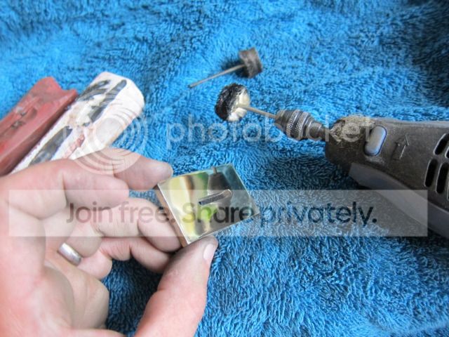

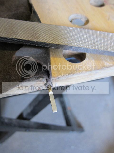

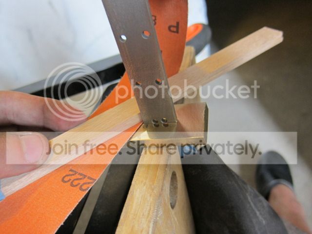

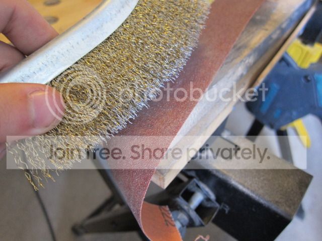

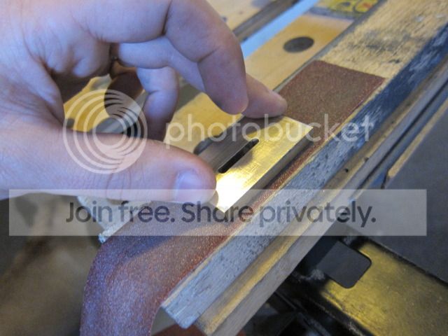

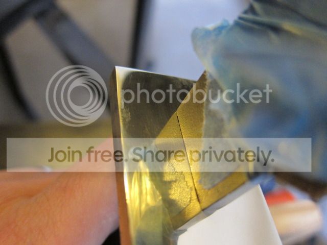

Top of the guard polished. 80-120-240-320-600-1200 red and white polish

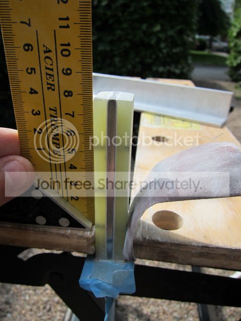

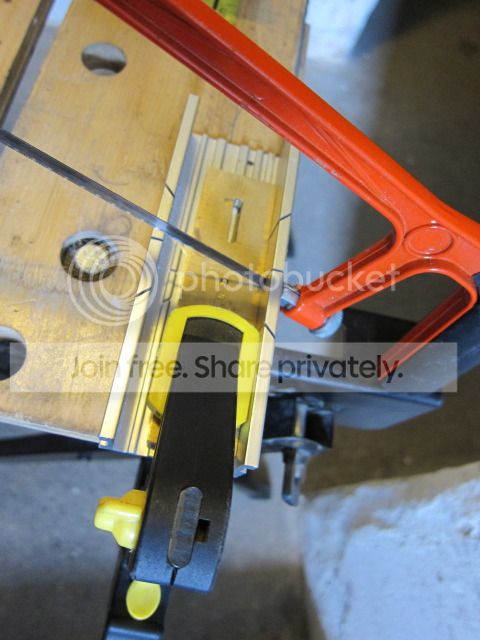

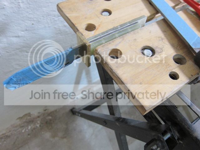

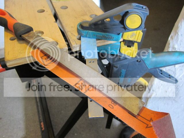

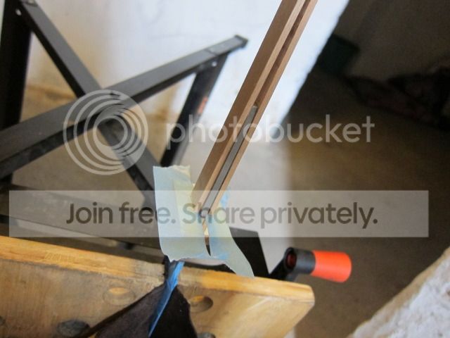

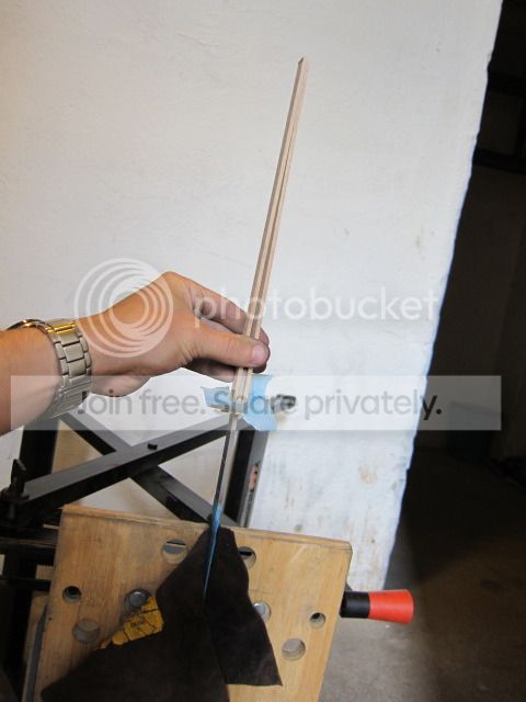

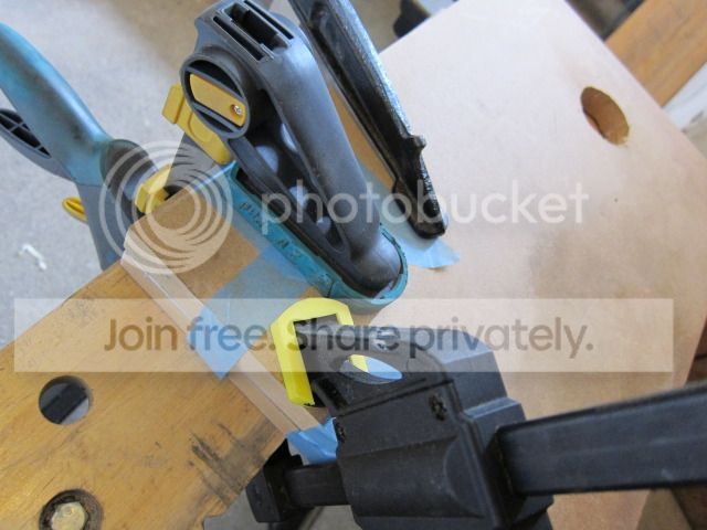

Jig for hammering on the guard evenly whit out any marks.

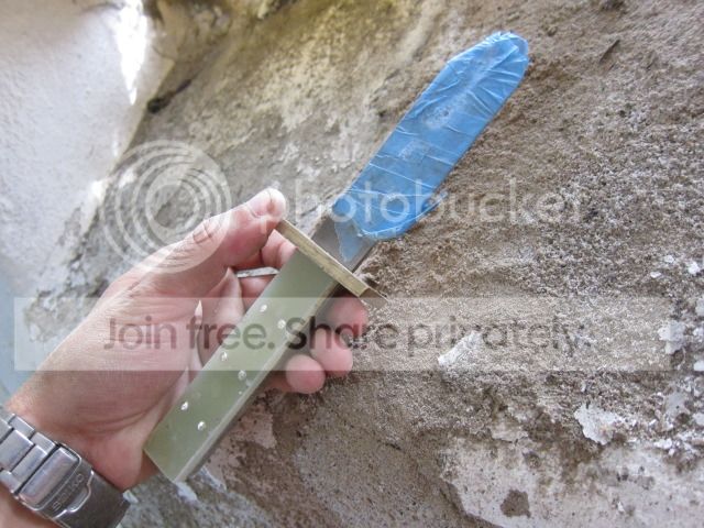

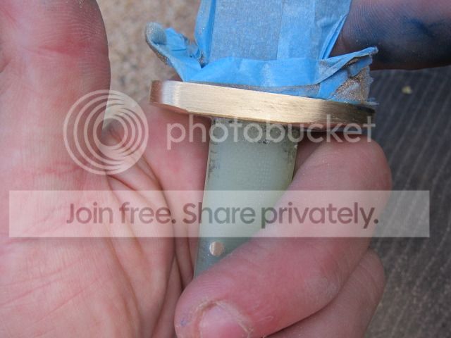

The fit is solid.

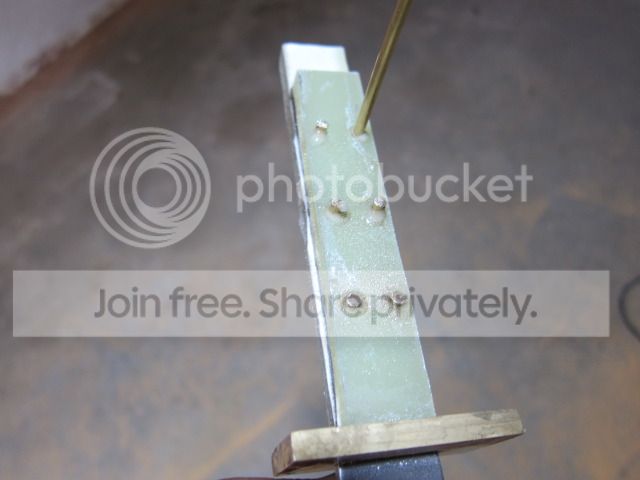

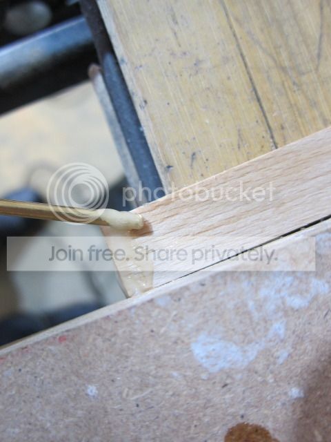

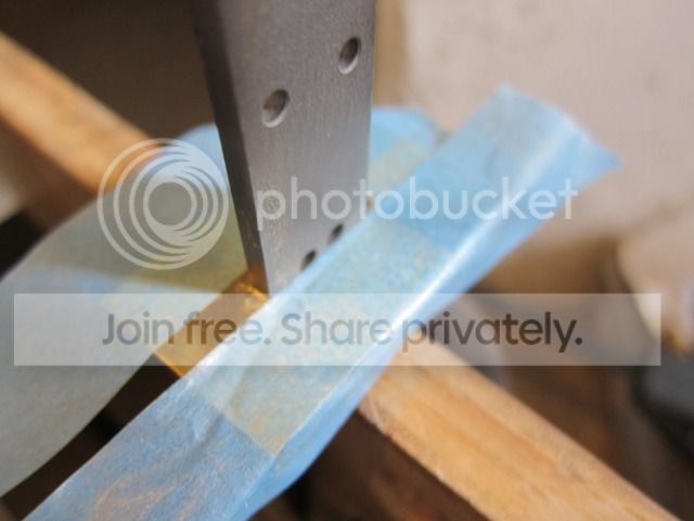

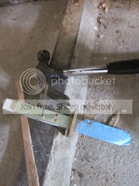

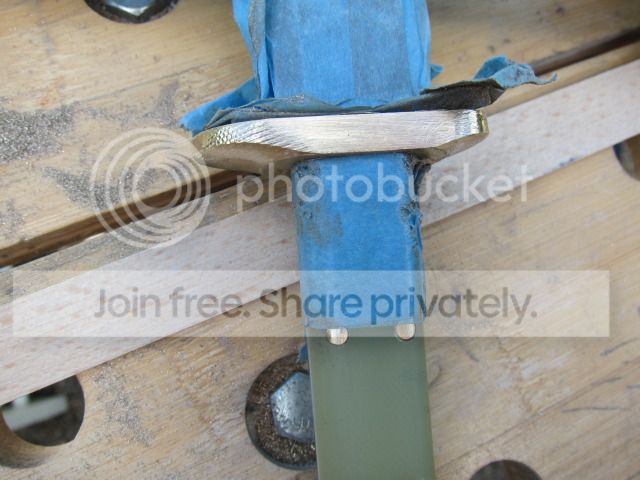

The doorway to an old bomb shelter makes a good anvil for the brass pins.

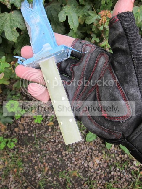

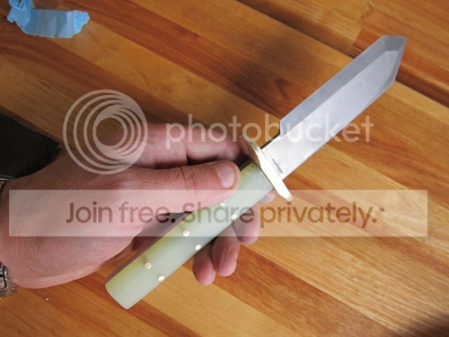

Puuh, it seems like I've past all the critical stages whit out any set backs.

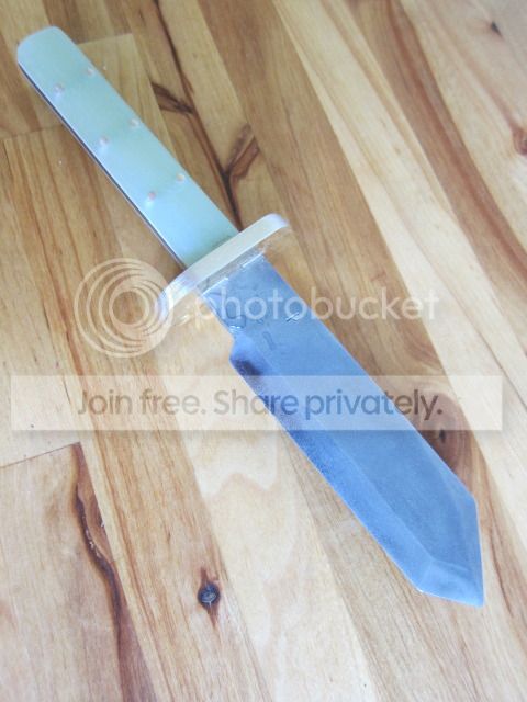

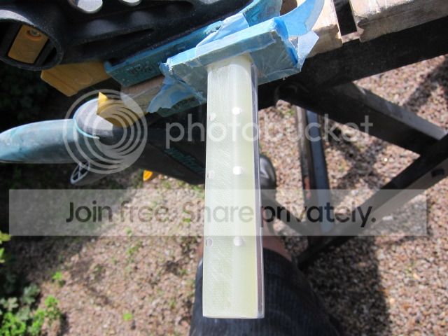

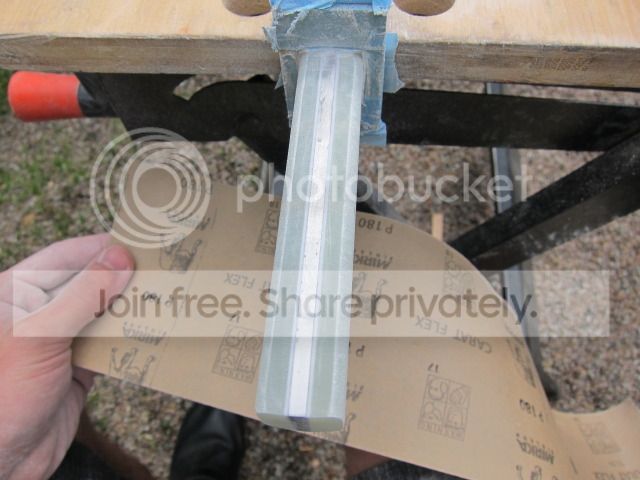

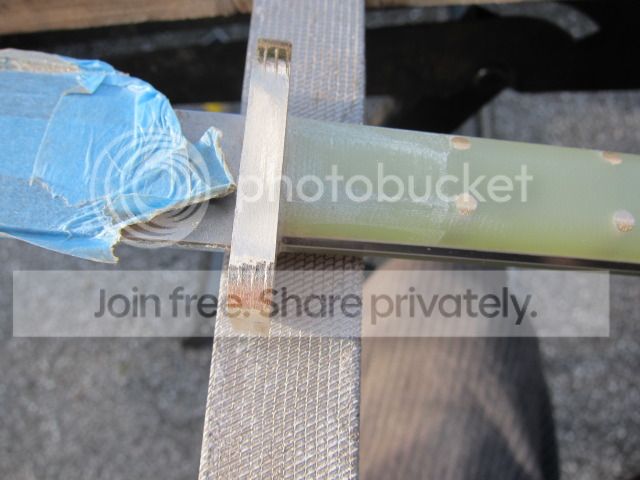

I need to square the handle, shape it, shape the guard. Put an edge on the blade and put a finish on the shebang.

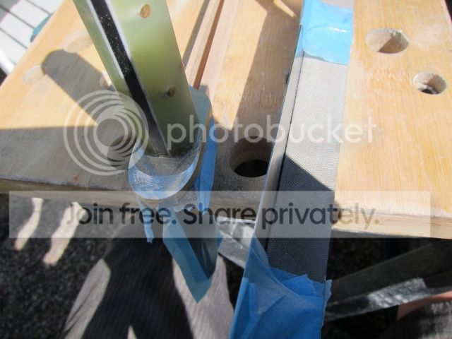

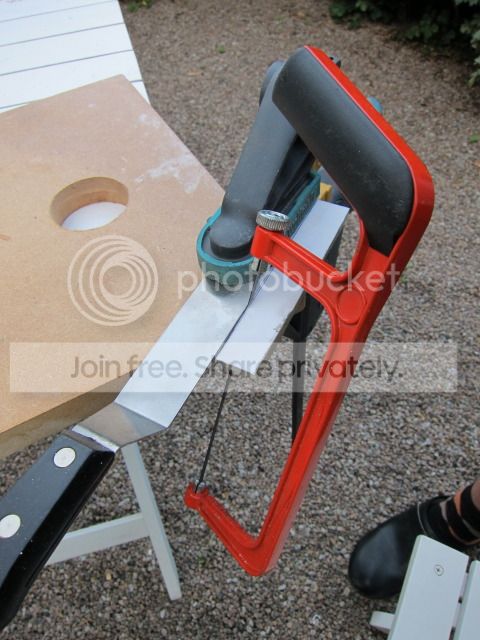

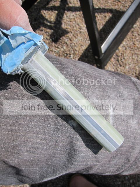

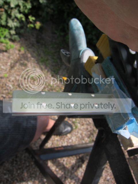

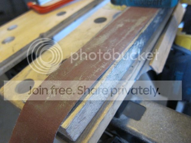

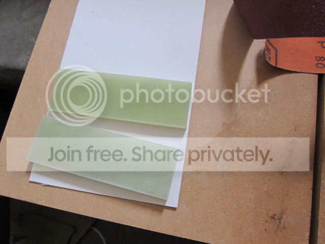

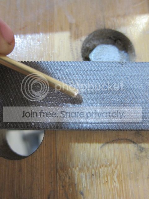

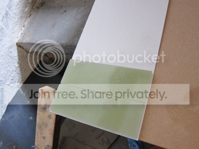

Normally I just love the feel of files ripping through material. But G-10 is no joy to work with. The tools just rides upon it hardly making a mark. :grumpy:
Yes, the Jade Ghost G10 is some slow cutting tough stuff. I found it easier to shape with files than with the bandsaw.
I'm going to thin down the guard and and put an edge and a finish on it. Let me hear what you guys think of the knife and work so far! :)
