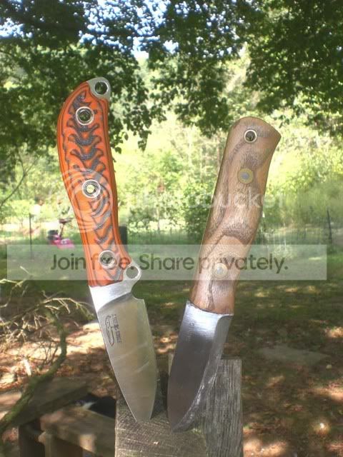

This is a sharp looking blade. Here it is beside my Shing Baby Bushcrafter, a similar size knife.

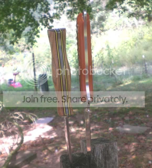

Here is a comparison of handles. The BAD handle is good size but not contoured

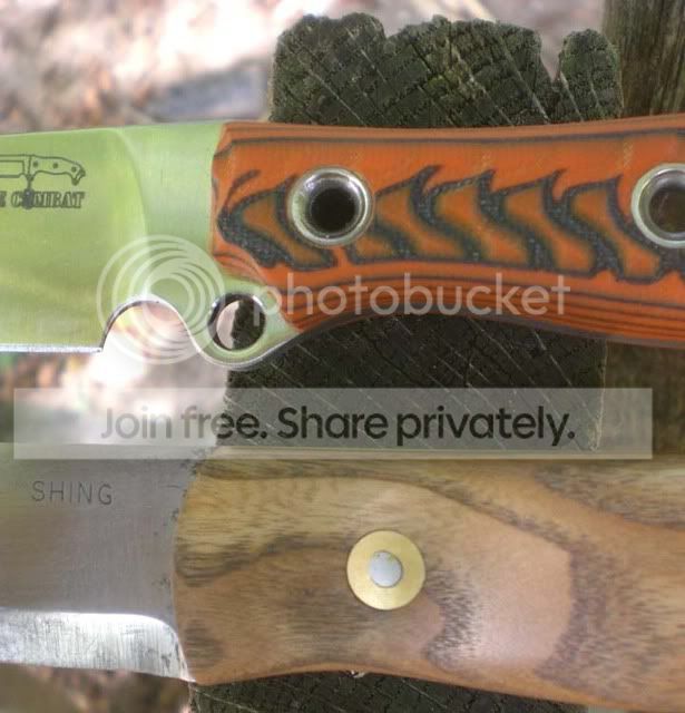

There is this round thing and a sort of choil notch thing(not sure the reason for it- too small for your finger. Maybe it makes it easier for Busse to grind the edge without scuffing up the ricasso?

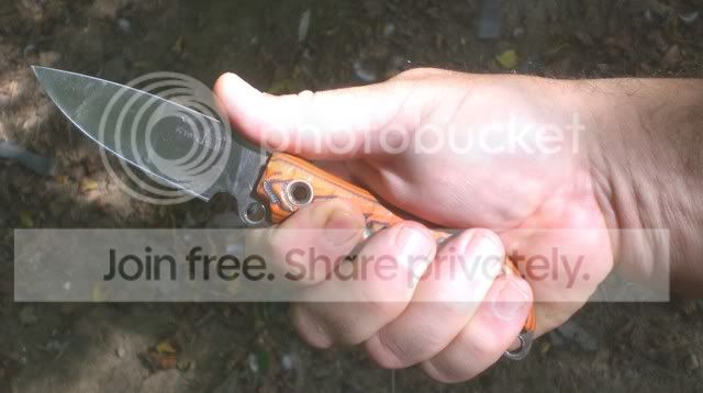

Here's a picture in hand. Feels good in the hand.

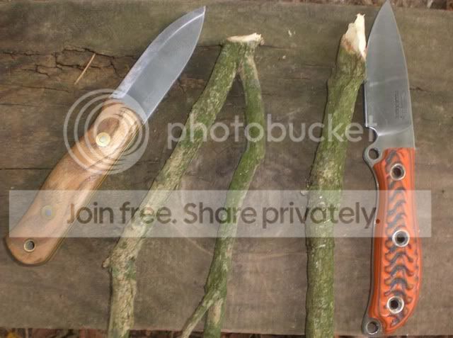

So I thought I would contrast the knife to the Shing. It was really hot so I just tried whittling some sticks. I found that even though the Busse was sharper and shaved(I had just sharpened it) that with the secondary bevel it just didn't cut as deep even though it was thin (1/8")
If you can see in the pic I managed to whittle the stick in half with the BAD but I had to use a much flatter angle and make about half again as many cuts as the Shing with the scandi grind. The shing penetrated so deep I could almost cut the stick flat across even cutting thru a small knot.

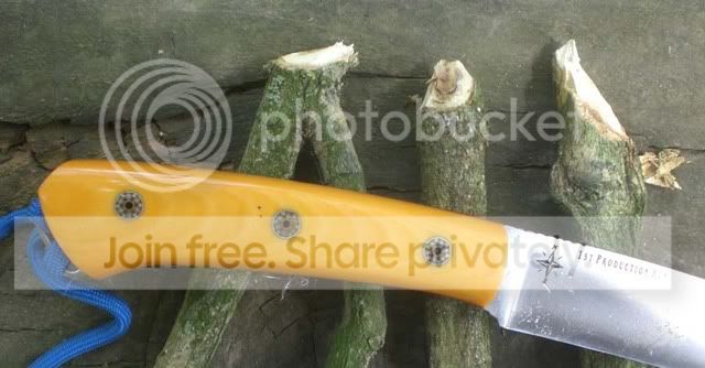

I thought maybe I was asking too much to match a scandi so I thought I'd try a Bark River Northstar with the same stick. It didn't quite cut as deep as the scandi but pretty close.
Left stick Shing -Middle Bark River- Far Left BAD

The choil is Busses trademark. Kinda like Spyderco and the hole. All of their knives have one.
it's just a big ricasso :D
the holes make some sense for lashing, but I wonder what the sizes are. That front one is about where I'd though of putting the arrow straightener on mine if I did that.
Personally I don't like the rear one, on a small knife it seems to lead to hot spots. The BAD does have a really nice curve at the butt, though. That I like.
