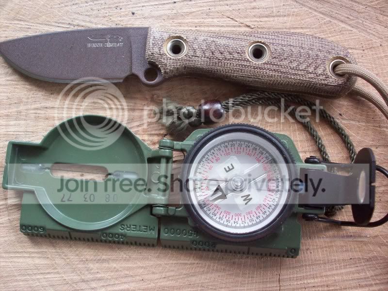

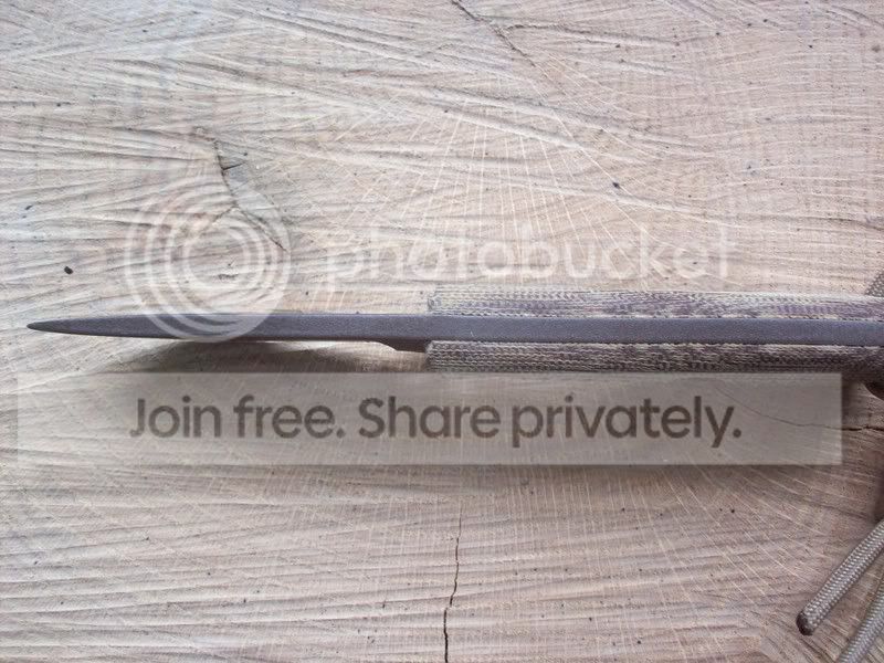

I get ya HD. Gotta few shots of the .200 GW? Particularly the spine? Im thinking mine is thinner. Im not sure on its thickness. I will snap some pics.:thumbup:
here it is next to my compass for scale
spine

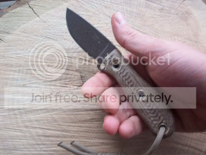

in hand

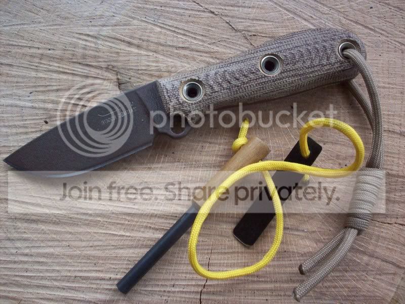

for kicks:D
Hollowdweller,
How well does the knife do on a firesteel. My GW's spine sucks bad at getting a spark from a firesteel :thumbdn:
I think thats due to the structure of INFI. High carbon steels throw the best sparks. I havent even tried my GW, but the SAR5 I had wouldnt throw a spark for nothin.
