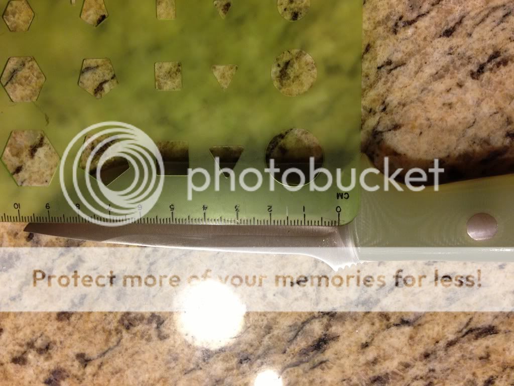

Speaking of BRK quality control... I just bought a bravo 1 a week ago. I noticed the flat grind part of the blade on one side is longer than the other. One side is about 8 1/4 cm, the other about 7 1/2 cm long. Its not a deal breaker. The convex grind is even, and otherwise the blade is great. Is this a slip up when they grind the blade? Quality control issue? Or is this normal? What do you guys think? Here are pics of what I'm talking about. I know its kind of hard to tell from the pics, but i tried to lay the ruler as close as possible to show it. Also you can tell when you look down the spine of the blade. I also have shots showing the length of the flat edge to the tip. I think that one is more obvious. Like I said, I'm happy with the knife, Not planning on sending it back. Just wanted to throw it out there.

Ponsau, brkt knives are hand ground but jeez that flat grind is way too high. Mine starts close to the middle (knifenuts please correct me if I'm wrong). Plus I also noticed that the micro choil is almost nothing. Brkt's spec on the blade height (spine to edge) is a little bit more than an inch (1.1-1.3). Assuming you haven't reprofiled the edge it should be within that spec but if it is an inch or less. Call brkt
Yeah it seemed high, but I've looked at several for sale on knives ship free and the knife connection. If you look at dozens of those there are many that are different. I figured the large variation was from hand grinding. Check this one out. It's on knives ship free, and has almost a full convex grind. My blade is a tenth over an inch, so I think the width is good.

Interesting....I wonder what their tolerances are. Btw survive knives interests me. They use powdered steels like brkt but they actually sell them less. I need to do my googlefu
