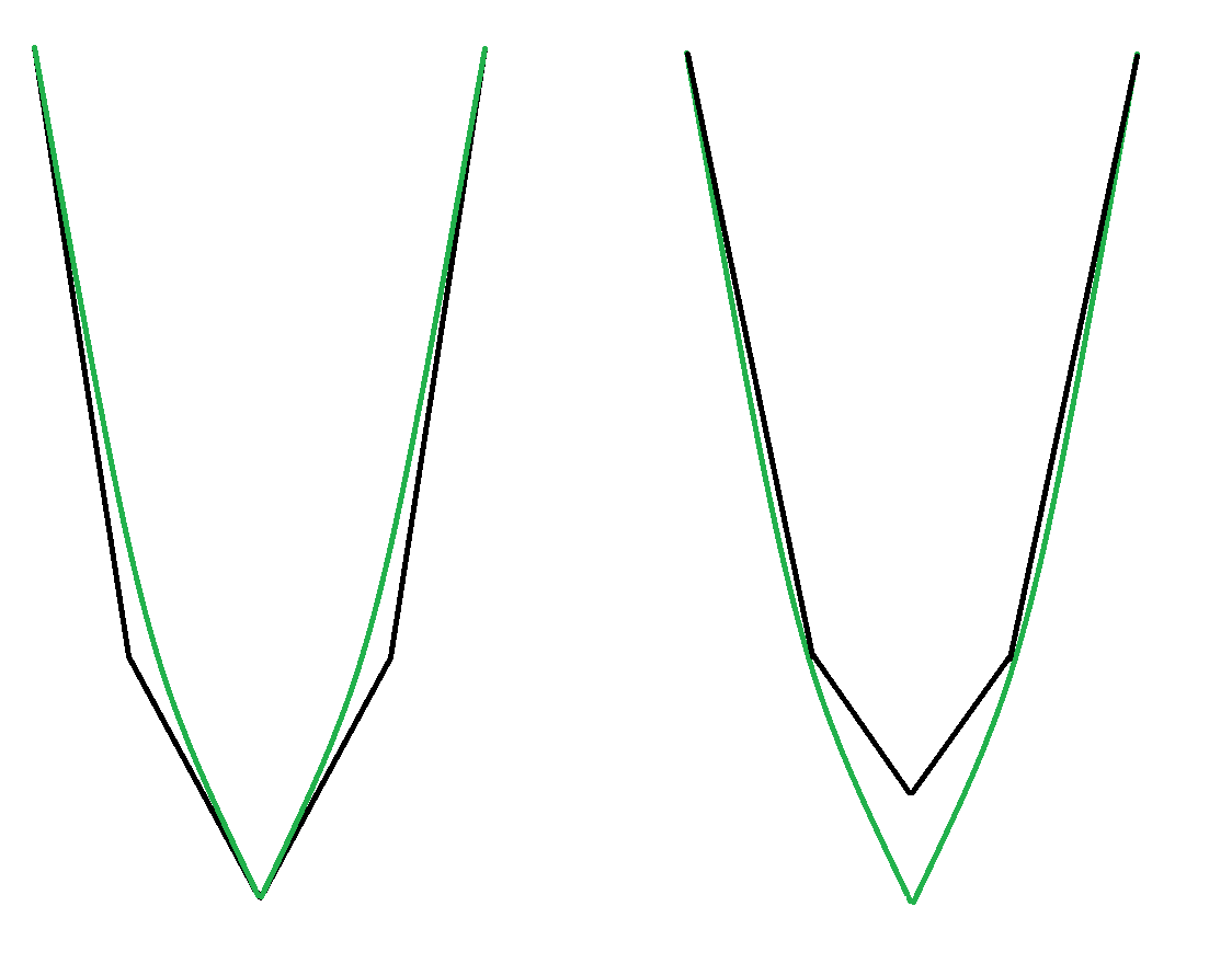

Thanks everyone I will for sure try the convex out first ; however, say I would rather have a standard v edge would the overall blade profile look different like it has had a lot of metal removed?

On the left, you see how a convex edge (depending on how it's ground, of course), in green, compares to a v-edge, in black. On the right, you see how grinding a v-edge into a convex edge will recede back into the material. The exact dimensions will of course depend on your particular knife, but hopefully this will help you visualize it.
Additionally, the sides (what will be the primary grind if you V bevel it) will be convexed going into the cutting bevel. It doesn't look terrible but does look a little awkward. As mentioned above I'd use it as is, maybe get a cheap knife to practice on, but I'd keep it as a convex at least long enough to get a feel for it.

While those graphics are interesting, they are also misleading. Those are two possible comparisons between a convexed edge and a V edge, but there are an infinite number of convex edge profiles and an infinite number of V edge profiles -- and an infinite number of ways to convert one to another. We don't know what kind of convex edge your Bark River has. It could be extremely obtuse or it could be virtually identical to a V edge.

They're not at all misleading, seeing as how I clearly stated multiple times that it all depends on how it's ground and that this was just to help them visualize:

The diagram made sense to me. Bottom line - all other things being equal (spine thickness, width of blade face, terminal apex inclusive angle) the convex will always have less resistance - less material behind the edge. Only a full flat grind (or hollow grind) from shoulder to apex, all other things being equal, can have a more acute terminal edge angle. Any V bevel that has a primary and secondary grind can be made more streamlined by convexing it - smoothing the shoulders out. Only by eliminating the grind transition (FFG) can one eliminate this factor.
I'm not claiming it makes a measurable difference in performance in every case, in general I only sweat it with my heavier choppers that have to bite as deep as possible. On many cutting chores it makes very little difference and can actually result in less lateral stability if ground too thin. On thicker stock, it makes a big difference.
