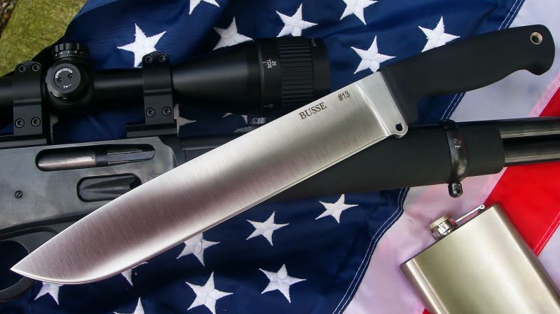

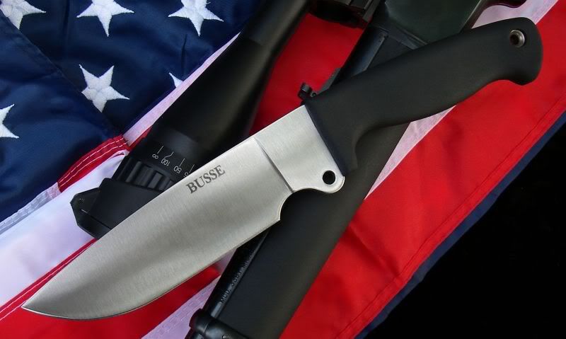

If you could ONLY buy one, would it have a choil or be choil-less? My vote goes to ‘No Choil”. I want a pure chopping machine; in addition, I have never had such a large blade without a choil.

To me a choil doesn't improve the comfort of using such a big knife for precision work. After all - how often do you guys use such a large blade for works that really need precision? And even if will be used for such jobs - I prefer to have the part of the edge that's nearest to the handle useable, instead of a choil. Choil helps only whe you cut away from yourself - like in sharpening a stick. But try to peel a potato with a choiled knife. While peeling a potato (or any vegetable or friut) you cut towards yourself and a choil doesn't help at all. Actually it makes the work much harder because you cannot use the part of the blade that's nearest to the handle, and that part is the easiest to have control over. Doing such work (cutting towards you) you also cannot use the choil comfortably, because of the width of the blade.
Choil on a large blade. Saying that, I wish it was a bit smaller, like the one on a smooth B9.

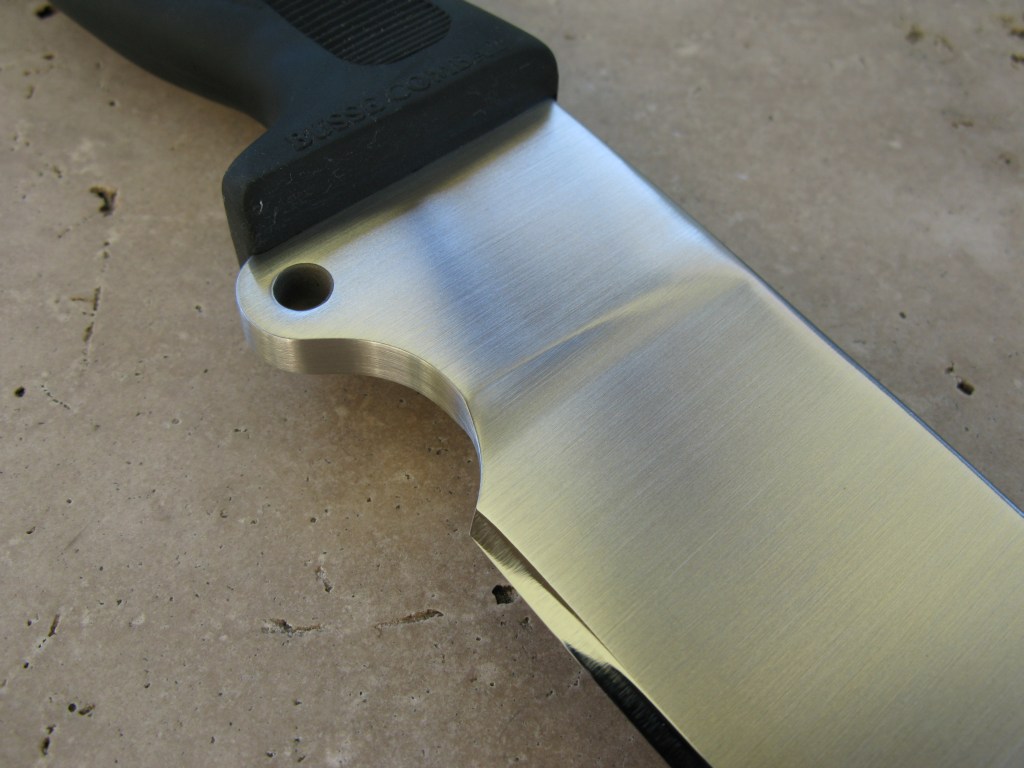

You'd have to give some kind of reasoning behind that before making a claim of it. I don't see any reason why it would, your making the height of the blade smaller in a section, reducing the amount of metal available for lateral flexing. And most breaks happen at the center of percussion or at the tip, neither of which are affected by the ricasso or choil area of the knife.
Because, as I understand it, the compression force in front of the handle generated by chopping, will be evenly distributed along the arch of a choil, rather than concentrate in a point of a square angle in a choiless blade.
But there are no square angles in the ricasso or the handle, the ricasso transition into the main grind is a smooth arch, and the ricaso to tang junction is a wide arch as well.

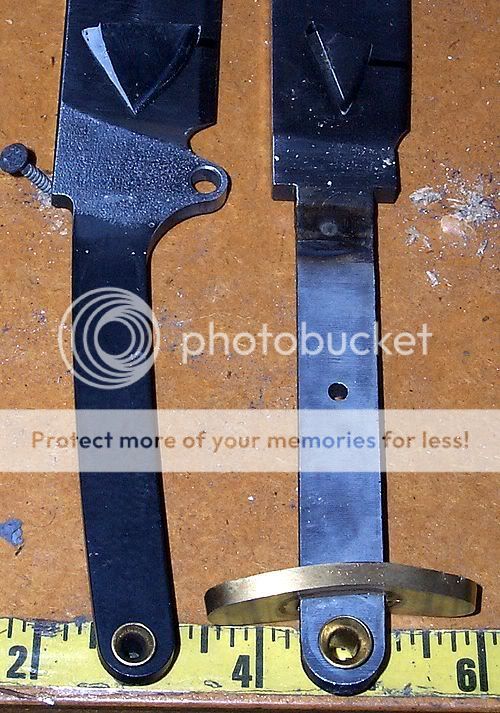

For the tang transision:
This image comes from DWRW
http://www.bladeforums.com/forums/s...e-CGFBM-Vs-Trail-Master?p=7968462#post7968462
For the ricasso to edge transition on the grind itself:
This is an example of a more extreme rendition of the curved transition, the basic 6 and 10 won't be as extreme if they follow the pics jerry posted, but it gives an idea of how jerry finishes off his grinds termination points. Either he uses a ball end mill or he finishes them in a way that creates a radius rather than a corner at all transition points

If you look at jerry's images of the basic series, all of the ricasso to main grinds are the same, both on the choiled and non choiled versions. Sharper and at a much smaller radius than the basic 11, but still radiused
I pulled up some 12 broken knife images, but rather than post a series of non busse knives showing where knives normally break and potentially implying that other manufacturers are sub par (most are not, the individual breaks are just a matter of steel choil, heat treat on that model, and stress risers on that model), I'll just say that of all the knife breakages I've seen, none of them were at the ricasso to edge junction on a non-choiled knife. I've seen breakages occurring at the choil, but it's always because of stress risers and cracks being present there (sharp filing marks and ridges, or heat treat problems). Nearly all of the breakages I've seen on 'combat' knives and general purpose (non-kitchen) have been half an inch away from the ricasso to edge junction, at the tip, or at the center of percussion. That makes sense because the majority of the stress is being centered on the center of percussion or the center of curvature when prying, not on the ricasso or handle. The Knives I've seen break at the handle/tang have been because of square junctions, which busse doesn't use.
So in generally I'd say it would be an extremely rare occurrence and unlikely that any knife, especailly the basic 10, would break at the ricasso to edge junction, and that adding a choil does not add noticeable strength to the area, which receives a small percentage of the stress applied to the knife.
If you read this opinion on a forum, did they give examples of knives that had broken at the ricasso to edge junction, where they may not have with a choil? did they give a reason behind why stress would be centered on that junction enough to cause failure before it happened at the tang junction or at the center of percussion/curvature?
No choil for me. I like to be able to choke up on a large knife, but I don't need a large, edge-reducing choil in order to do so. The ESEE Junglas has no choil and I can choke up on that just fine. I may get the choil-less Basic 10 and then grind off the bump below the hole, so that there is still space for a choked up grip (sacrilege, I know).
