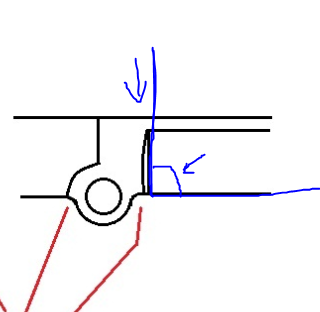

I still stand by my comparison of batoning with a knife to a bridge. One side of the support is provided by the blade engaged with a piece of wood sitting on the ground and another being feet/ knees/ass of the user, whatever touches the ground, with the holding hand as only one of number of connection through which the counterforce would travel (the aching joints of the fingers perhaps being the weakest), but I don’t believe that end should be considered as being up in the air, no matter how soft or shaky it may be.
I’m not clear about the difference between a load and a shock load you are referring to. It appears to me, the only difference would be the time during which the down force is applied, and that seems irrelevant here. We are talking about the difference in forces that would break a choiles and choied knives by way of a transferring energy from the external object to the spine of the knife, and I believe that the time has no effect there (Newton’s second law?).
I don’t know where I’ve got it, but I always thought that the main reason for a choil is to reinforce the weakest point of a knife that is being the transition from ricasso to the edge due to the right angle, not to provide a convenience of choking the blade or sharpening it, those are byproducts.

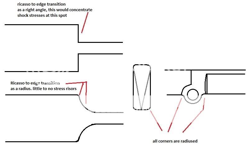

When you say that the ricasso to edge transition is at a 'right angle' what do you mean? From what I can see on the choilless knives I have from busse (a BOSS Jack LE in front of me) there aren't any right angles. The line from the ricasso to edge is a 180 degree line, and all of the 'corners' are radiused to avoid stress risers. I don't understand what structure is there that would make it a likely location of breakage, other than the idea of it being directly under the shock load (which it really shouldn't be if your trying to avoid damaging your knife handle). If everything was done with a sharp corner, I'd agree with you in so far as it being a week spot, but if the corners were kept sharp in the choiled version I'd assume it would be just as likely to break at a stress riser as the non-choiled version. Sharp corners concentrate stress regardless of your geometry. If both versions are rounded at all corners, I go back to wondering what it is about the straight line of the non-choiled version that would make it the weakest point...

When you say that the ricasso to edge transition is at a 'right angle' what do you mean? ........ I go back to wondering what it is about the straight line of the non-choiled version that would make it the weakest point...
Pardon my drawing.
The arrow above ricasso represents application of an external force via batoning.
Another arrow points at the Right (Square) angle.
It is my firm belief it takes less force to break a knife at this point if there is no choil in compare to the same knife with one.

I guess my main issue is just that I don't understand why the ricasso to edge junction would be considered weaker then blade itself. It seems that (without any edges or sharp angles to concentrate stress) the edge would be being reinforced by the thicker ricasso. The breaks I've seen have always been 1/2" or more forward of that junction. The edge thats being affected by the wood is the most likely place to have damage occur that creates a stress riser to concentrate the shock forces, resulting in a fracture.
If you had chain link fence on a wall, and you were jumping on it or trying to shake it side to side, where would be the most likely place where you could damage it? If you try at the wall, the wall is unmovable by the human body, so the fence is reinforced by it, especially if it has a good anchor point to the wall (a radiused corner). If you try to break it farther along the edge, your more likely to be able to induce sway or to get the top bar to bend downward as the rest of the fence is less able to provide reinforcement. That seems to me to be what happens with breakages caused by batoning. The edge farther along the blade gets damaged and ends up breaking there, or the stresses concentrate on the thinner segment farther away from the ricasso.
I would love to have one of our physics doctors chime in here, as all I have to work with is abstract comparisons for concepts I can't put numbers behind...
I must have misread your picture then, I was under impression that was ricasso to blade....my bad.
no, you were right the first time, I just have terrible grammar and missed a pretty important word there. I did mean ricasso to edge, not ricasso to tang
