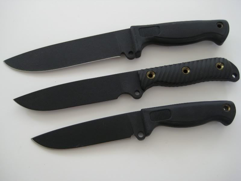

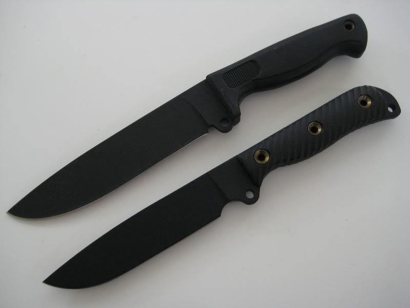

Some comparison pics.
SJ vs B7
Tossed in a B5
Very similar. The downside to the Basics is no finger-choil. Something I wanted in that sized blade. . . so I have a BJ now and no more B7.

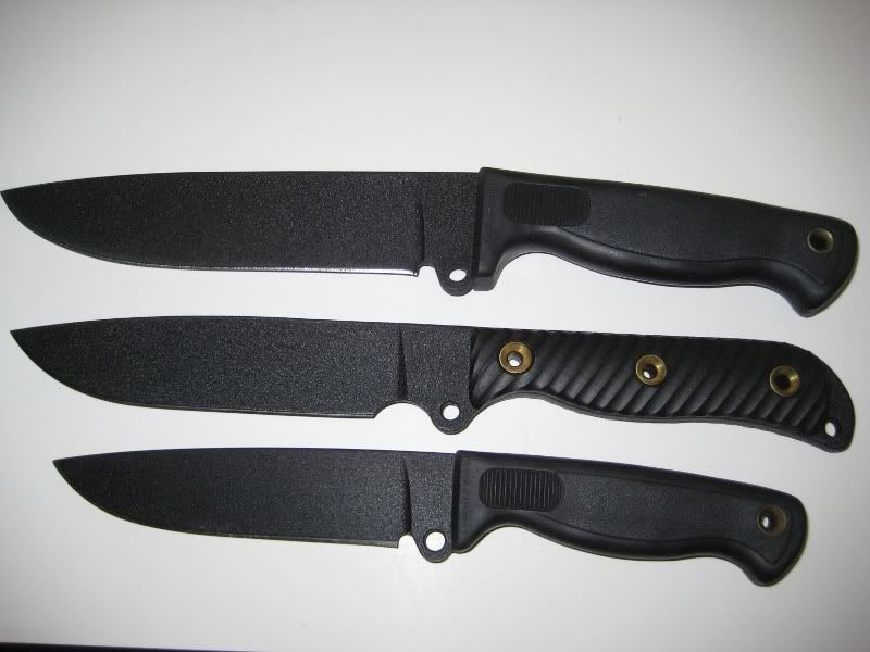

Here's a crinkle and a smooth coat, the camera angle kinda screws with the comparison.
When I finally put together a 3, 5, 7, 9 set, I realized that there's significant differences between the crinkle / smooth coats :(, a couple of years later, I'd put together a set of each :cool:
Crinkle / smooth 9, 7, 5, 3
and some spares :foot:
