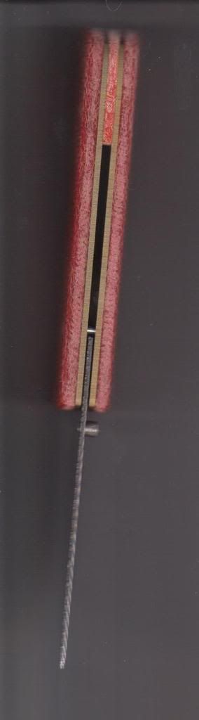

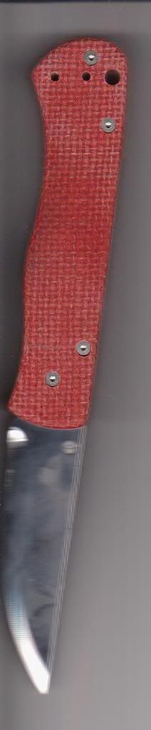

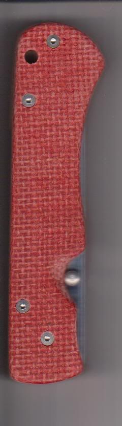

I suppose I should have rotated the pics...here it is. I'll need to make up my mind on finishing it up, there needs a little more relief around the thumb stud, and my clip holes are off a touch, so no clip just yet. I ran out of steam and time last night.
I am not sure if I want to round the edges similar to the rest of the bussSTRs, but I think I have enough material to do a kinda fish shaped contour with a palm swell. We'll see.
I'll try to capture some glowing pics later...it has the bright green glow powder in and is fairly obvious in the dark:D
My BusSTR is a glowSTR :)
This thing will be very handy and I just know I will get a lot of use out of this simple and elegant folder. :thumbup: My Scout council forbids sheath knives, so I expect this will be my primary carry on Scout outings, if not in general. It may be a little big for an EDC (I prefer something in the small sebbie size), but I'll try it.
I thank you very much Steve!
(PS-expect a PM in a little bit)
Oh...did anyone mention that these things are wicked sharp? :)
Lookin' good FOD. I rather like the square look personally. It almost looks textured as well which I find appealing.
It goes well with the rough sawn bare bones get after it user character of the model's presence and feel IMO.
The thumb studs, as I pointed out on a page way back, were the same order number as the old ones but they no longer are the same length. Where you see the biggest challenge is thinning down that thumb ramp to access the stud. It needs tapered down further to blend it well from what I've gathered in doing the ones I've pulled off. Most of the trend is to make short just barely long enough studs anymore so they don't stick out too far and catch the pocket when extracting the folder. Personally I'd rather have them too long and be able to shorten them than too short but not much I can do about it unless I find one longer somewhere.
STR
Thanks!
I don't dislike the square look...I may leave it and see if it grows on me...I sometimes tend to mess with things til I mess them up permanently. They are smooth with no texture (600 grit hand sand), just the look of the burlap. I'll get the clip on and try this way for a bit.
STR
The short thumb stud was driving me nuts: I replaced it with a threaded knurled standoff from the 7 year bin. I put a cut down button head on top to finish it off. looks alright and feels perfect.:thumbup:
I wonder if you could shim the short ones up with washers? I did not have any that size, but I would have tried that first if I did.
It was out of my control. If you look at the first post of my own folder you can see the screw heads for the body construction. The pivot is an older barrel and screw set sold under the same exact order number as the others yet the screws on the one on the barrel used in the pivot are bigger in diameter heads than all the rest. They are all 2-56 and they are all T-6 but you can see the diff with the naked eye.
I've had other times where I ordered something I have ordered before and use only to notice that the screw is no longer a 2-56 but a 1-70 and no longer a T-6 but a T-5 driver now. My original thought when I noticed that the same order number for textured studs yielded a shorter stud now was to order some 3/16" pivot barrels from Knifekits that took 2-56 screws but of course those are no longer made. I was going to just make my own thumb studs the length I wanted using those but once again suppliers changed stock on me.
STR
