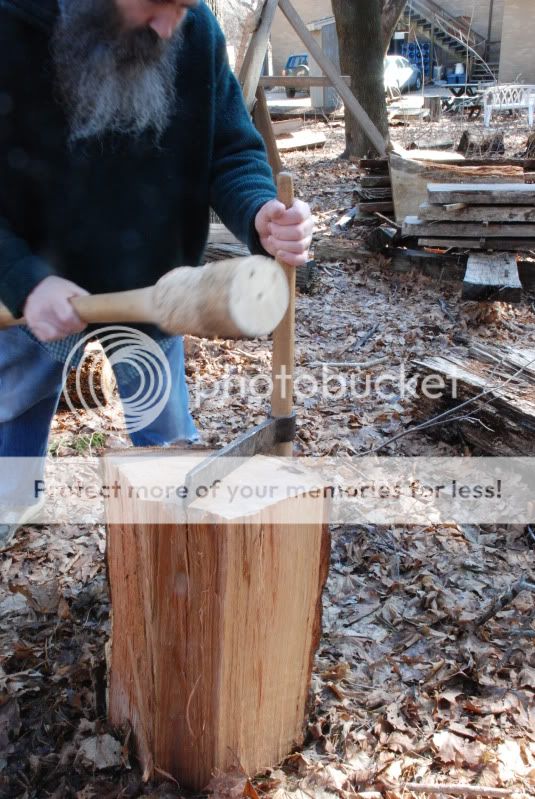

How long has batonning been around? Hundreds of years, in one form or another. The splitting froe (or frow) has long been used for splitting logs into shingles or for other projects, because it was so much faster in the days before electrically powered saws. It is also said that old men too feeble to swing an axe were given a froe and mallet to split firewood. (Eric Sloane's books are excellent reading with information about froes).
(photo from the internet)

If you look at the picture that siguy posted, the man is splitting the wood perpendicular to the rings in the wood (quartersawn) that is the right way to do it the wood splits effortlessly without much force. any woodworker knows that, and now so do you! hahaha
try it and you'll see the difference.

The Froe info was very interesting Siguy... I had never heard of that before. One of those looks like it could easily be carried without the pole or mallet.
the froe is used to start the split. then wood or metal wedges are used to finish the split.
It is exactly the same way we do it with our knives, but in a smaller scale. and with smaller pieces of wood, a lot of times just the knife is enough to split it.
