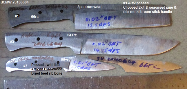

Updates
Small 3V full tang above:
1) 66rc chipped when swing+wrist_flick at thin African Blackwood. Tempered down to 65rc - Passed.
2) Chop frozen beef rib bone - passed
3) Baton frozen beef rib bone - chip badly. Sheer baton strike - lost tip 0.8"L x 0.5"W, spine at break point ~0.075"
* this blade is too thin for this kind of abuse.
Spectrumwear tempered down to 65rc (didn't want edge to risk gross damage at 66rc)
1) chop AB - passed
2) chop fbrb - passed
3) baton fbrb - passed

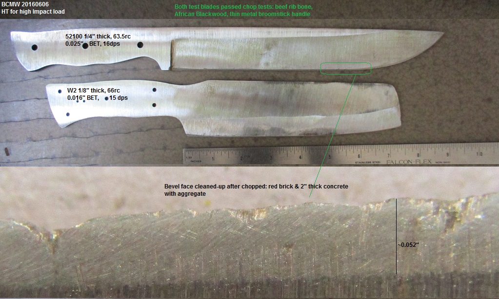

52100 64.5rc ht on 20160605, 1/8" thick: 0.018" BET, 15dps, 2K waterstone finished edge
1) chop AB - passed
W2 66.5rc ht on 20160605, 1/8" thick: 0.03+" BET, 15dps
In spite of super thick edge however 2K finished apex is plenty sharp/thin
1) chop AB - passed
1084 stick tang, 66rc ht on 20160602, 1/8" thick: 0.02+" BET, 15dps
1) chop AB - passed

Updates
More ht done - this time aim for supporting high impact load and deal with extra mass thermal issue. Got 0.5rc short on 52100; however quite please with clean-abraded damage from aggregate rather than fracture type.
