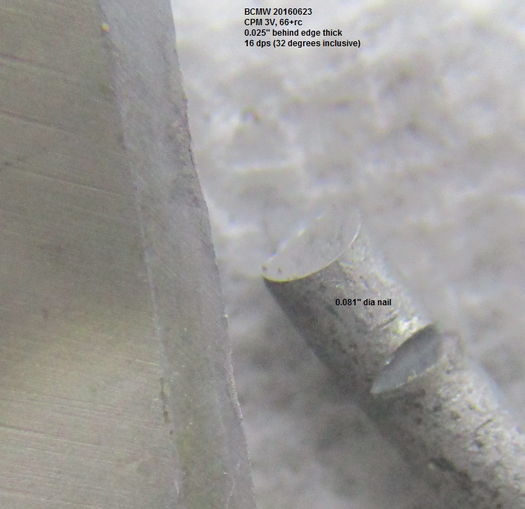

For 66rc objective/question: so with Nathan's 65.5rc AQ #, thus 66-66.5rc falls within instrumentation and or conducting/reading error margin. Having stated that, however stubbornly I trust my *hand-waving* hypothesis of 3V potential of reaching 67rc peak hardness. So 66rc would be a low/conservative avg of 5 rc readings by tester calibrated with certified block.
Edge stability at ~65rc objective/question: to be seen/test/verify (if that goes well, implies my 65rc 3v video might actually be real
Test blades subject to edge profile changes/mangling and even destruction.
If anyone is doubting as quenched hardness of 66, this is pretty close.
^ That's here in my shop on an NIST traceable, certified and calibrated hardness tester. That includes subzero as a part of the quench. I'd consider 3V at HRC 66 to be very possible and simply on the high side of normal.
