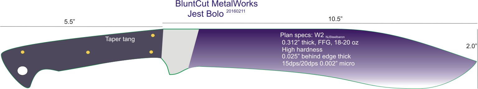

I am on my 3rd years trying to perfect my ht. Recently done a few round of tests on 3-5" blade knives. Chopping impact test is next. Yesterday, I ordered some thick steels from Aldo/NJsteelbaron. A BF member got me into using Jest Bolo pattern, otherwise I would happily make another one using my previous pattern.
Jest bolo #1 - 0.312" W2. If it went well, make Jest bolo #2 - 0.156" 52100
http://i.imgur.com/Ogsjs9s.jpg
Intended usages/tests/goals:
* Chop through 2x4 Douglas Fir in 6 chops or less.
* Fastest chops and mis-chops at seasoned oak board.
* Hardest swings (I can muster) at pin-knotted seasoned pine; dried olivewood (~2700 lb force in janka); Cumaru 1.5x1.5 square (3540 janka).
My plan is evolving, thanks for any inputs or comments.
My goal for this chopper final working hardness is between 63 and 66rc. So strength & toughness must be quite high in order to sustain hard chopping impacts.
For comparison: hardness of Japanese high end kitchen knives are usually between 62 and 64rc.

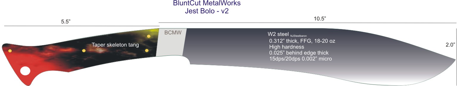

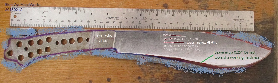

After did more handling of my previous chopper + took input from KWB. Added some flare to handle tail to keep this chopper from wanting to fly away. Tang will be skeletonize. Replaced finger guard with forward choke - to save some weight. Open heel for ease of sharpening and allow close up heel cuts.
I've 2 blanks of 1/4" thick 52100 chopper sitting around. Not sure, if/when I would make choppers using the original pattern, so might as well repurpose 1 for a jest bolo.

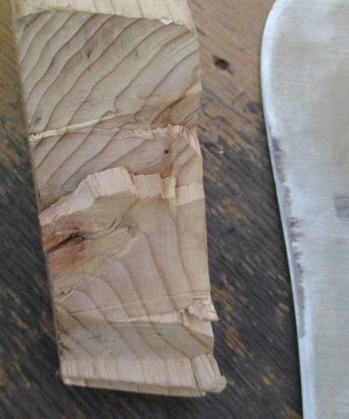

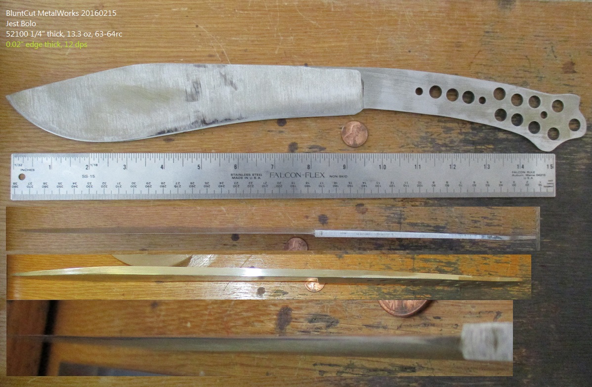

Here is the TIP (test in progress) of 52100 jest bolo. 13.3 oz (est with handle around 17oz); 0.02" behind edge thickness, 12 dps (no micro bevel). End up with edge geometry thinner than planned because I had to re-harden this blade then grind-off the decarb afterward.
There is a little rippled on the edge (on the ramp of the recurve) from light chopping seasoned knotty olive wood. No problem with hard chops into seasoned oak log & board.
No micro at 12-dps and only a bit of rippling evident...
Do you think you might need to add that micro-bevel or thicken the edge slightly to 0.025" against the risk of catching a bad hit a propagating a fracture up the primary?
How did the douglas fir board-chop go? <6 hits?
Edge geometry got measured after the test, oopsy too thin.
I mis-chopped (bad angle and deflected) the dried oak log (firewood chunk) around 5 or 6 times - no problem. Sure, I was a bit worry early on but onset to unfounded confidence lead me to hack dried olive wood. The ripple went around 0.015" up the bevel.

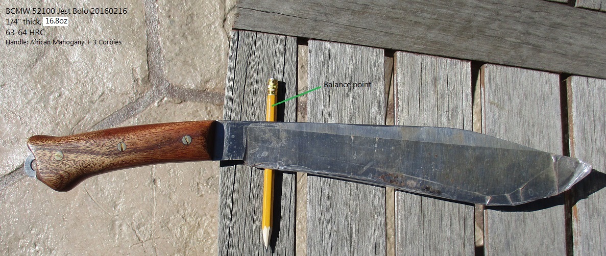

This 52100 jest bolo got new handle - African Mahogany coated with a fresh coat of oil. Current weight = 16.8 oz.
Thanks, Colin.
The adapted handle profile feel very secure in hand and comfortable too. So, I will use this handle profile for W2 jest bolo. LOL - first time drill holes for corby bolt, hence got the first time look.
