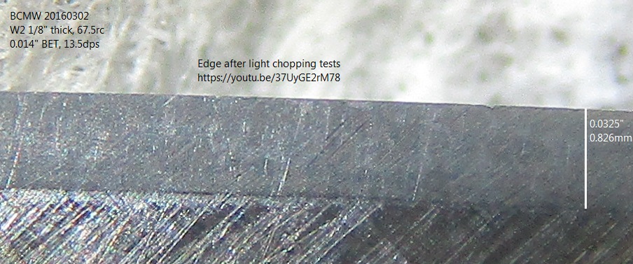

Light chopping tests
W2 1/8" thick, 3.5" blade, 67.5rc
0.014" behind edge thick, 13.5dps

Let's look at that W2 edge after light chopping tests. Aha, there they are - micro chips.
In spite of thin edge geometry, there is no large/macro damage. A projection - 67.5rc edge at 15dps may sustains light chopping tests w/o micro-chipped.

The damage sustained should not require raising the entire bevel to 15 DPS and 0.02" to avoid damage, why not just add a tiny microbevel at 15 or 20-dps?
The microbevel need only be 0.001" wide, it would be trivial to add and have no measurable impact on cutting efficiency but should provide the stability required to prevent the damage presented. If it does not, a slightly thicker microbevel and so on.
