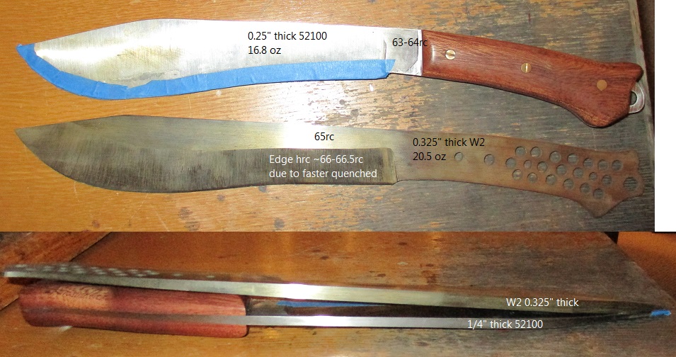

0.325" thick W2 jest bolo #1. Well, its near edge hardness is estimated about ~ 1point higher than my target rc. Yeah, on flat spot near spine, I targeted for 64rc. I light chopped some seasoned pine log, edge is fine. However, I need to harden a few small W2 test knives using same ht params as this W2 JB1. Rather zero-in hrc using small knives than break a large chopper.
Target completed weight ~24 oz (1.5 lbs)
W2 JB#2 has FFG. 52100 JB has high sabre grind. Both prepared but not harden yet.

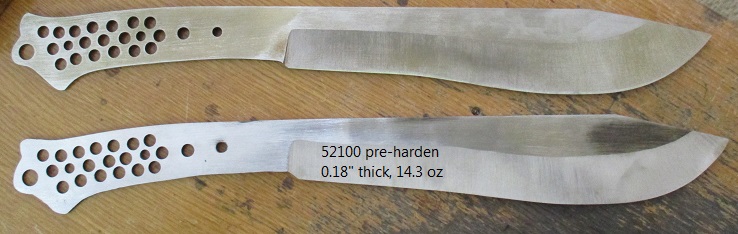

I cut a 0.156" thick 52100 jest bolo blank (cut from a 2" wide bar) weighted right around 20 oz. Probably it will sports a high sabre grind, maybe some tang skeletonize holes, iffy taper tang and use super light handle material. I think, completed weight around 13-14 oz would be fun to use. However...
dogrunner & others - what should be a good weight for this 0.156" thick chopper?
You look like you are going to hit a good weight. I like about 16-17 oz for a light weight chopper and if you can make one in that range that is effective, I'd be pretty happy with it. Above that weight - up to 21 -22 oz, a well-balanced blade will still feel agile / controllable to me, but one that is a little heavier or balance is off will make my elbow sore pretty quickly. I am not a big strong guy though, so the big (or young and undamaged ;) ) folks may laugh at my limits. But 16-17 oz is not too heavy to pack or use. Watching with interest!
After hardened (aim for 64-65rc) and cleaned up, it probably be 0.16" thick; 12.5oz. Completed weight could be 14-16oz depend on handle material used. Currently, without handle balance point is 3" forward from plunge line. I think a 15oz final weight would be a mighty powerful light chopper - ~chop 2x4 by 12 hits. ht warp could be a party-crasher...

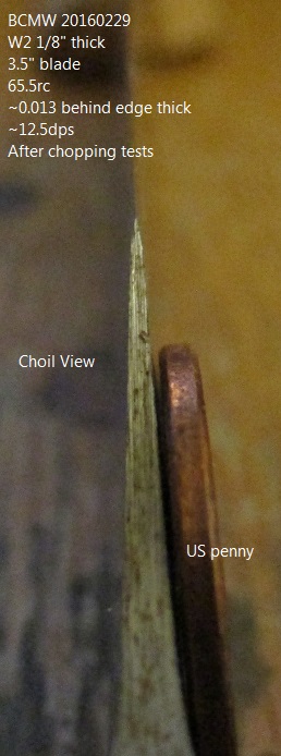

Hardened two 1/8" thick W2 3.5" blade, 0.013" behind edge thick, 12.5dps. Chopping & cross-grain batoning tests at 65.5rc hardness. No edge damage.
So, the edge of the W2 chopper above should be around 65.5rc. Since recent knives using same ht params end up with a tempered 65.5rc. I will slap a quick handle on the .325" thick W2 chopper and perform full tests. Initially edge geometry should be: 0.025" BET, 15dps (no micro bevel). If it passed all tests, I will test at 0.02" BET.
