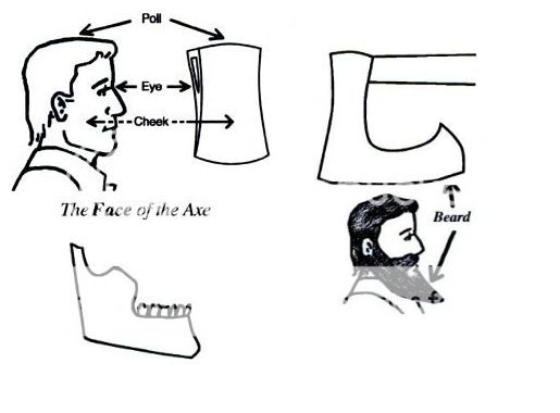

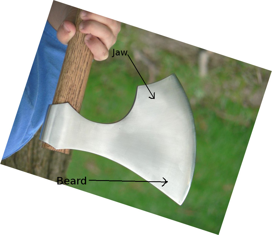

There seems to be some confusion about these terms. So just to set the record straight.

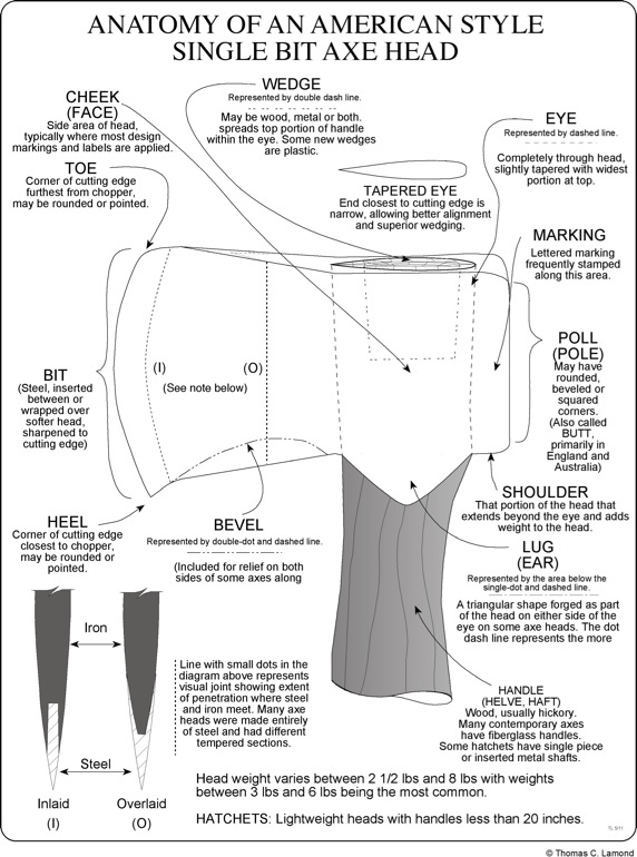

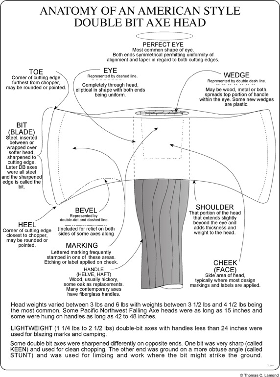

I had learned this in reverse, with the alternate/supplementary understanding of top and bottom corners being the toe and heel respectively.
...... understanding of top and bottom corners being the toe and heel respectively.
The heel is the corner of the axe closest to the knob or swell of the haft. The toe is the corner of the axe closest to the wedge.
That first diagram also illustrates the advantage of an inlaid bit versus an overlaid bit. An overlaid bit runs out of high carbon steel sooner than an inlaid bit. The inlay runs deeper into the core of the bit.
I could see, perhaps, the term "jaw" being used to describe the straight region bridging the curve of the edge and the line created by the descent of what is most commonly referred to as the beard. I have never seen a reference that described an axe in that manner.

We have a bearded axe with a toe?
I think the author may be trying to conflate two separate metaphorical terminologies. Poll, heel and toe work fine with the axe oriented so the bit is toward/parallel with the ground, as does eye if one wishes, but the common use of cheeks and beard seem to relate more to an an axe held with the bit perpendicular to the ground. I may well be wrong, though!
There are conflicting sources about this terminology, and perhaps neither is wrong.
"A bearded axe, or Skeggöx (from Old Norse Skegg, beard + öx, axe) refers to various axes, used as a tool and weapon, as early as the 6th century AD. It is most commonly associated with Viking Age Scandinavians. The lower portion of an axe bit is called the "beard" and the cutting edge of the bearded axe extends below the width of the butt to provide a wide cutting surface while keeping the overall weight of the axe low. The hook, or "beard" of the axe would have also been useful in battle, to hook onto things, such as shields or weapons, to pull them out of the defender's grasp... Additionally this design allows the user to grip the haft directly behind the head for planing or shaving wood." --Wikipedia
Wikipedia is admittedly not the best source, but there are plenty of online references to "skeggox" or "bearded axe" that agree with this definition. Searching for "jawed axe" turns up that Beaudry book, and an obscure mention of a jawed axe from Estonia [with no picture], that's about all I found.
