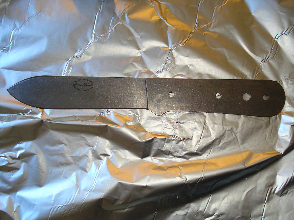

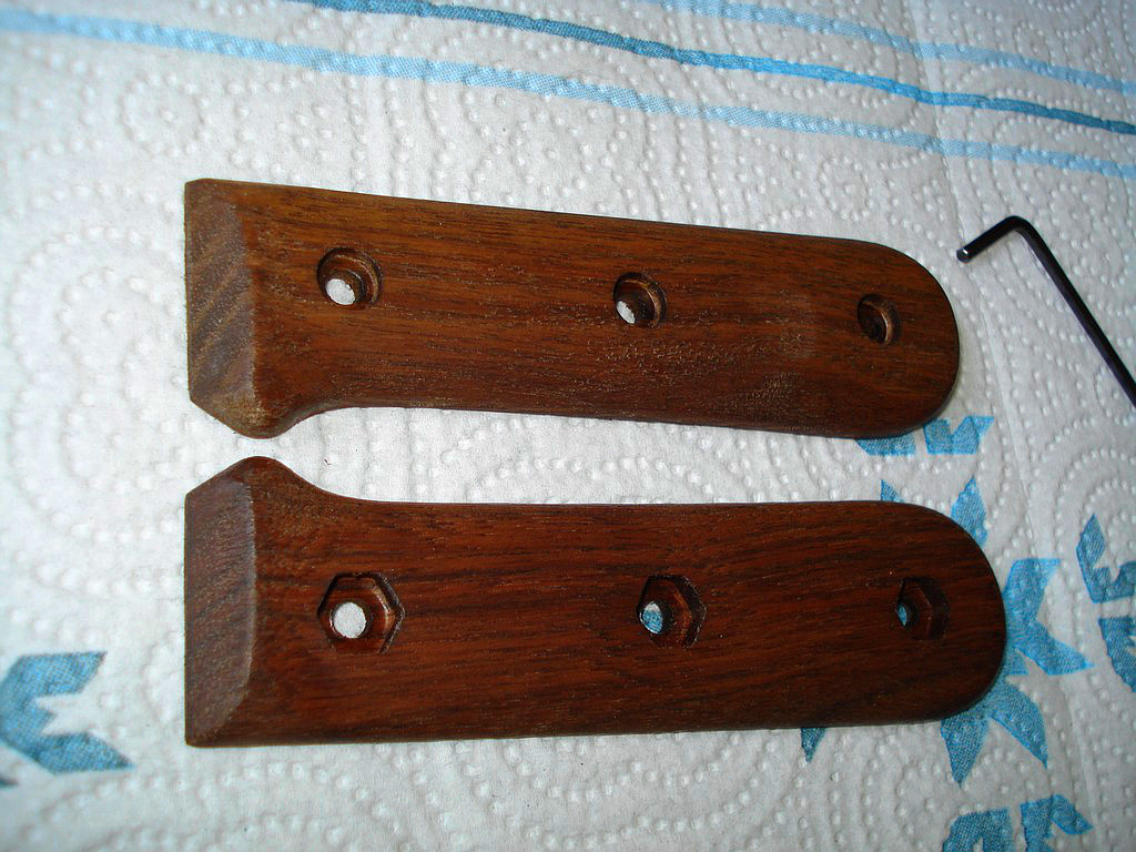

Anywhos, on with it. You've all seen photos of what it looked like when I got it. Some of these indoor photos suck.
Here she is before:

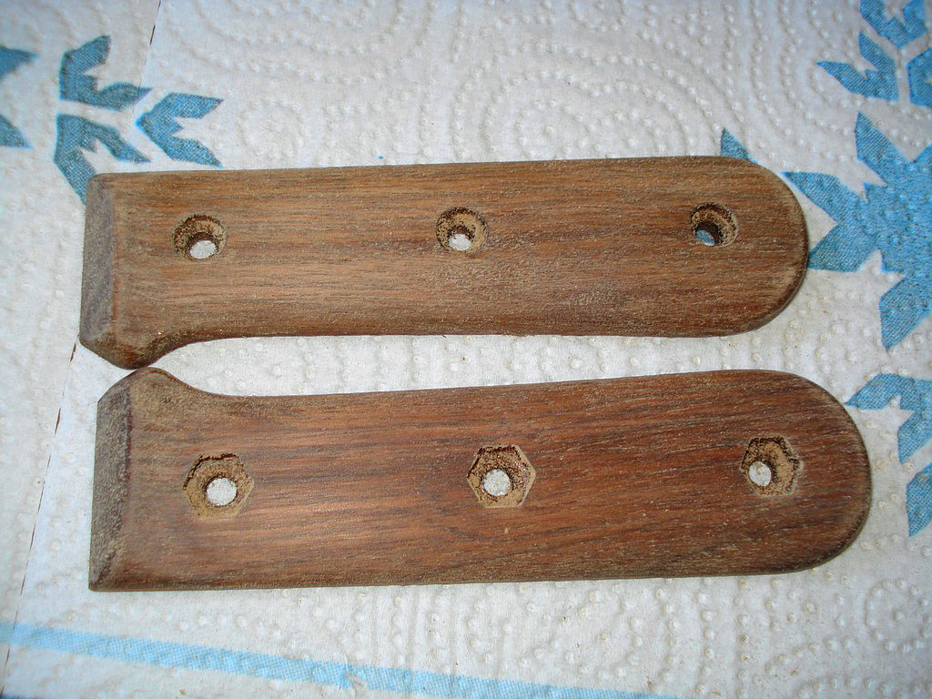

Scales off:

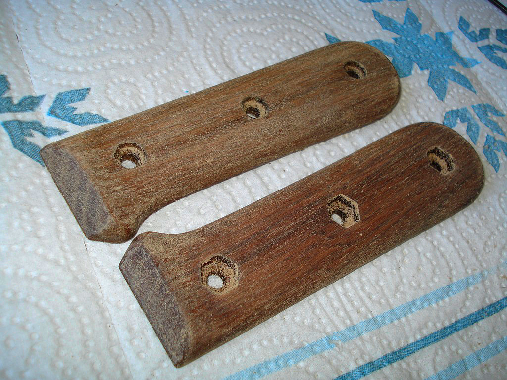

You can really see how the upper scale is more rough/dry than the other:

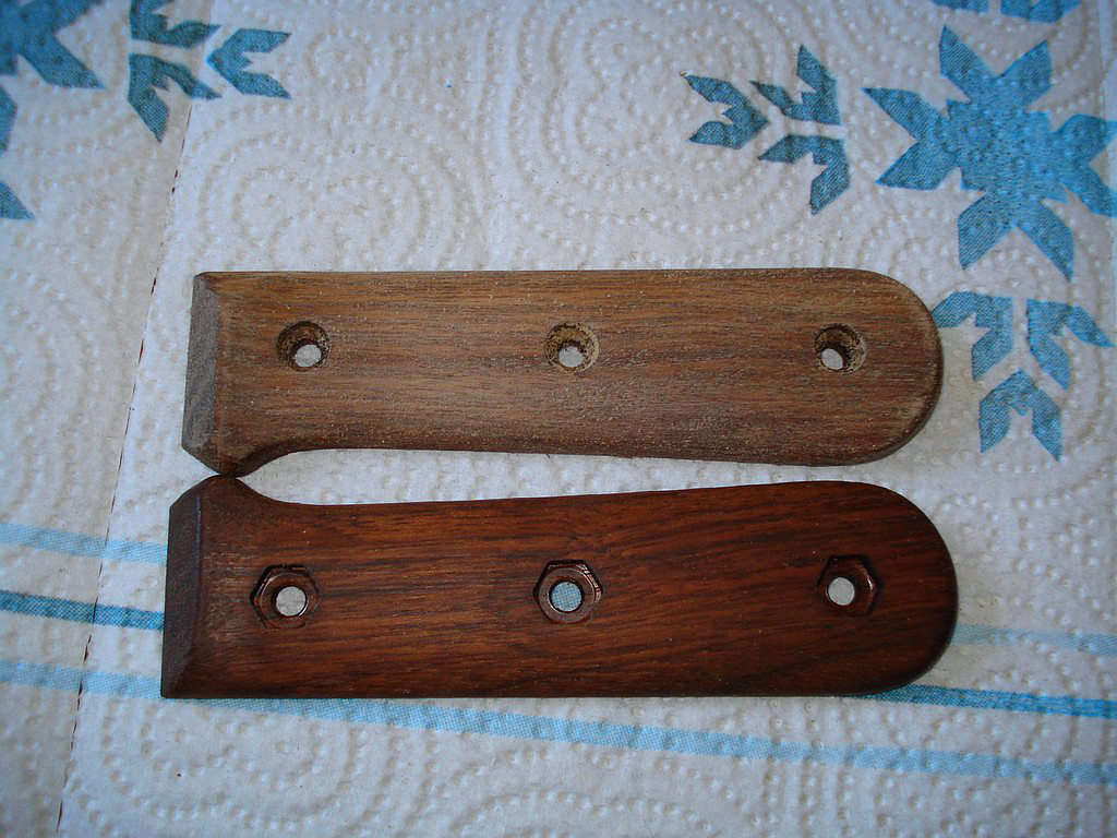

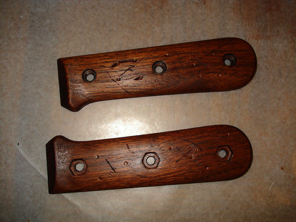

One sanded:
Both sanded:

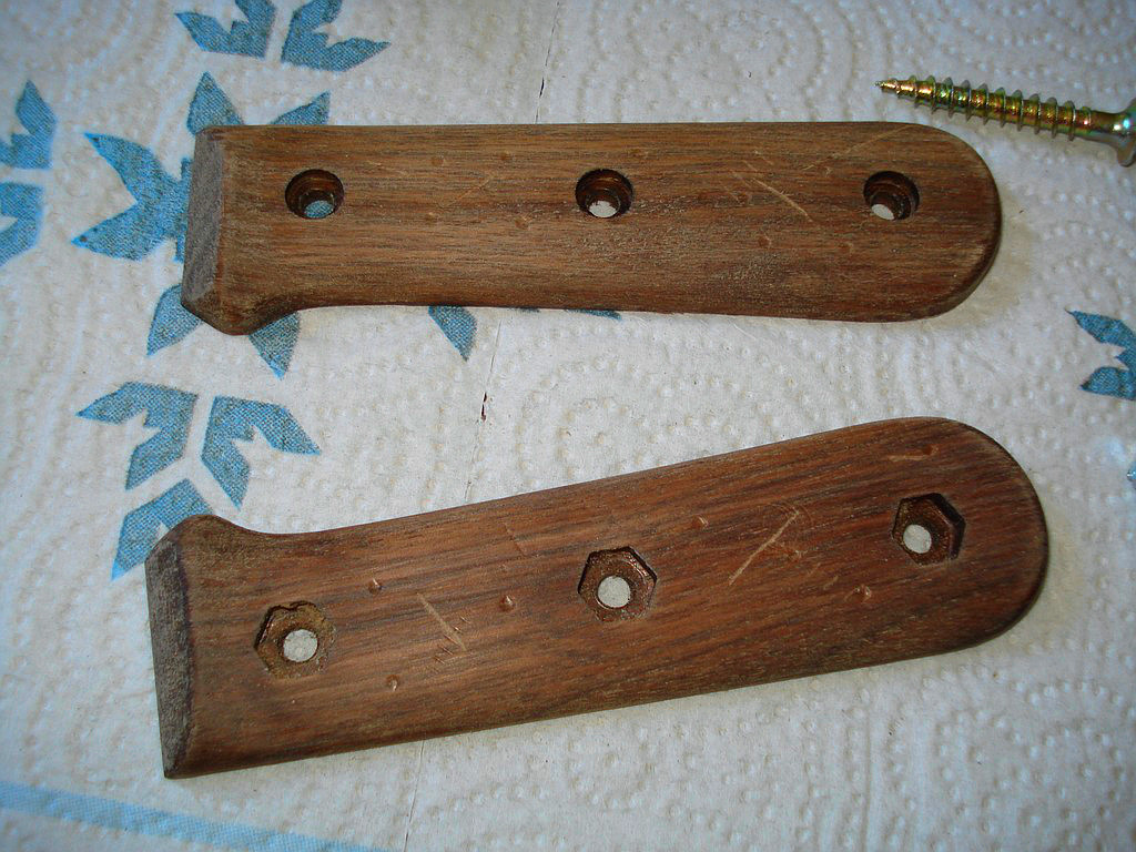

I took a screw, and key and distressed the wood:

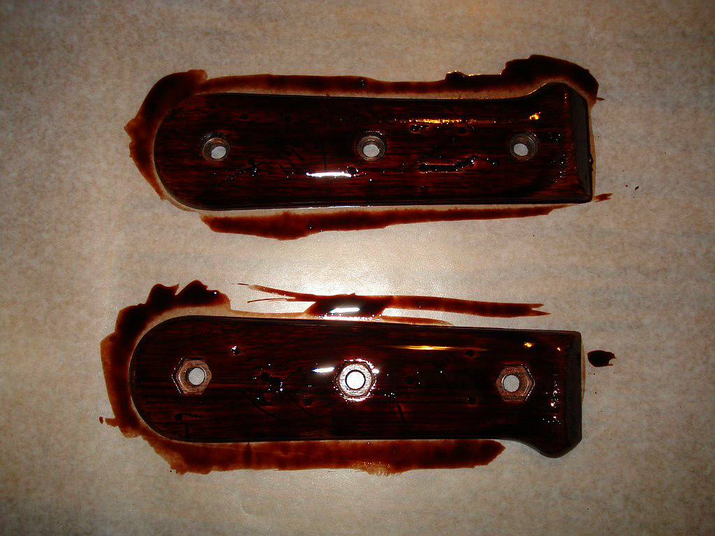

I then took some Watco Danish oil, and applied it:
First coat:
Second coat:

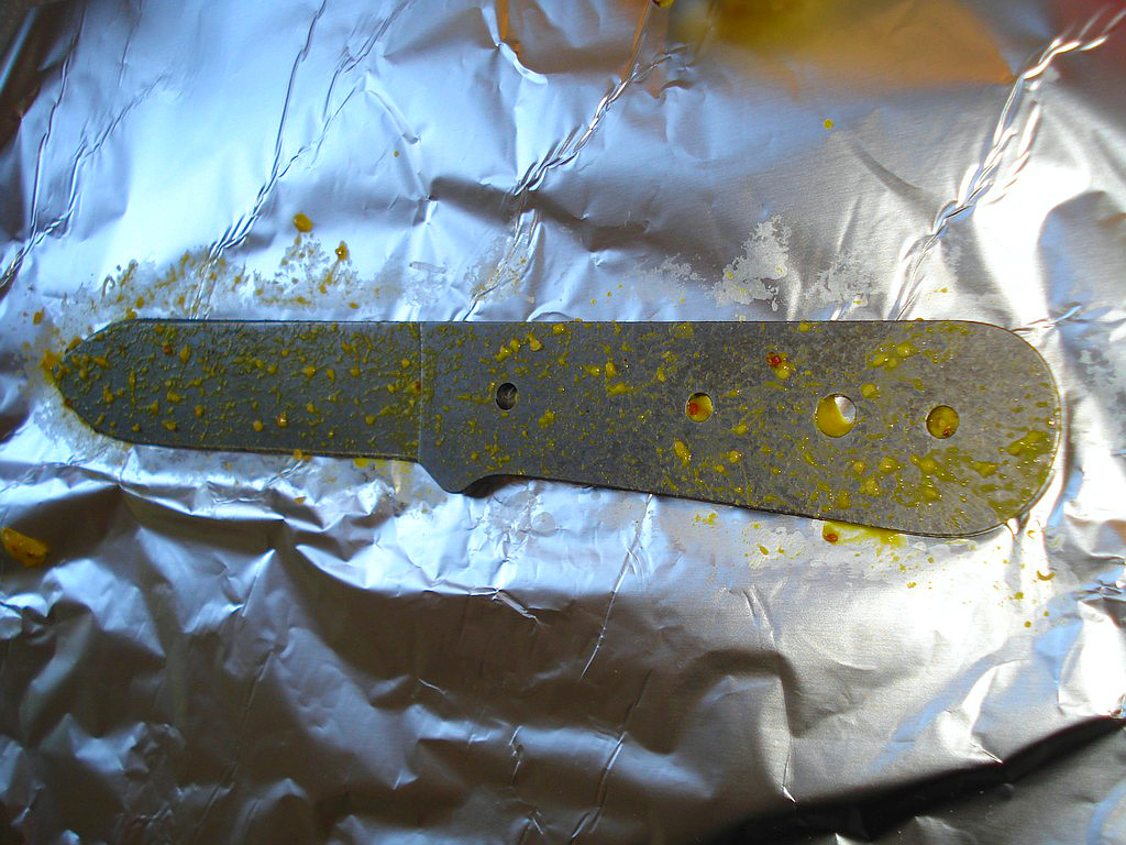

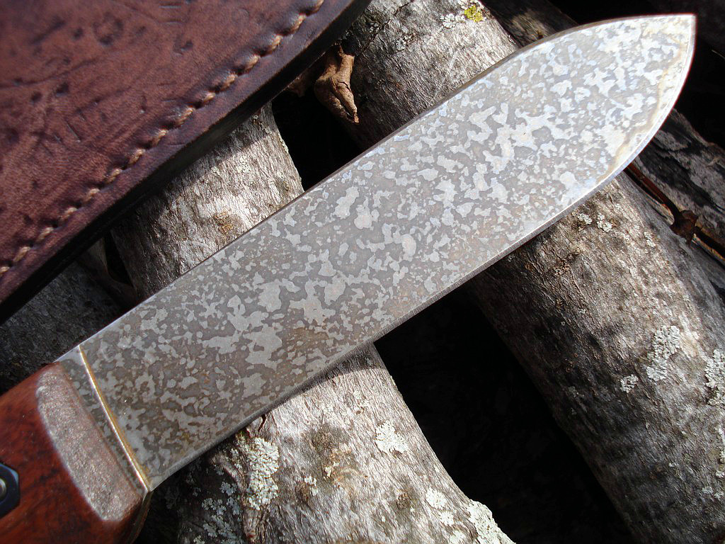

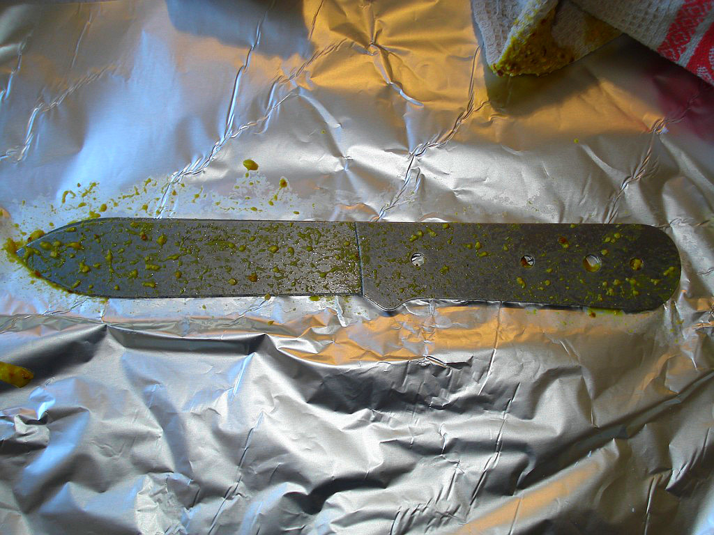

Meanwhile, while that's soaking in, time to put a patina on it:

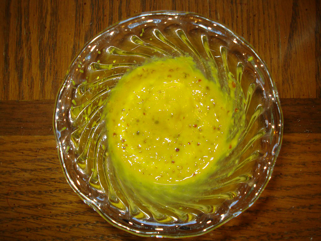

My secret concoction. Not really, it's yellow mustard, with coarse ground horse radish, with a little apple cider vinegar for darkness:
Dabbed it on:

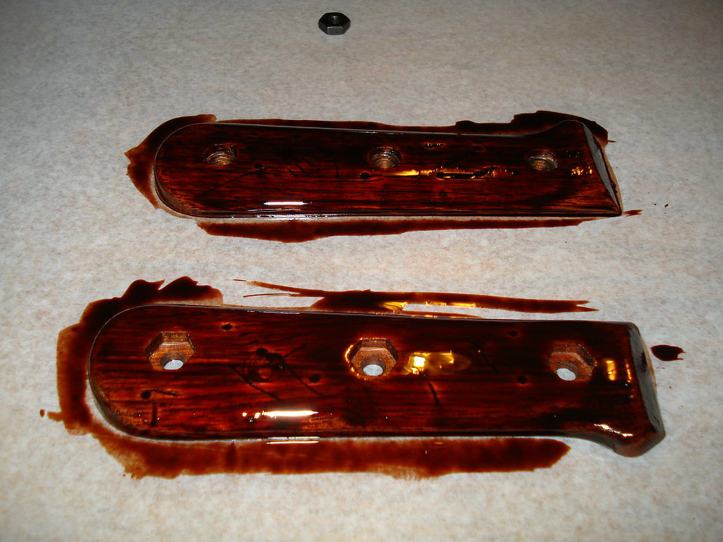

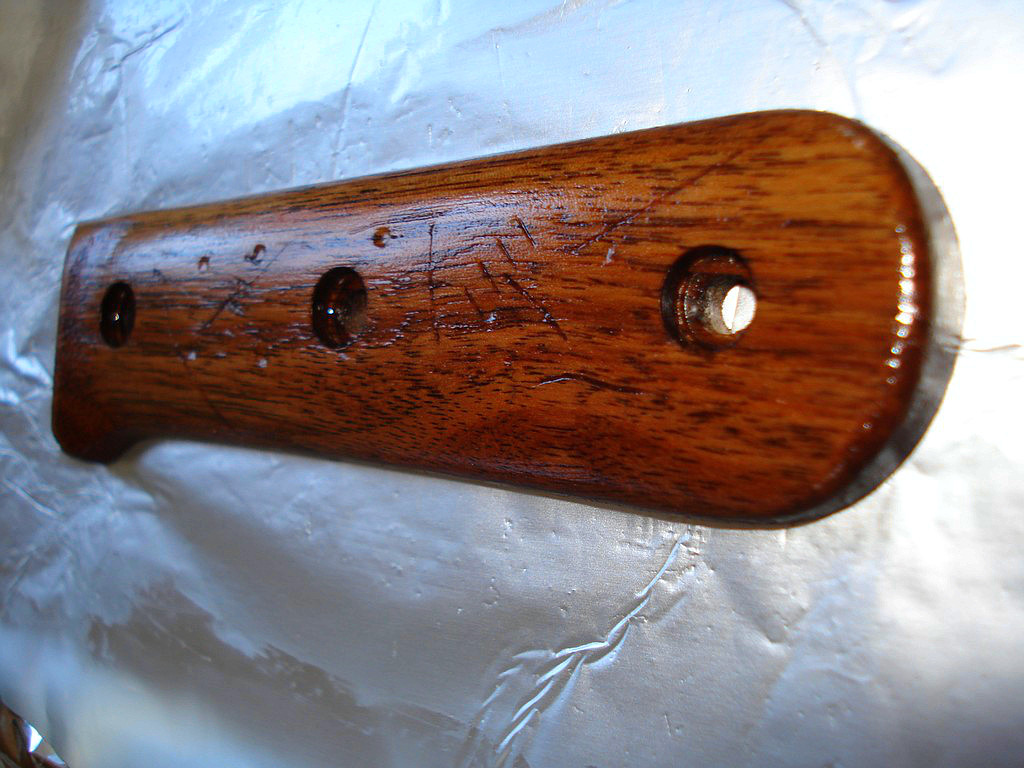

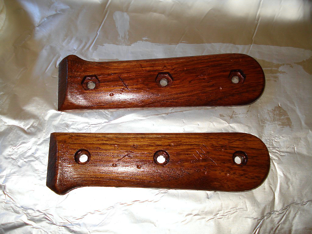

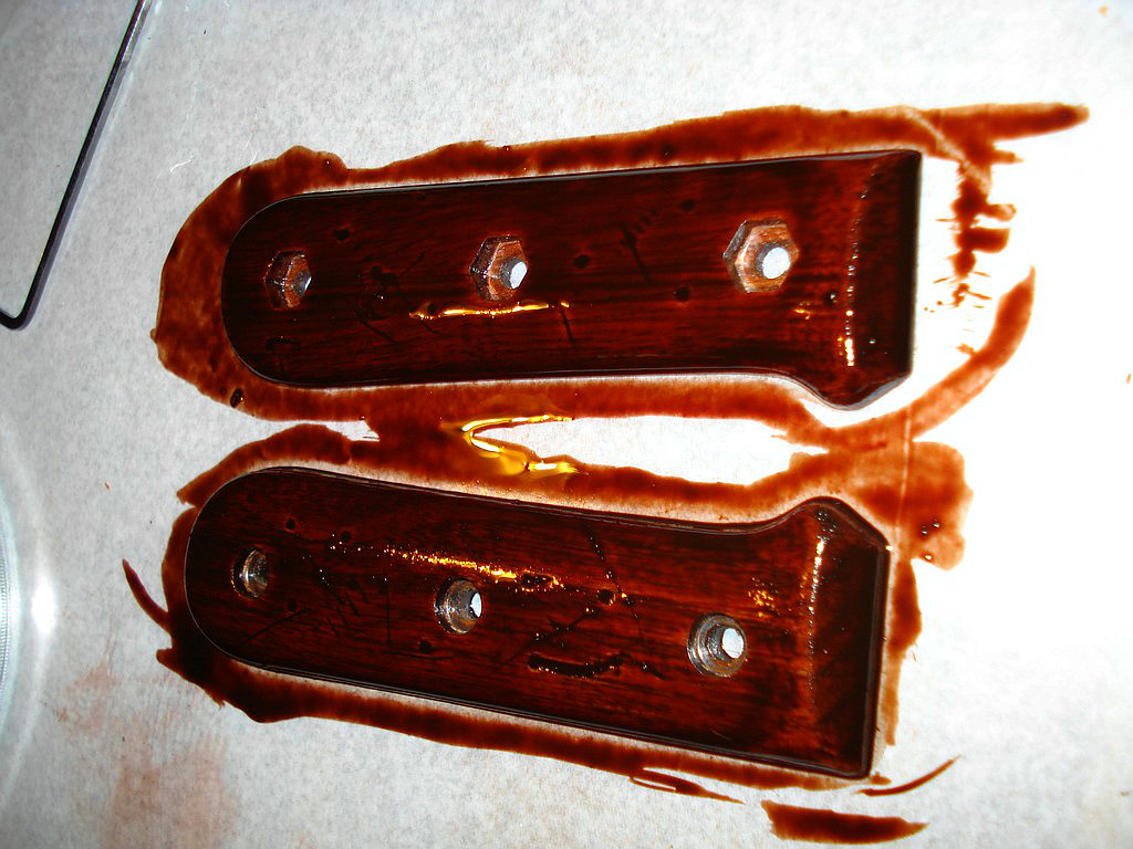

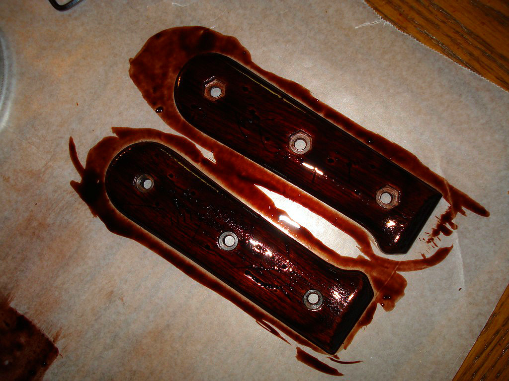

I took photos of it when it was done and put back together, but I wasn't satisfied with the darkness of the scales. I wanted it darker. Didn't know how it would work, but I stained it after it already had the danish oil on it. Seemed to work fine.
First coat:
to be cont...
Result:

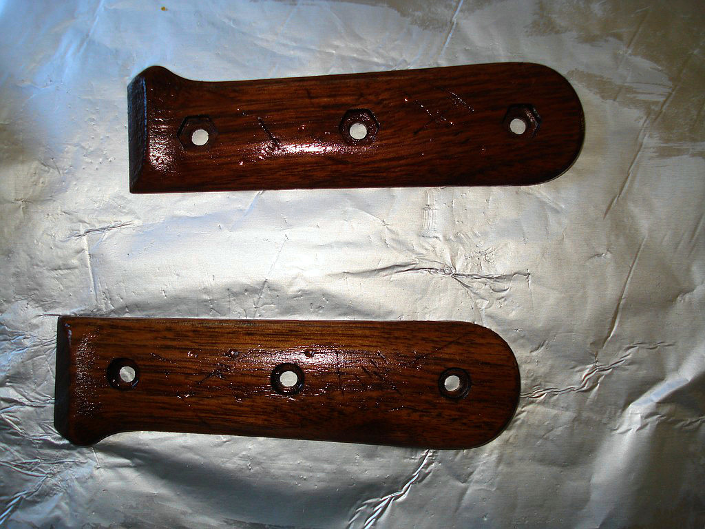

Second coat:

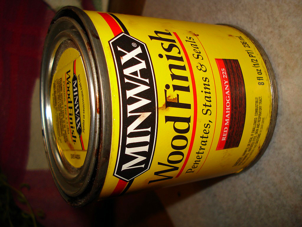

Red Mohagany was the darkest stain I had, so I rolled with it:

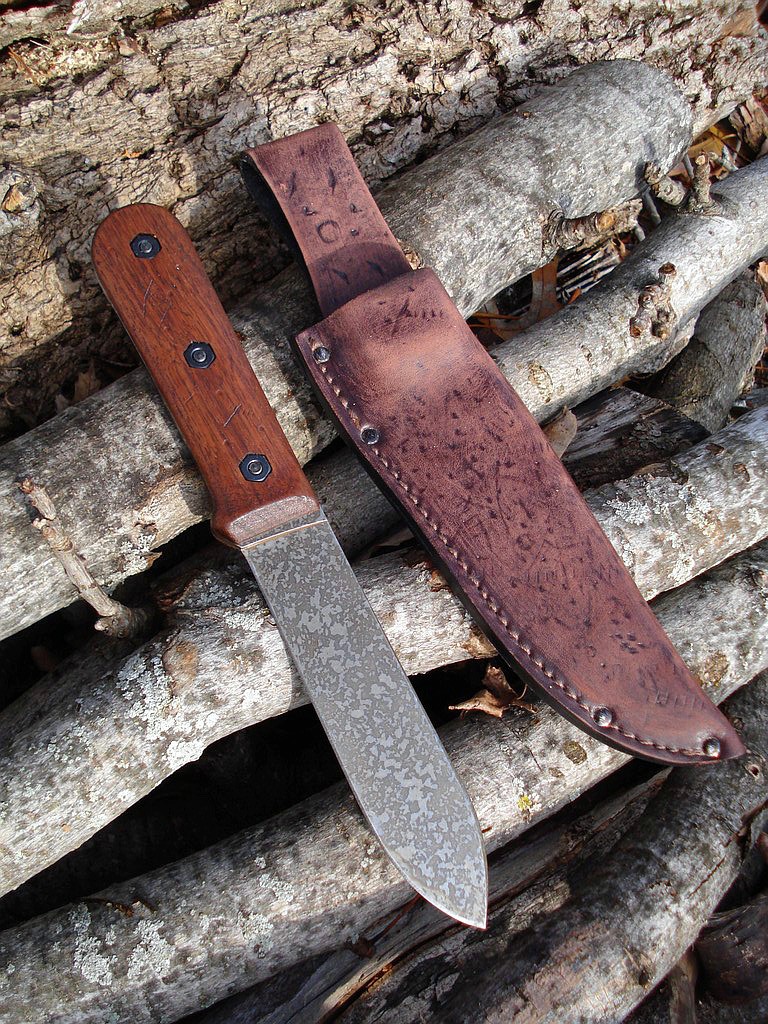

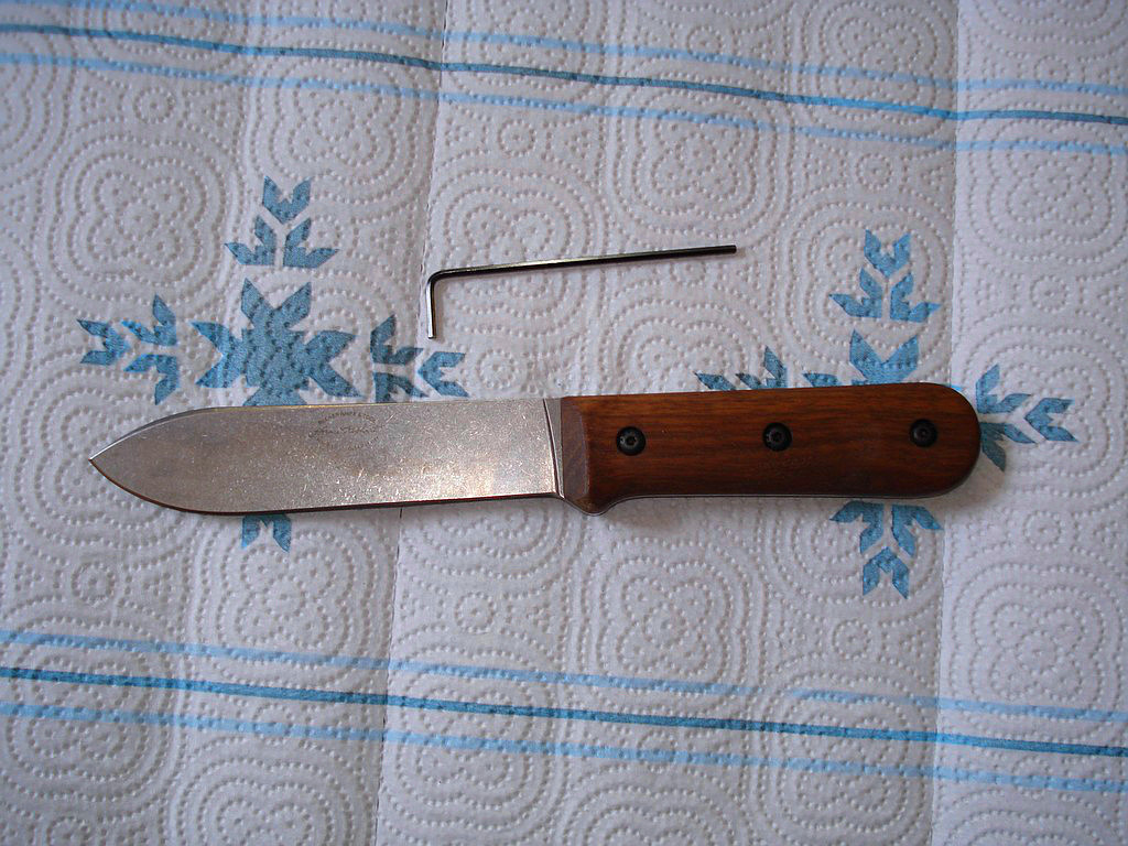

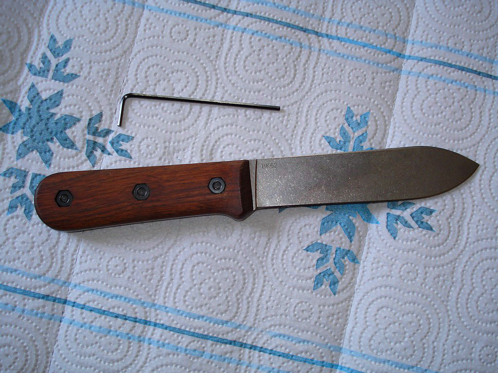

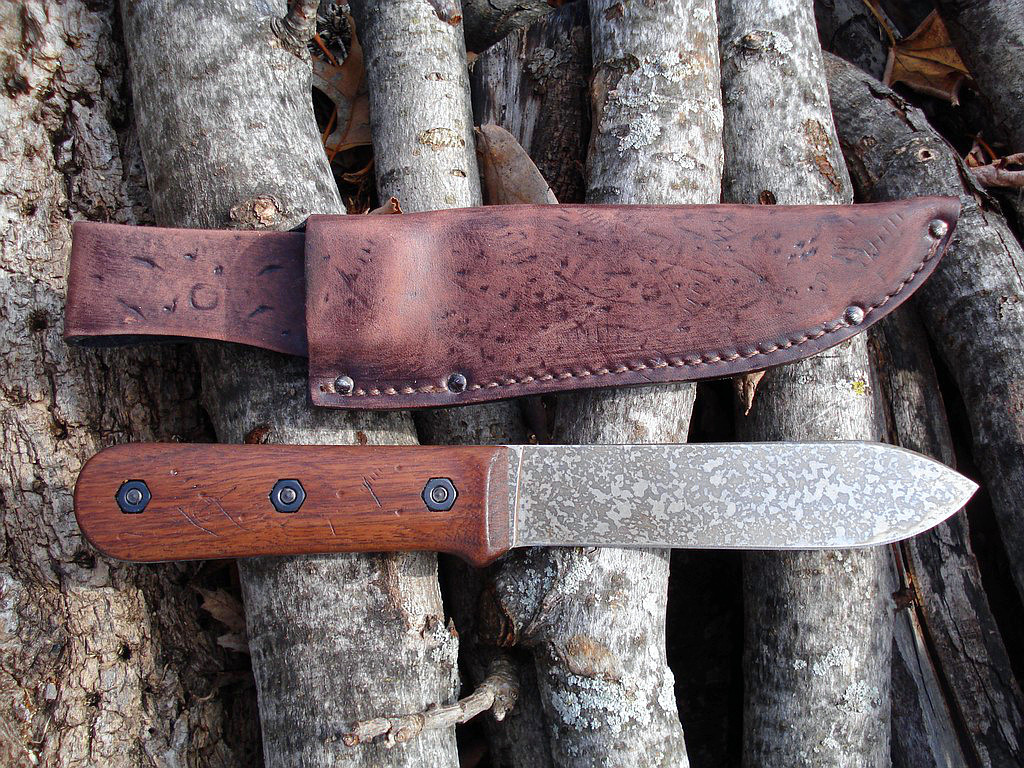

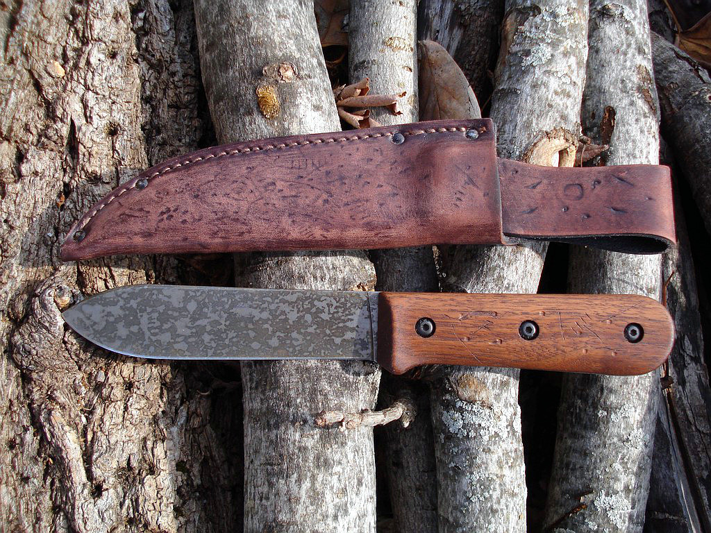

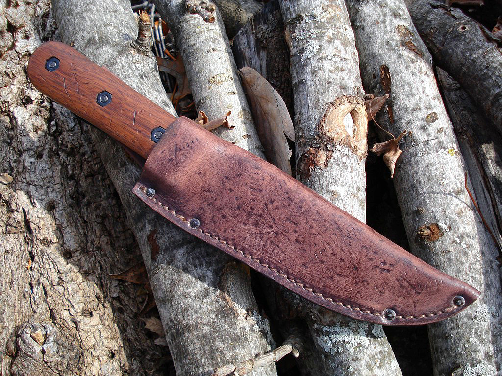

My intent for this whole mod, was to simply make it look older. I think I somewhat pulled it off.

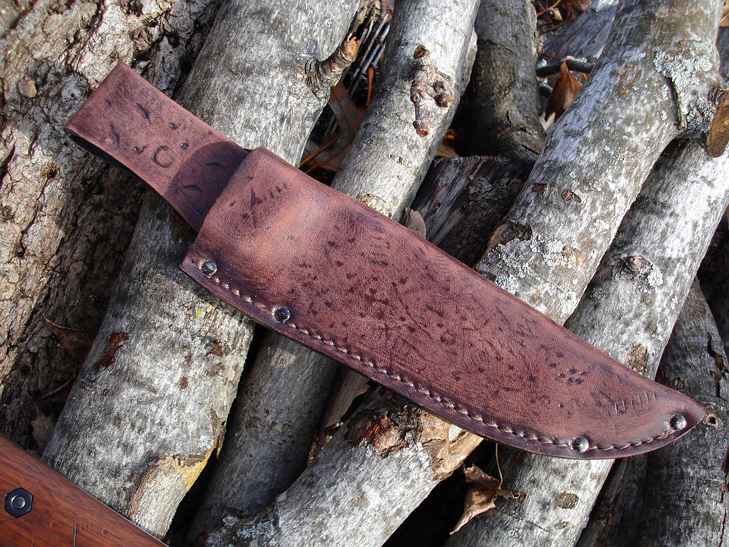

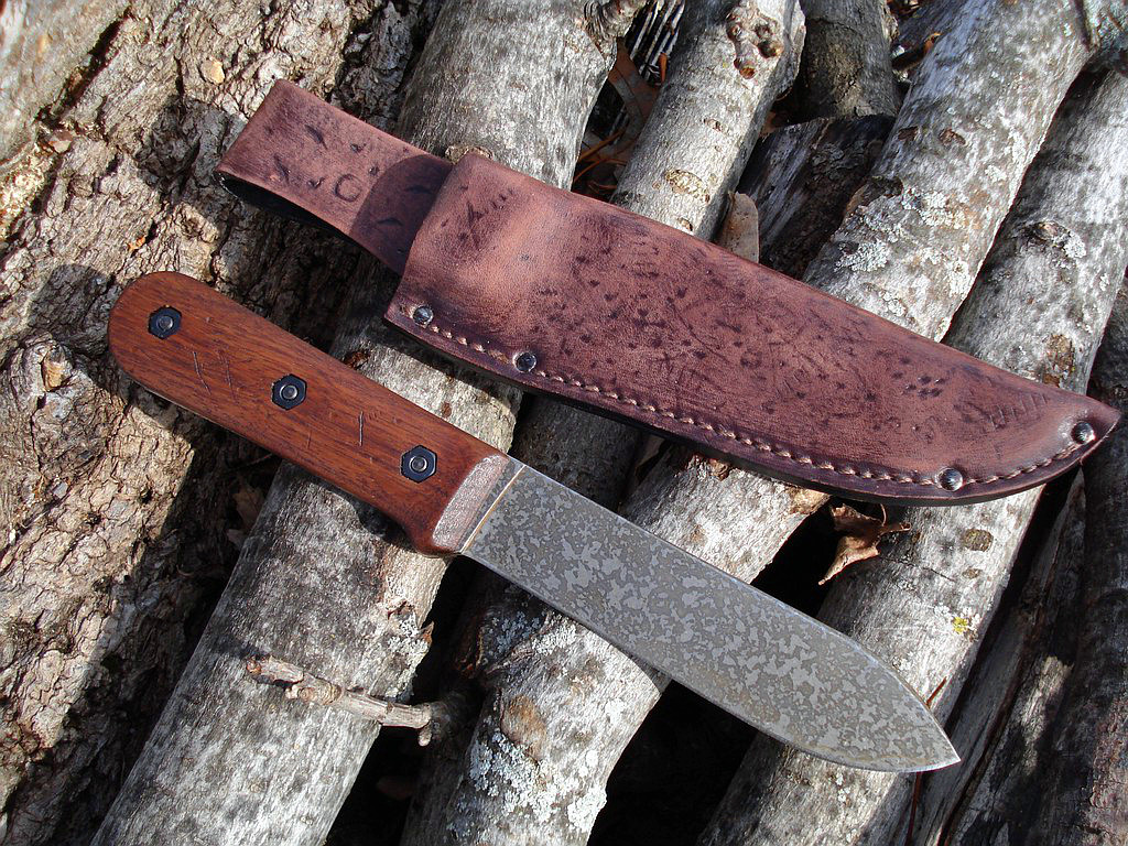

The results. I also distressed the leather sheath, to age it, although I didn't take photos of the process. Also, the sun didn't cooperate during the photo session:

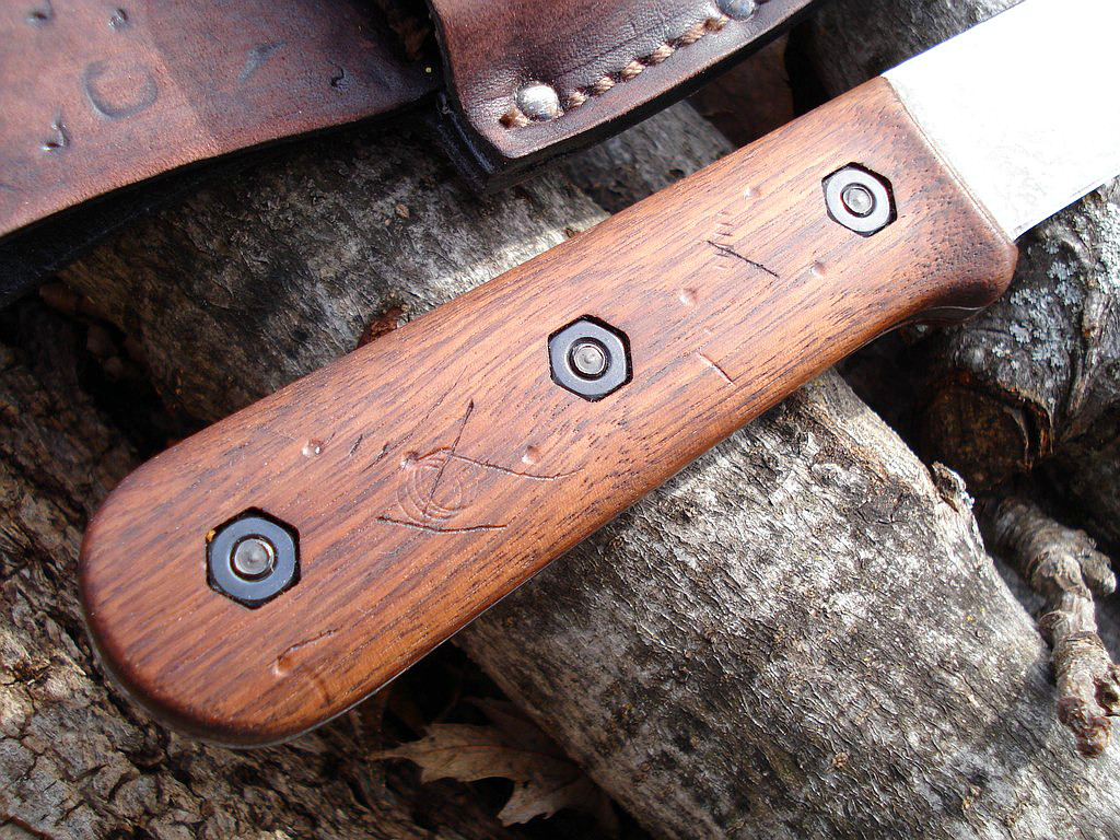

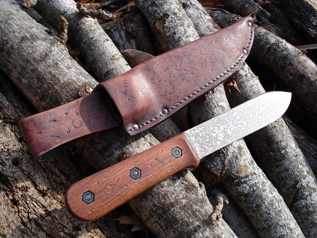

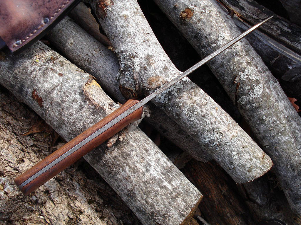

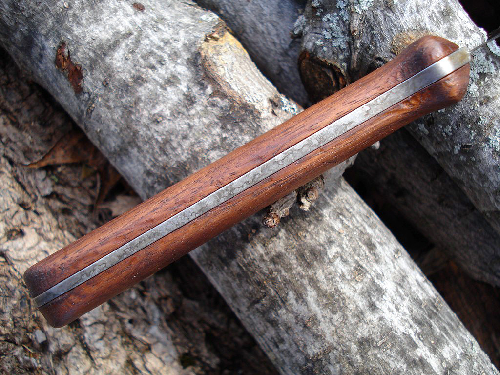

Close up of the handle. Was wanting it darker, but it is what it is:

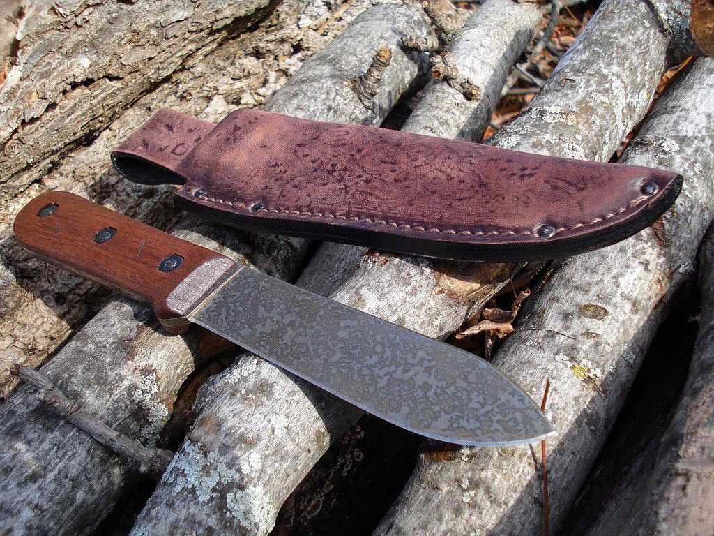

Really like how the patina turned out:
Patina on the edges too:

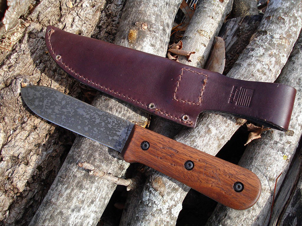

Other side. I didn't stress the back of the sheath. Patina not as good as the other side, but I still like it:

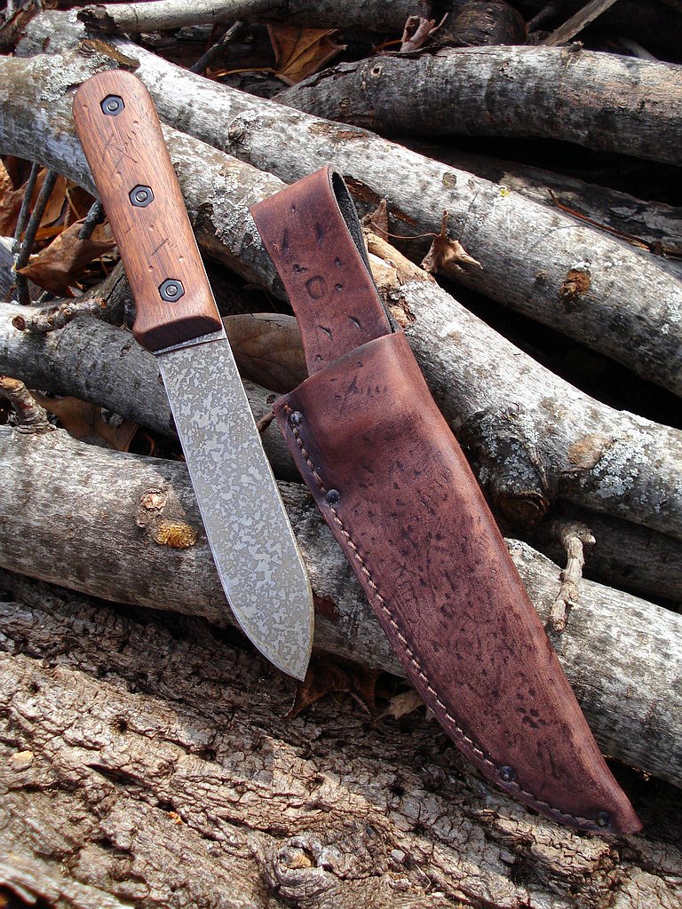

Few randoms:
Sheath:
Not exactly as I pictured in my mind, but still fairly happy with the way it turned out.
