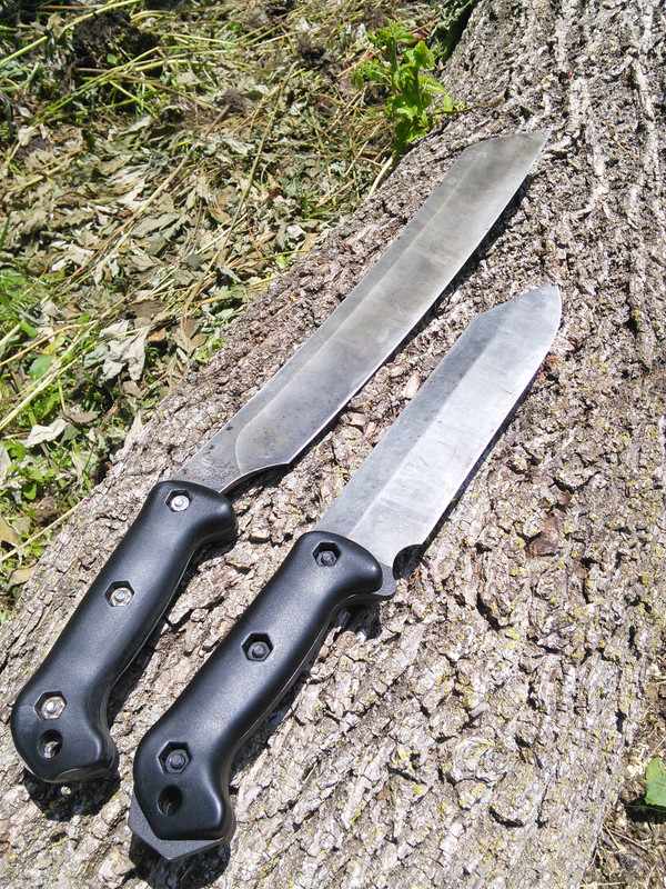

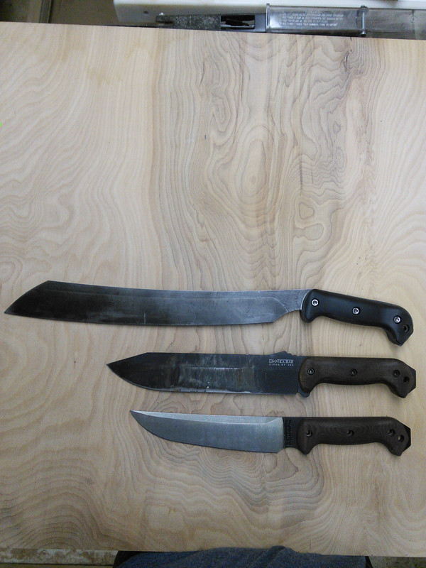

I love big knives, but unfortunately missed out on the larger Becker's of recent years....So I decided to mod one of my own.
Because of a fraudulent website I purchased mircata scales for a BK4 that I'll never receive......that worked out, one thing led to another, and my NEED for a Becker made me jump on a nice slightly used BK5. I instantly stripped it, and replaced it's scales. I love it.......
Next, You guys talked me into a Nine. It's good too.
But what to do with my extra scales?
Hmmmm?
I previously had the Parangatang....
I can't say enough good things about the blade.
I can't say enough horrible things about the scales/handle.
I made some modifications, originally planning on carving a large walnut handle, but fate stepped in.
I hope this isn't inappropriate posting this?
And with all due respect, I'd definitely buy this from Mr. Becker!
It's really Awesome, and I put it through it's paces. It's very comfortable.
I need to clean it up some and make it pretty. Right now it's a User.
I'll post more pics after I do, and answer any questions.......heck, I'd probably lend it out like you guys do..... But I'm not a Beckerhead yet? ;)

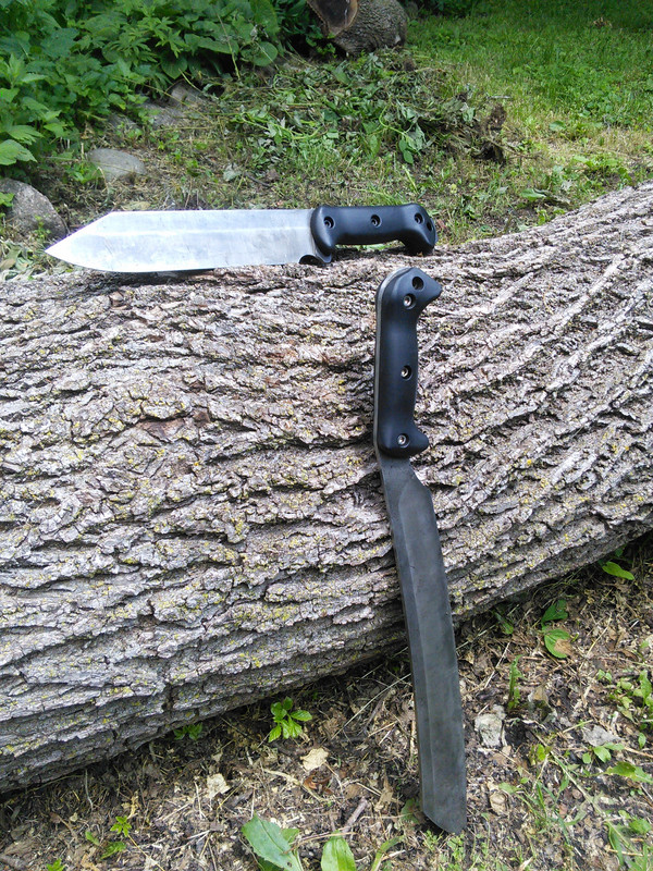

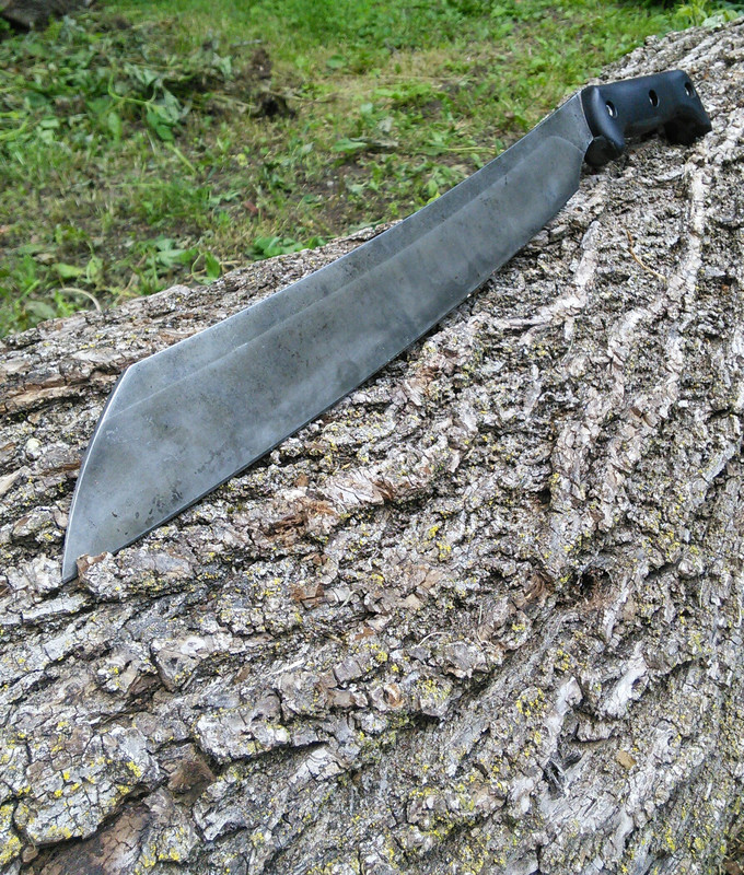

Yes, and No......
I played with how I wanted the angle of the handle. I felt that was more important than looks. With that, I had a fair amount of Tang to grind down on the topside. It took awhile..... I had previously ground down that uncomfortable point on the parang's underside, so idk how much gap their would of been? I Did need to fill some gaps in the but, and underside. I used JB Weld. I have some more touch ups, but initially, I really like it.
I love this knife now, the Becker scales makes it a Real user!
If you look, the coil gives it a Great deal of control and Ballance......I also think the looks and lines are pretty sweet..... (To Me). It looks like it Should be made.
Haha!
Pretty cool man. Looks like a chopping beast.
It Does chop like a madman......but Stabs even better!
It just points very naturally....even in reverse grip. The Becker scales bring it to a whole new level....
I learned yesterday, that with that huge choil, I can actually choke up on it which allows me to use it as a two-handed short sword...... It's So fun! :D
