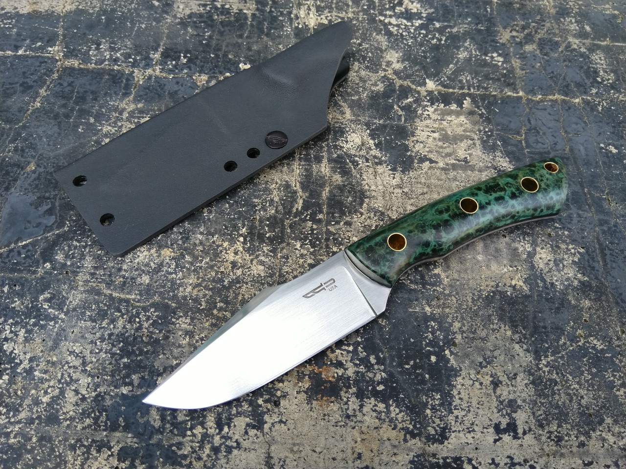

https://www.bladeforums.com/threads/harpoon-belt-knife-in-aeb-l-and-black-ash-burl.1671093/
Beautiful! Please pm me if the time ever comes, I’d love to own a daizee daizee in my collection. Same thing goes for you hawkhead hawkhead . You guys keep crushing it! :thumbsup:

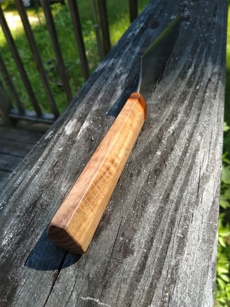

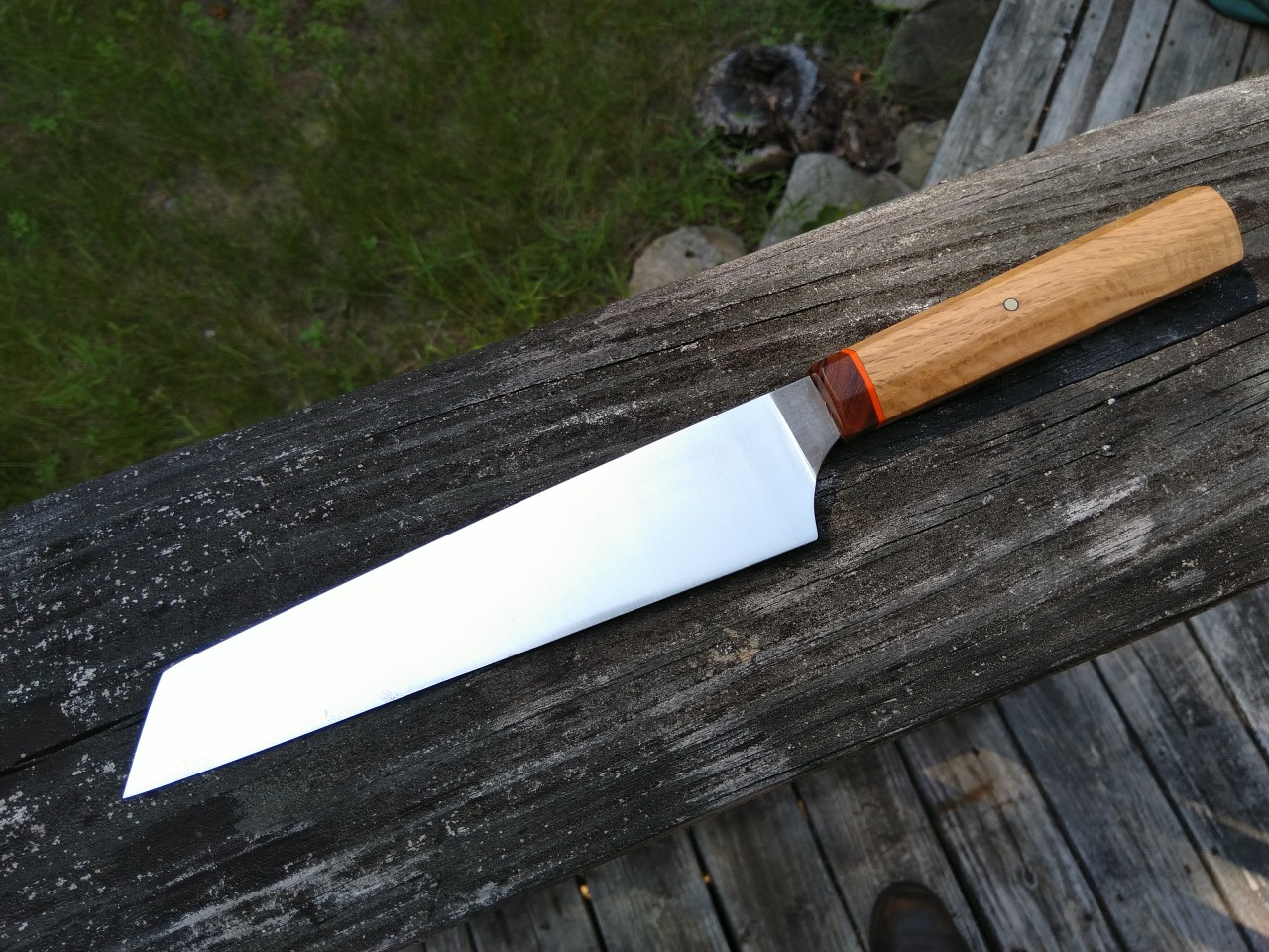

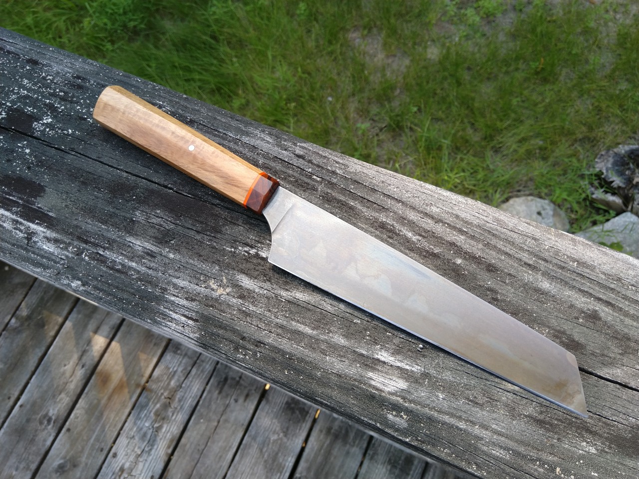

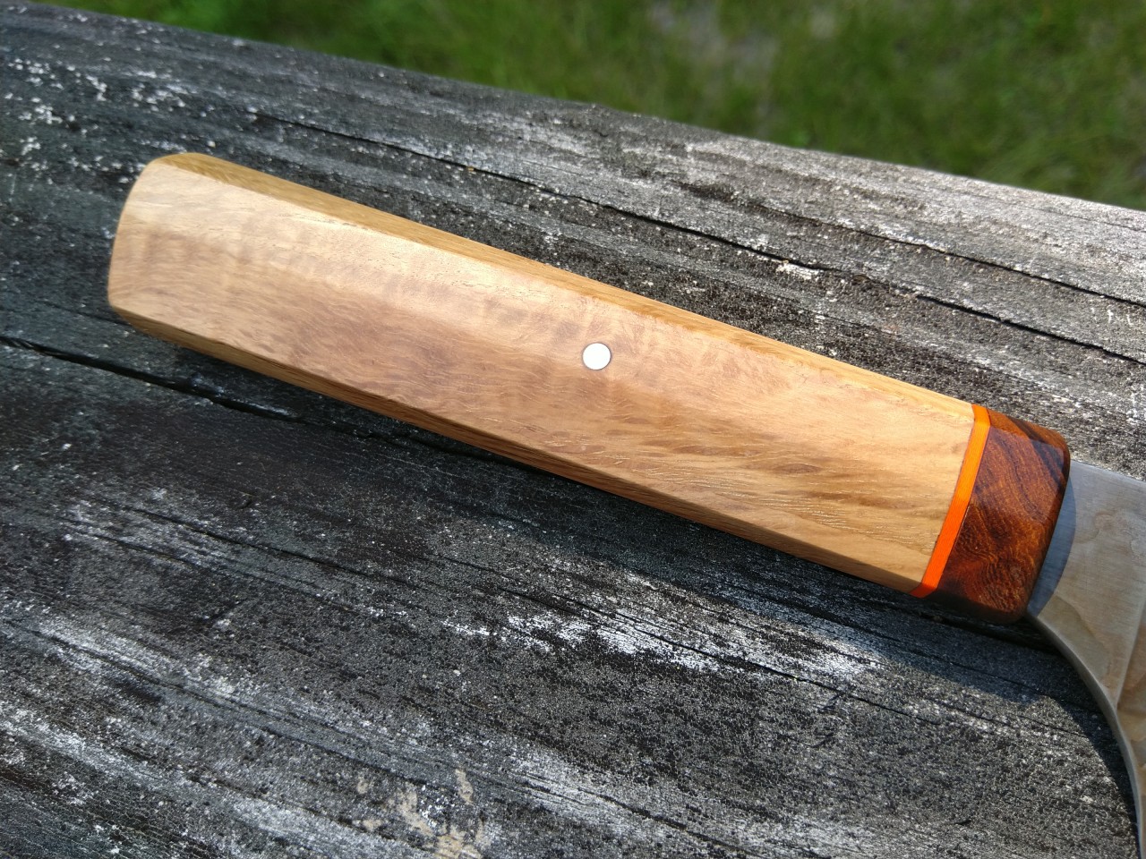

:pFirst test blade in 15N20 with a quick vinegar etch to check for a hardening line/hamon - yup! Other side is belt finished bright to see how food acids affect this steel. Some pretty white oak on the handle is overshadowed by the ironwood and in-your-face G10 bolster scrap from another project.
