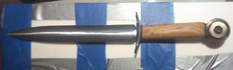

Better than I did, I couldn't make it that far. Still, alot nicer than it was before.
Looks great! Mine is pretty cloudy, I just don't have time to finish it. How long did you sand it with what grit?

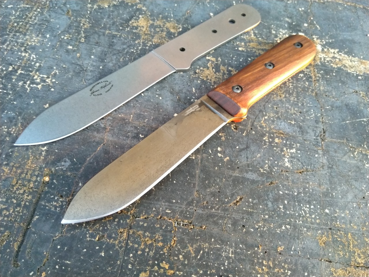

I'm kinda into this pattern, as you can see, first one on the bottom.

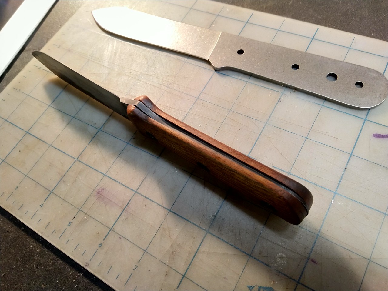

I have been informed that there will be aftermarket scales available for the BK-62 bolt pattern later this year from a third party vendor, which is good because I don't want to make handles for these! Though I'll give it a go at least once for "research"....

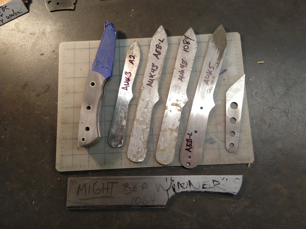

Look what you made me do...
Imagine how far I could have gotten in 3hrs working on just ONE blade instead of six! :rolleyes:
But I had the 5" wheel running full-tilt with the remains of a proper 3M 984F 60-grit, and just kinda went to town on everything that needed that setup. Then switched to the platen and gave them all the same treatment there too...

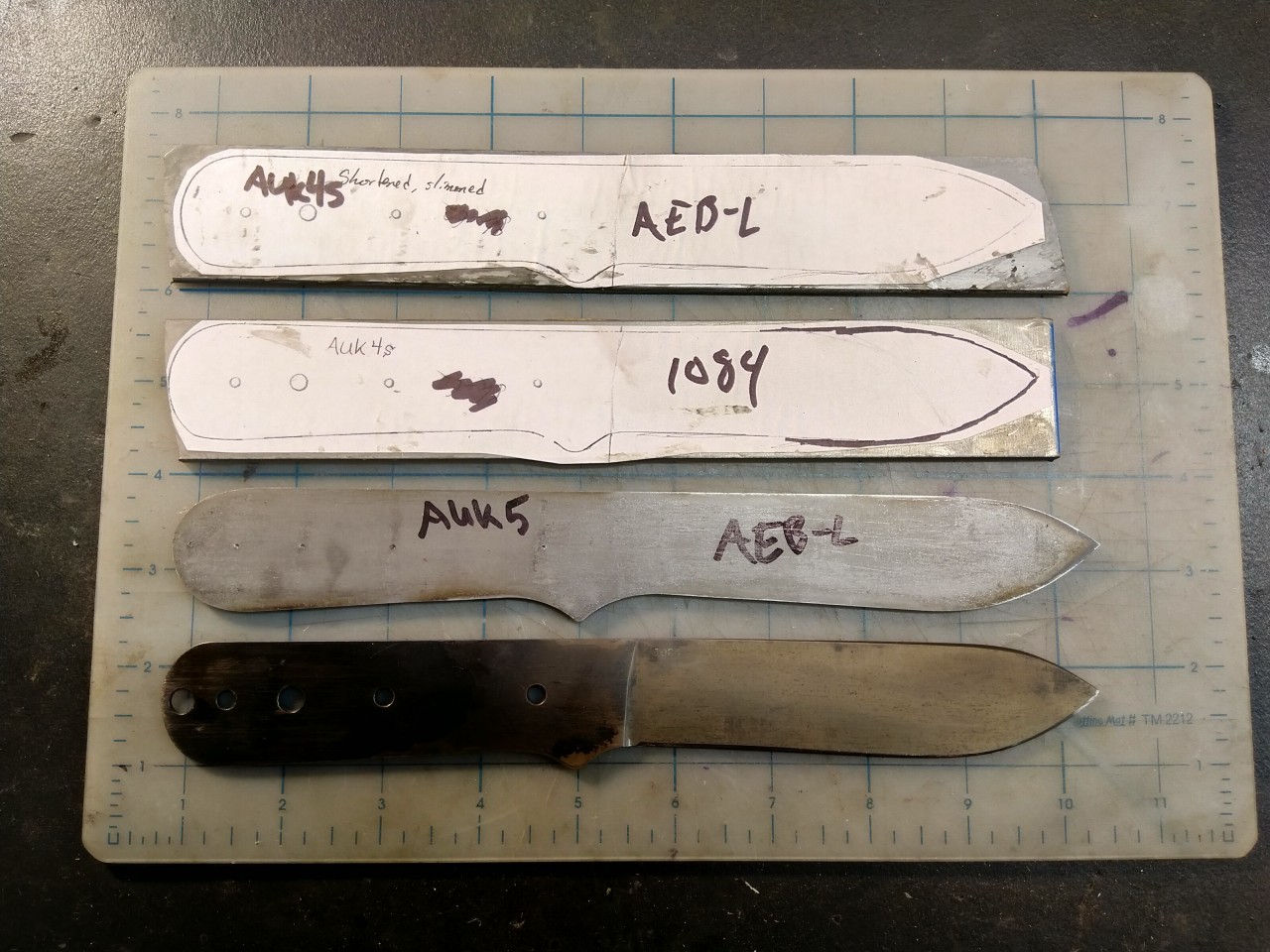

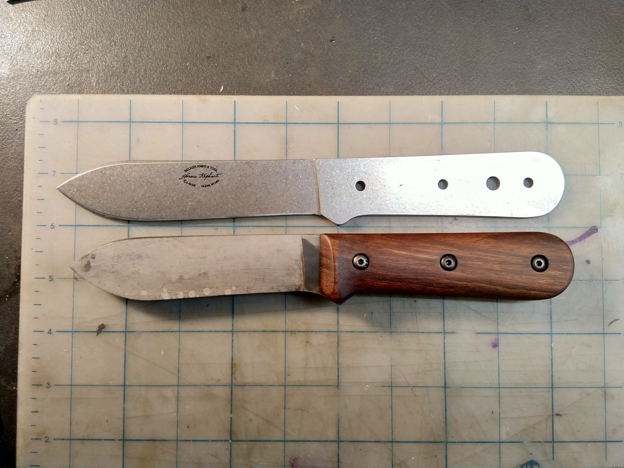

I was going to try to get the AEB-L pieces ready for heat tonight, but learned there's a birthday happening at Knife Night, and I didn't have the energy to get all that done AND go out for dry ice AND then try to work a kiln cycle amidst the festivities. So I cranked out the first AuK4S in 1084 this afternoon. Hoo-boy, let me tell you: i think this is the one. Blade is a tad shorter as shown, but same max width at the belly, and the handle is slimmed just a touch, which you can see vs. the factory BK-62 scales. Grabbed this piece of 1084 thinking it was 0.156, turns out it's 0.165. Pretty beefy, but ground to a nice pre-edge thinness.
Too freakin' cool man.
Yep! The plunge is forward exactly for that reason. I find myself wrapping my finger around the front of the waddle on the BK-62, and then shaving my finger. Piloting a couple more ideas right now, hopefully will be finished tomorrow afternoon with pictures.
