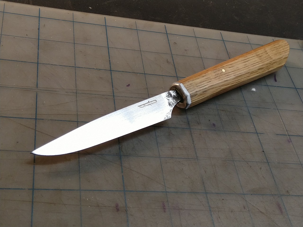

Final progress!
The bolster is a bit of a disaster visually, but is holding together at the moment.
In the second-to-last picture you can see a crazy hardening line, which totally surprised me when polishing. The finish is only 400x, so it might really pop if I had gone higher. Not sure what the steel is, of course, so it's shallower-hardening than I expected. Either higher or lower carbon, can't tell. But at 350F temper it was ~61Rc. It didn't air-harden too much from forging, which was nice.
