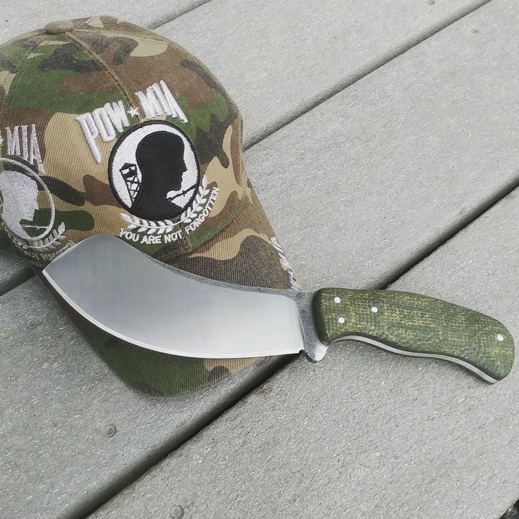

Nice work Nikki. One day I might have to get a Remora. I'm liking what folks are doing with the scales.
Ha!

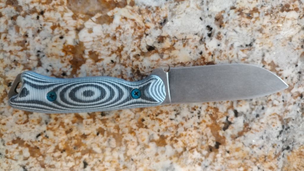

I just made the liners.
Scales are TKC (knife connection). I've made several out of various materials, but none quite compare to these.

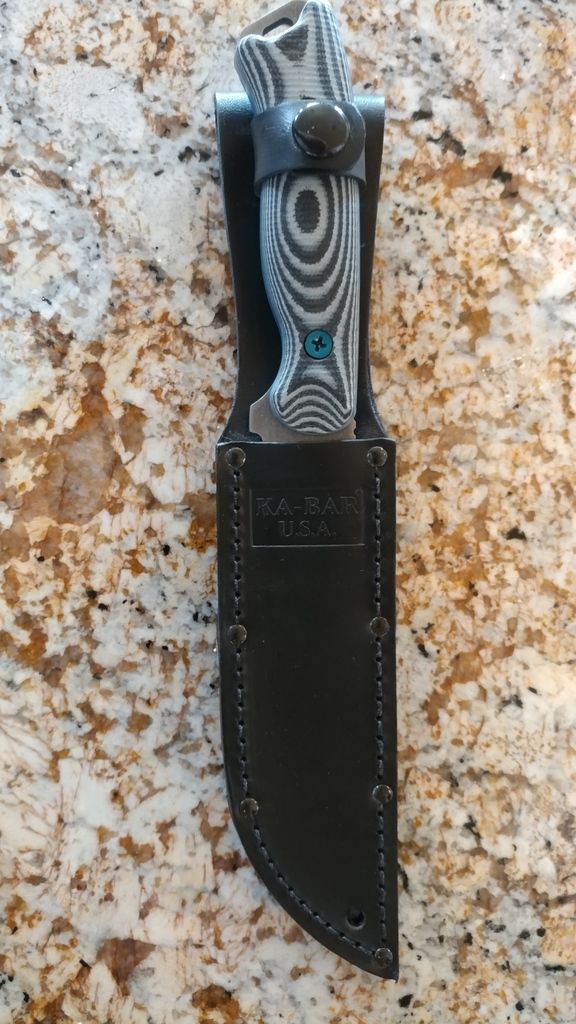

KaBar 4" sheath, until I figure which maker I want to build me the perfect match.
I do rather appreciate the low profile of that one.

@tgswarbrick Cool i will check it out. How does the shorter KABAR leather sheath fit? Cus my usmc sjeath which is obviously longer is pretty loose on the clasp. I wanted a decent cheap leather one for it but if the fit isnt any good...
Fits great, but is still a bit long. Must be a 5 inch model. I'll see if I can double check the order.
Clasp is snug. Had to stretch it the first couple times, but is fine now.
I wonder if KaBar's Skinner sheath would fit a hair better, but only see them in brown. Haven't tested it.
Made patriotic(Swede) liners for the king.
The slightly bigger grip felt great when chopping!

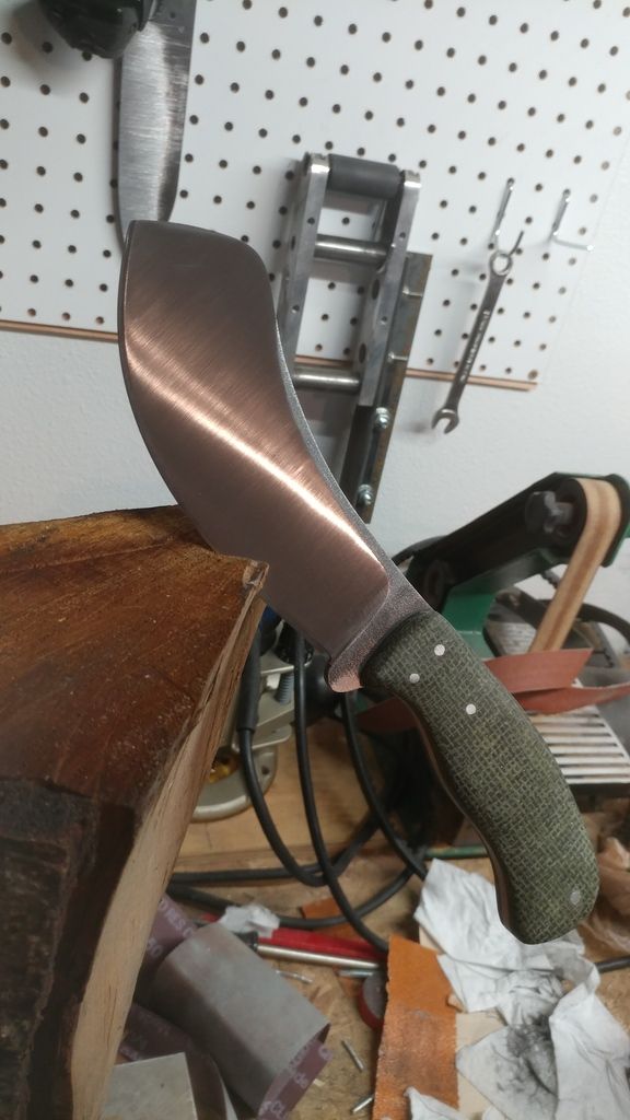

Now that I'm looking at a full size pic, I got one suggestion for ya, Nikki: Shape the bolster part first, with the scales pinned and clamped together. It'll eliminate the grind/file marks on the ricasso and the guard - plus it's a heckuva lot easier to shape that part without the knife in the way. They look great, tho! I'd definitely advocate for getting as much of the guard off as possible when you do yours. Looking forward to seeing the next iteration....
That's a great idea, thanks! I will just hacksaw the guard off as much as I can, and slowly take the rest off with the belt sander. I need to order some more micarta. I might throw some more pins in mine as well, now that I have a better idea of what I'm doing.
