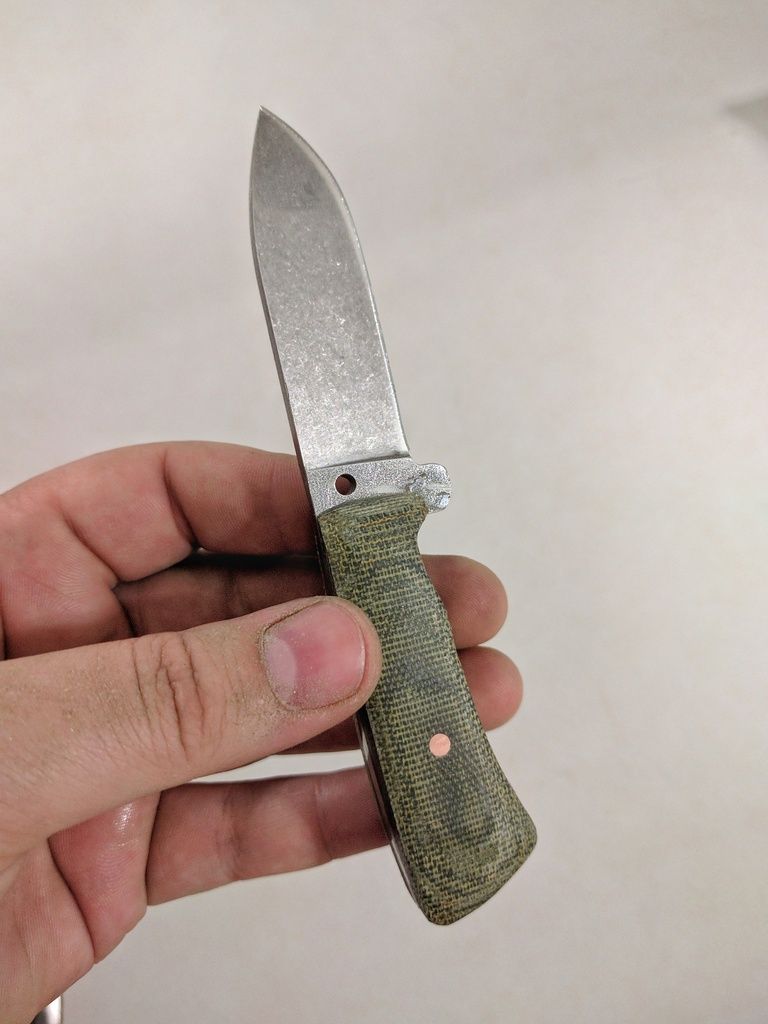

Made my first set of scales this weekend. Just kinda winged it w/my gf's Remora. OD Green Micarta and a copper pin. Still needs some refinement and clean up. My Remora will be next. Might remove the finger guard.
Now that I'm looking at a full size pic, I got one suggestion for ya, Nikki: Shape the bolster part first, with the scales pinned and clamped together. It'll eliminate the grind/file marks on the ricasso and the guard - plus it's a heckuva lot easier to shape that part without the knife in the way. They look great, tho! I'd definitely advocate for getting as much of the guard off as possible when you do yours. Looking forward to seeing the next iteration....
