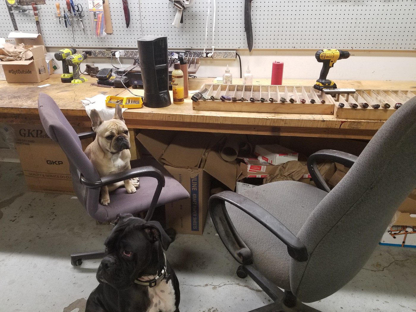

They both look so serious!i got up from detailing the knives to snap a pic of the "Guardians of The Batch"
they take their job seriouslyThey both look so serious!

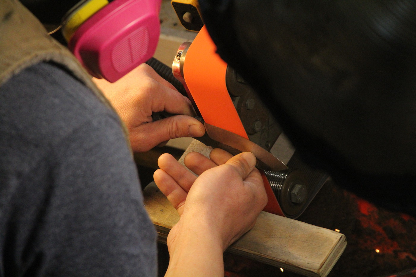

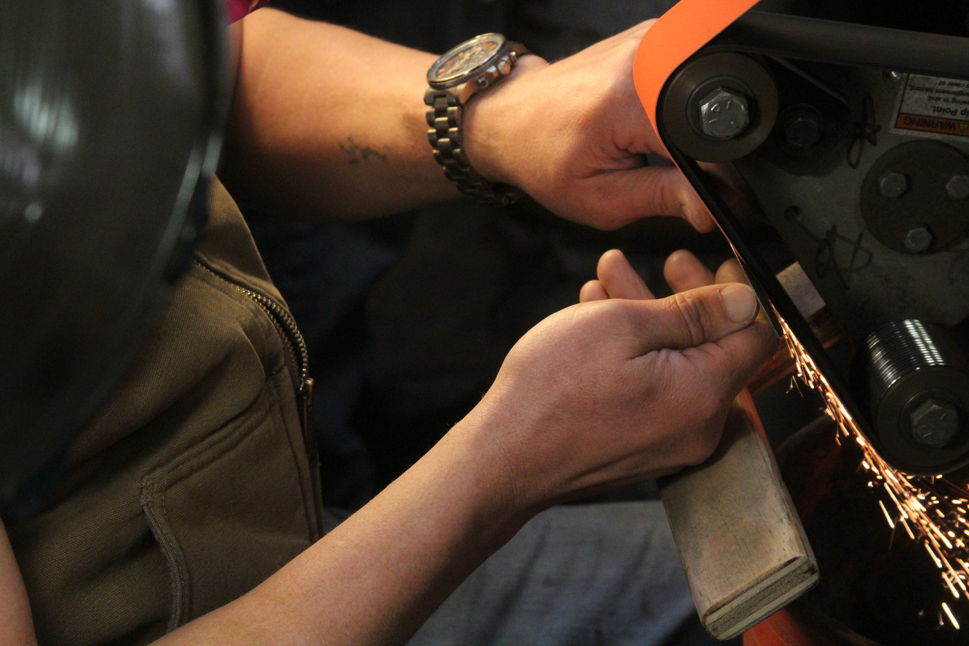

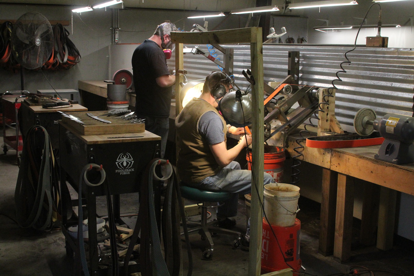

Good Friday AM everyone. I'm very glad to see y'all here. I've noticed more 3/32 in the batches lately. Hopefully thats up y'alls alley. I wanted to chime in and point out how well Kyle has done as he stepped up into Cody's role. Also, hopefully you have noticed a bit of an increase to the quality of the look of the knives in recent months. This is due to three reasons. 1. I finally took John Shore's advice and sat down to do my grinding. This has helped my neck immensely and that was the deciding factor. Also though because your arms are out from your body, I put a rest for my hands. Now not only is my neck more comfortable but my arms and shoulders are more relaxed. There is also immensely more control of my grinding as I have safe places to rest my fingers during grinding. 2. I added two belts to the finish. One is a repeat of the 120 grit belt on finishing day. This really lets me ajust the grind to the handle better, lets me nitpic more on making the edge thin, and matches the bevel to the rotary platen on that day. (the thing is rubber, so every day it is a different beast) 3. After 9 years of refusing to use a buffer, I have started a quick light buff on the handles. Its only a 600 grit polish, and its too quick to mirror polish, but it has done a lot to bring out the depth of the materials.

Pictures or it didn't happen. Thanks for sharing and you've really got to watch the ergonomics as it takes a toll on you.
that's a mighty big gap there between the support and the belt. May want to think about closing it up so that it won't grab your hand or finger.

Between the dust, epoxy amines, and now a buffer, I've got my concerns.... Just keep Phillip off the ladders...Its made to break apart in the event of an accident. It wouldn't work all close in. Its just a hand rest, not a work rest.
BUT. This stuff is dangerous. Get your Fiddlebacks while I still have hands. Once they get torn off the prices will go up.
