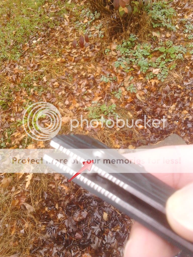

Hey, sorry if this is in the wrong place (BF newbie), but how do I disassemble the axis lock on an older 710? It doesn't have a cutout in the liner to slide it out, and I can't break it down completely to clean the washers without removing it. Thanks!
If I understand your question correctly, the older model Axis had T-studs that were threaded on, w/ no cut out needed into liners to be slipped in, I believe. Here is a bad photo showing a hole in the T-stud where a tool/wrench would be used to install/remove.
Yes, mine has those. So what tool would we use to take them apart?
IIRC, it's a very small hex. But it's been years since I took one of my older 710s apart.
