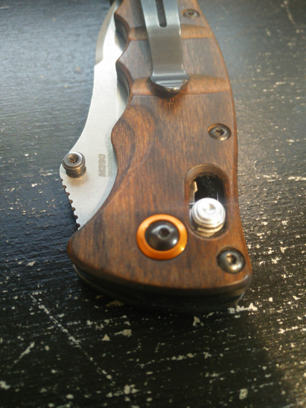

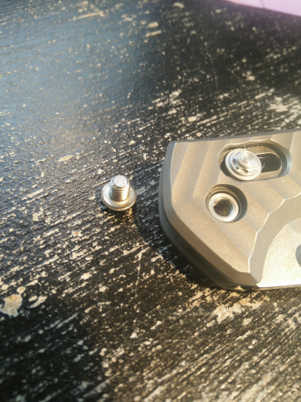

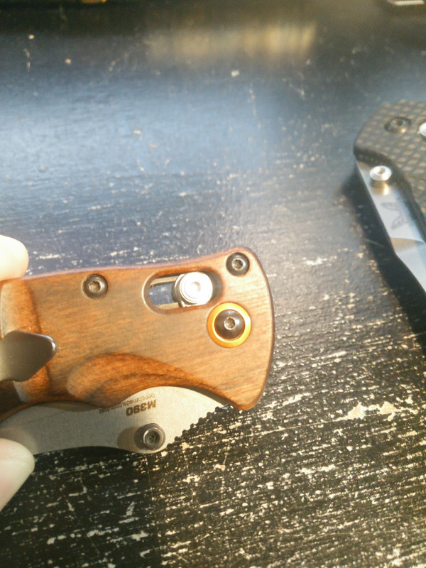

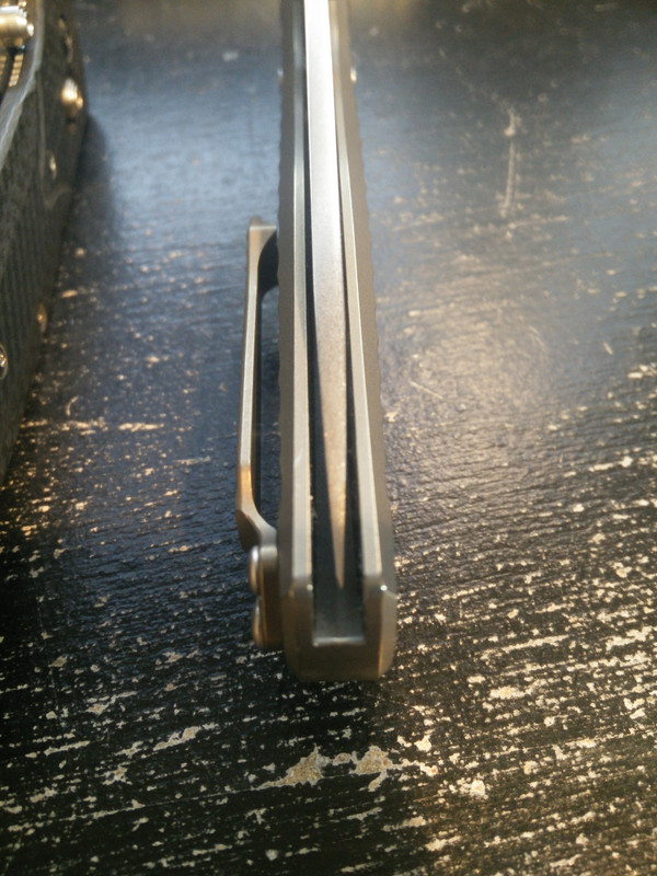

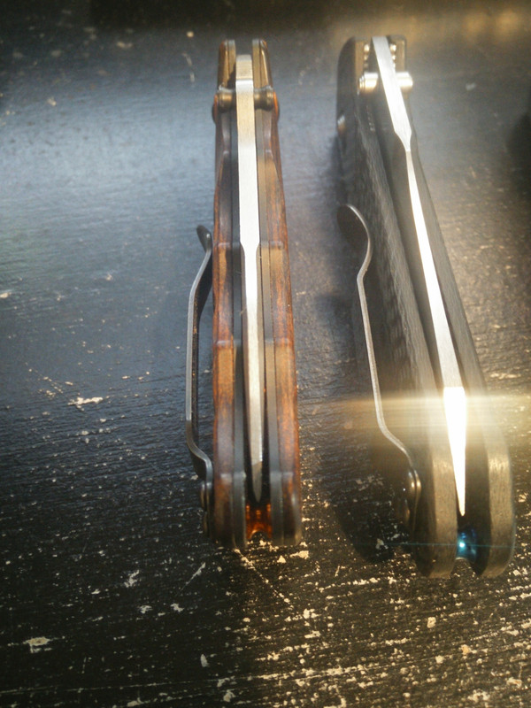

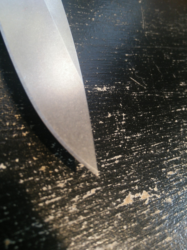

Here's the 3 i currently have. the rest were given away or sold. no pictures. i kept these because i liked them at one point in time for whatever reason. they are decent as a knife minus the qc issues.
the 484 is centered but has side to side AND up and down blade play. adjusting pivot just makes action difficult to open or close. The edges were burnt and lopsided. i have re-sharpened it on the kme so the lopside was not fixed (i dont use it anymore, so i dont bother sharpening it on the edge pro and fixing that, plus thats alot of material to remove). you can see the retarded pivot screw. its out of round and the torx is not centered.
the 940-1 has been sharpened many times in the past, but needs to be sharpened again on the edge pro. its still lopsided because thats the way it came to me like. it has some side to side play but any more tightening of the pivot will make action suffer. and as you can see its not centered. at all. just a sliver from touching. this is extremely common on most 940-1's.
you can see the Anthem is not centered and the tip is lopsided. just the tip. the side profile was too hard to photo without professional camera equipment. but its clear as day in person. you can see it in the vertical photo. i figured after all those threads on how shitty the qc was on the Anthem that they would have resolved the issues on it, but i guess not.
anyways, adjusting the pivot just makes it hard to open or close. and there is NO loctite on the pivot screw.
its also funny that its a free spinning pivot on a $400+ knife too.
