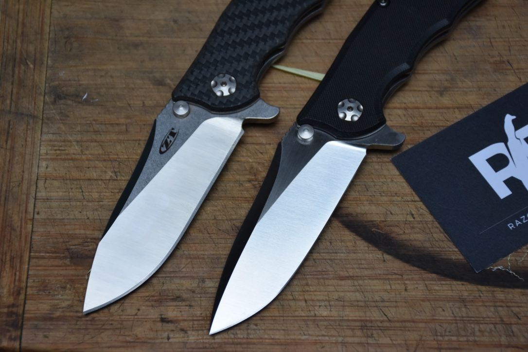

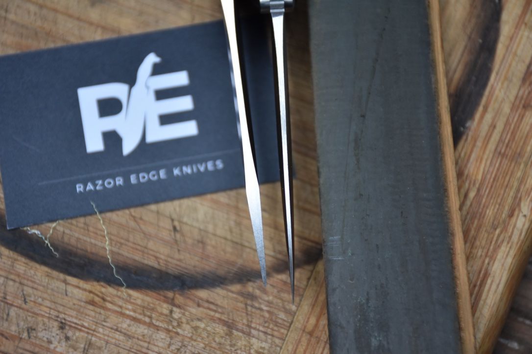

For slicing:
Sharp is better than dull.
An acute edge bevel is better than a more obtuse edge bevel.
Thin edge shoulders are better than wide edge shoulders. Good factor bevel widths are usually between 0.020 and 0.030 inches at the edge shoulders. But the best slicers are much thinner, usually below 0.015 inches.
Thin blade stock is better than thick blade stock (0.10 inches and below).
Blade grinds are also important. Hollow grinds cut better than full flat grinds which cut better than saber grinds.
Josh (Razor Edge) did a regrind of my ZT 0562 that did all of these things, and the results were crazy.
Here's a comparison of a stock 0562 and the regrind. Notice how narrow the edge bevel is on the regrind vs the stock. Both are 30 degrees inclusive:
