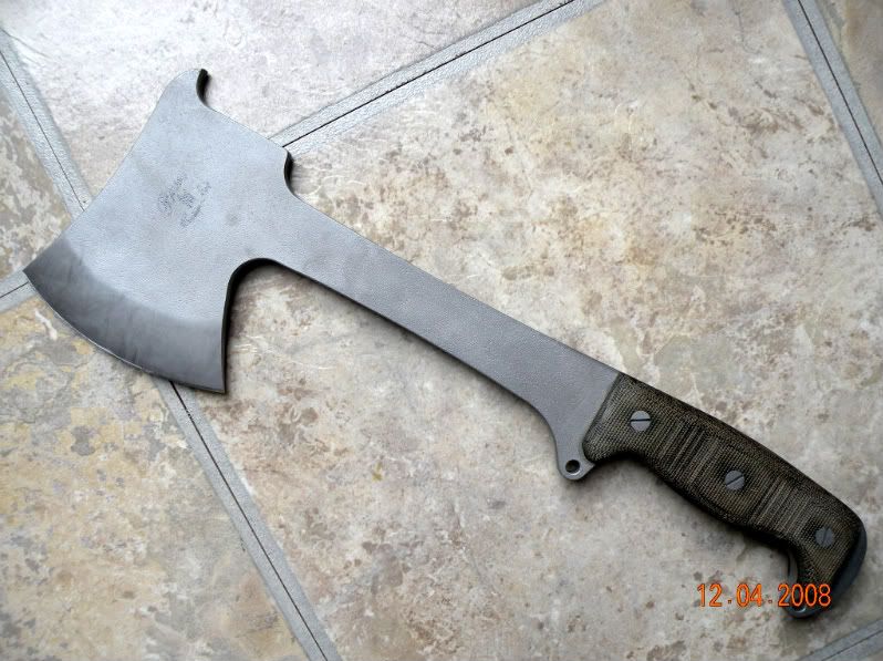

^^^^^^^^^ Screws look cool..... :)
screws and stand offs beat solid pins in every regard. you can replace them as a customer, they are just as strong if not stronger since they are held to the tang where the scales can come away from it with straight pins. and they aren't as heavy as a massive 1/2" diameter pin.

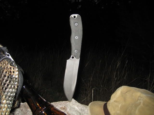

Man that looks sweet:thumbup::thumbup:,, I am close to finishing my hand satined SAR5, and now I am thinking the screw mod might have to be next:D, what type/size etc,
Any info would help, Thanks!, Wade;)

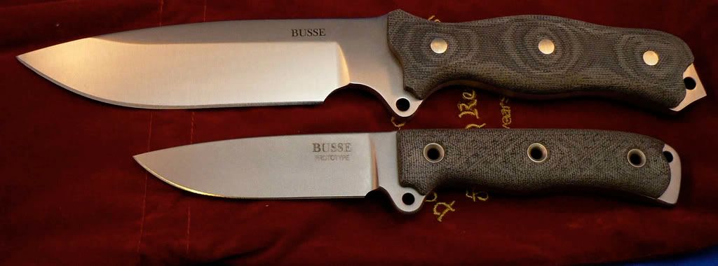

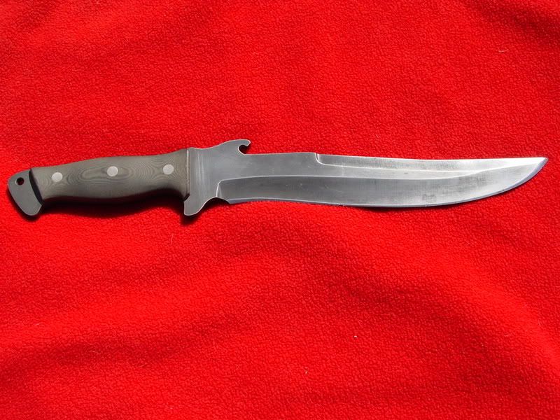

old pins:
old Chicago/sex bolts:
new pins:
since busse has produced a run of pinned scales (including a lot of custom shop work with pins), I'm pretty sure you could send a knife in to have the tubes replaced with pins.
