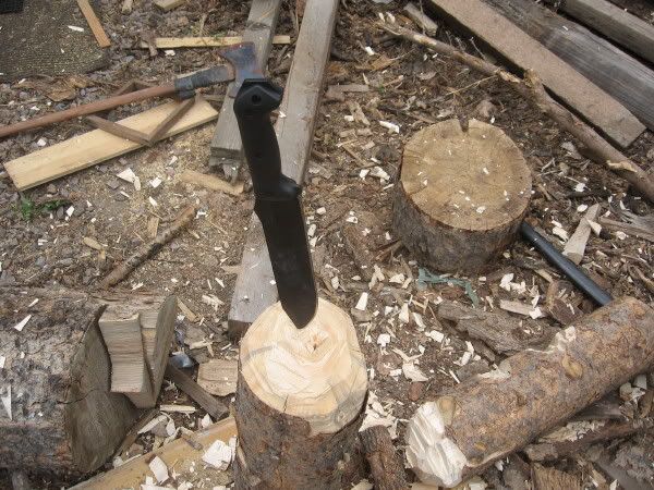

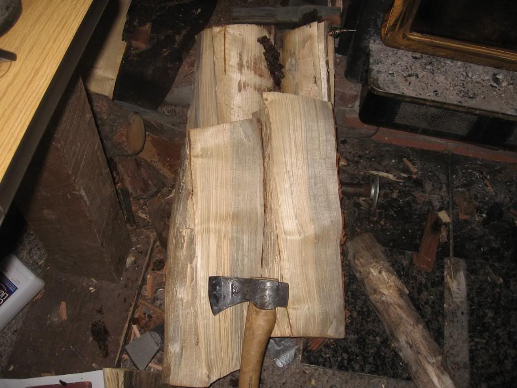

This is how I split with a hatchet or large hunting axe with a 19" handle. Use a baton and start on the upper edge.
The geometry of the Bit splits the wood. Once the split starts, rotate the log around and do the same on the other end.
Pow, the logs splits, no wedge, no fuss.

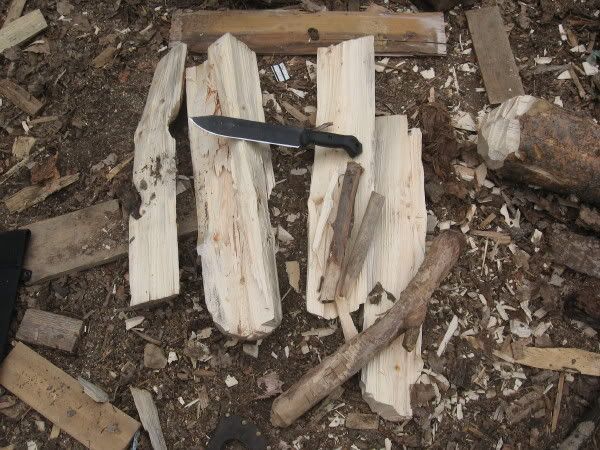

As you can see with the BK9 on top, the log was too large to split with a 10" blade. The geometry of the bit does the work for you.
Then, go at the pieces the same way. Logs split much easier when you come at them from the side rather than the top, and use a baton. Smaller stuff is easily split with a top strike.
The hatchet is a Wetterling 19" large hunter. Hand forged hatchets rock!!

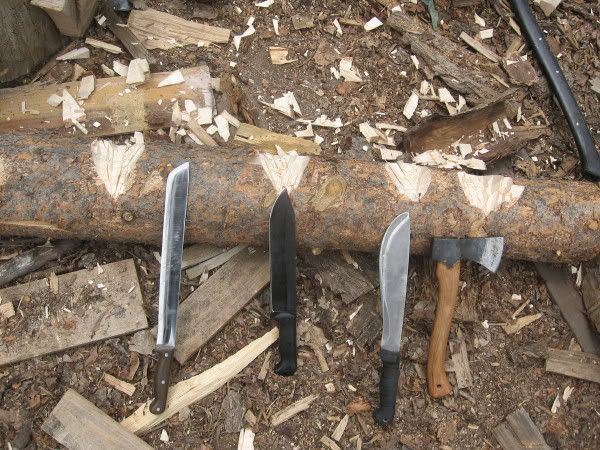

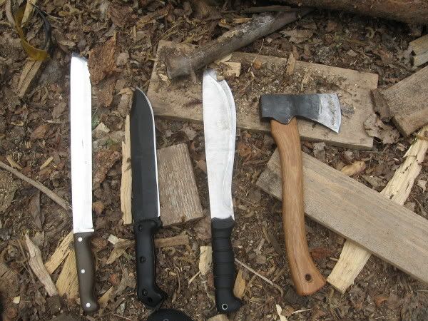

A little chopping test I did. My 13" 3/16" stock O-1 golok, BK9, Convexed 11" cutlass machete, and my 12" Husqvarna hand forged hatchet.
After same number strikes.
All were fairly close, but the hatchet was a clear winner.
Same wood as the log I split with the 19" Wetterling.

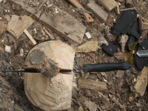

15 degree bend in blade, and a wedge to help with the split.
After about 5x the effort, the smaller log is split.

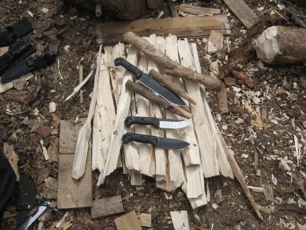

The Bk2 took over and made kindling. Convexed from the primary grind down.
It was way easier to split the log with the hatchet. The log I batonned was not nearly the size and still took way more effort. There is a reason that axes developed in the northern latitutes where hard woods dominate. They work better for wood processing, and the smaller knives do the cutting. :D

Thanks for the comments, fellas. The Wetterling and the Husqvarna are both convex ground. Wetterling makes the Husqvarna line and is owned itself by GB. I convex most all my stuff. The bk9 is convexed on the edge also. My 12" Husqvarna hatchet is under 2lbs with sheath and it's not the mini. My golok is 19.4oz without a sheath. They are comparable in weight. The real issue is what you are going to be doing and what you prefer. Eat a couple less bites of oatmeal in the morning and you will make up the weight difference. :D

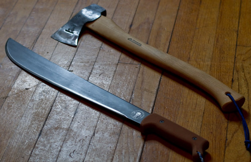

It's a 1.2lb bit. Once you add in the handle and sheath it comes in just under 2lbs. The Husqie has a thinner geometry than the Wetterling. Much closer to the GB geometry. Here is a pic of my mini Wetterling next to the 12" Husqie. You can easily see the thinner geometry on the Husqie.
