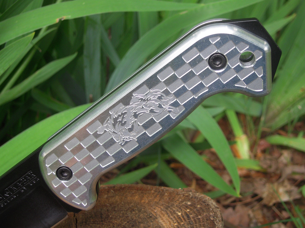

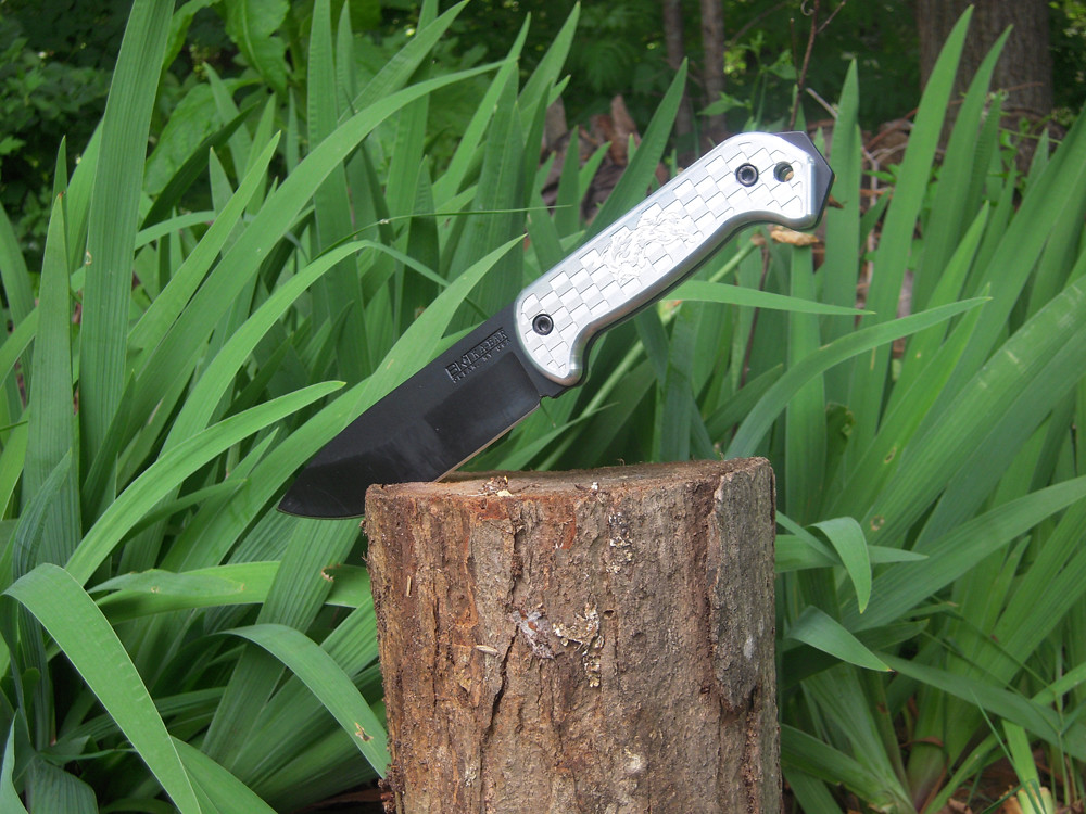

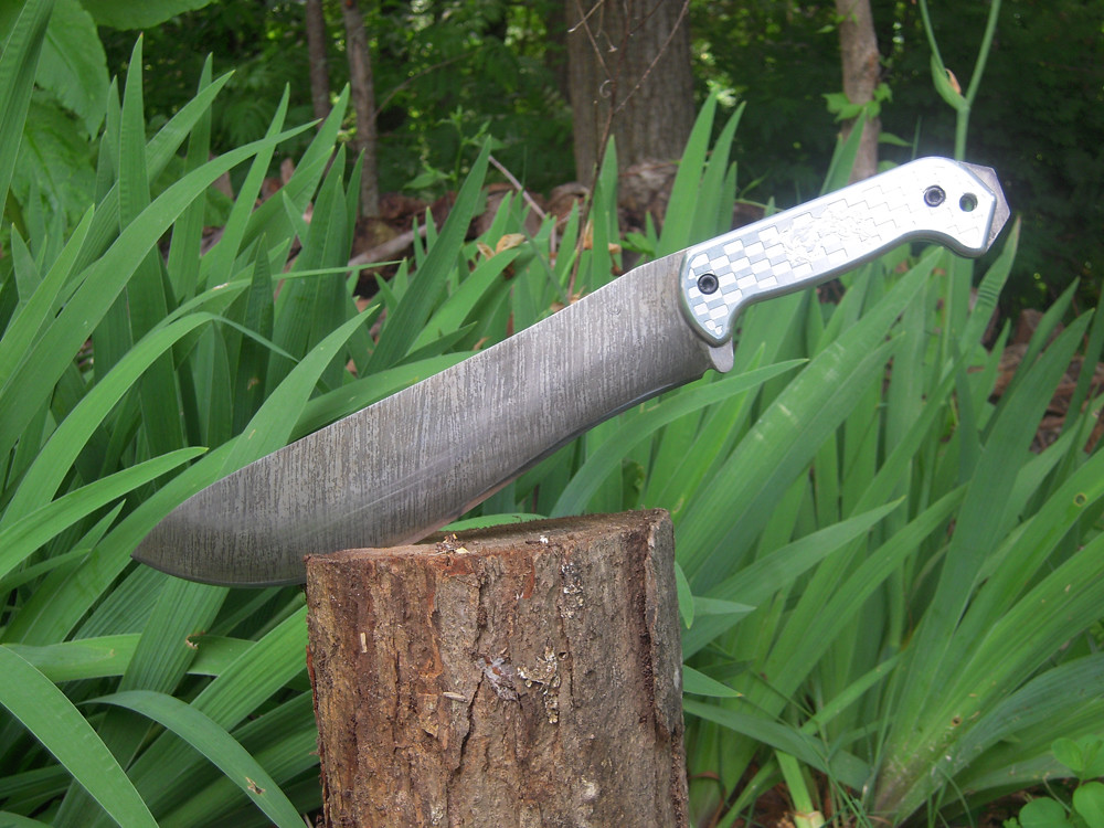

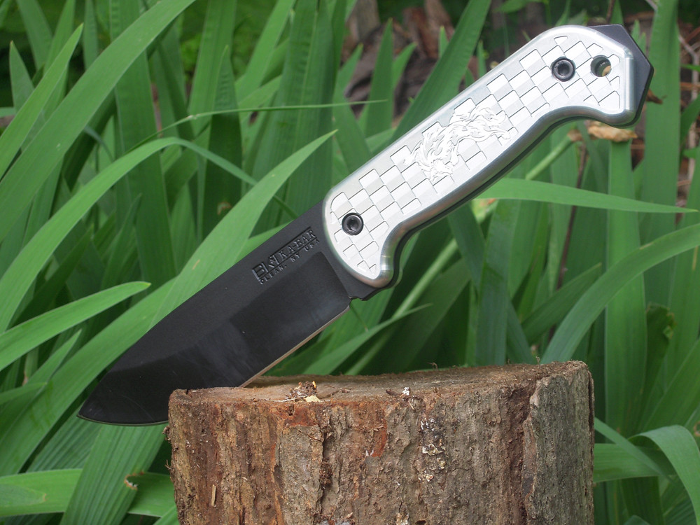

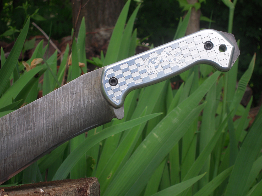

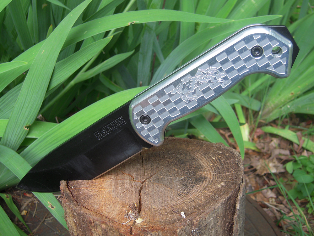

Alright, here are some pics. I may not like the ergonomics of 'em, but they sure do look purty. On Sheila they really make her patina pop. The new forum software likes to resize stuff, so if you want to see them at full size (1000px x 750px) right click and view image.
So, my review was already up, but after fiddling with them a bit today, I also noticed that the holes where the nuts go is a wee bit exact. Stock nuts, or the ones Sh@rp provided will fit, but bigger nylon locking nuts will not. Not really a criticism so much as an observation there.
They look stunning on a knife though, and with the black screws on the black blade of the BK2, looks positively gorgeous. You get some curves to ones of these, and I will find myself getting a pair for sure. All in all, great work Sh@rp!
Very nice pics, Derek. With your permission my friend, I would like to use some of your pics. About the lock nuts, I found out the full standard size has too much tolerance among them and they would not seat flush below the scale's surface at all. So, I searched for the low profile that will seat below the scale's surface and has not too much variance in tolerance. Also, to be safe I enlarged the hex size .005" bigger. That would take care it. These were the 2nd prototype sets after all. I know 1066vik would be a proud owner. Thanks for your review Derek. I'd love to hear all the inputs. Keep 'em coming gentlemen. I really appreciated this forum. Thanks, every one.
