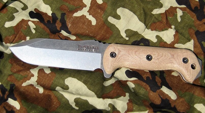

Just a couple of mods makes it a damn fine bushcrafter for me.

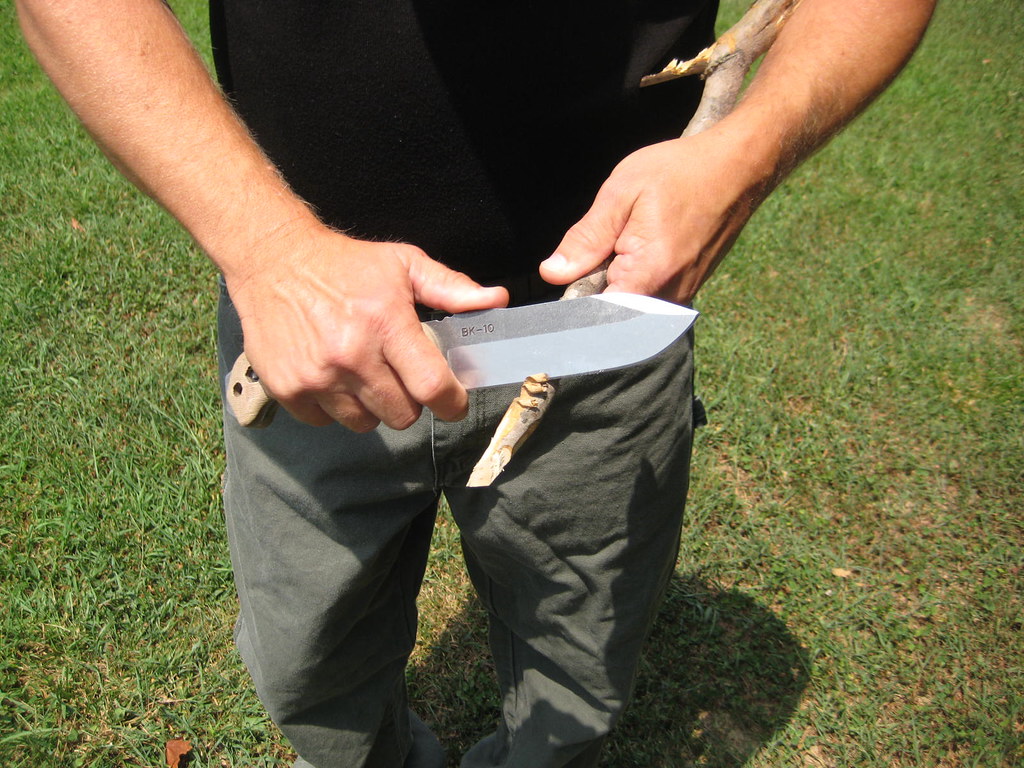

I lowered the ramp one notch. I don't really mind the ramp, but wanted to be able to put my thumb on top of it for push cuts and control cuts. It feels like jimping now. Softened the "rhino horn" just a little for looks, didn't want to get wild here because it drills so well. Squared up the spine (I do it to all of 'em) and finally, yes......I choiled. I couldn't help it. I like to get close to my work.
Oh yeah, I shortened up the sheath by folding the top down and zip tying it for a higher ride.

Nice work trade, she looks great.
That looks nice tw. Would like to see a better photo from the side though. Hard to see where you ground the top of the thumb ramp down, with the grass in the background.
Ok so im finished modding it now. So lets recap, I ground the clip point, added firesteel notch, squared and did file work on the spine, ground choil, convexed it, polished the blade to bright satin, reshaped the guard, took off finish and blued it, and now added custom wood scales. It was my first try at wood scales and the bocote was an awesome pattern. the countersunk holes arent the best (off center since my stupid ass drilled the bolt hole first instead of the other way around) and i wasnt even going to attempt to try and chisel out the hex shape hole for the nuts so i just made em a little bigger so that i can get in there and hold the nut with a needle nose. next ill do wood for the bk2 and i think ill picn and epoxy them instead. I Shaped em with a belt sander, rasp, and dremel. Hand sanded to 250 grit. then coated with gloss poly. This was a fun project and she now my favorite hunting/hiking buddy. TIME TO GET HER DIRTY!
