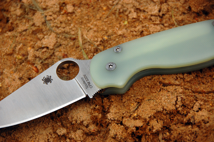

When you guys talk about the angle, do you mean the entire "whitish" part of the edge in this picture...or like a microbevel? If this M4 is 21 degrees per side, does that mean that putting it on the sharpmaker even at 40 degrees would not sharpen it right away, bc you are not hitting the edge?
So the bevel is basically as you said, the area at the edge. Basically the edge from the cutting edge back to where the angle changes at the next grind. If you put the edge on the sharpmaker at 40 inclusive you wouldn't be sharpening the very edge because you'd be too shallow. Of course a minor tilt of the wrist would fix this. BTW, 40 inclusive means the overall angle total. Basically divide it in half and you'll get the angle per side, which would be 20. Spyderco usually does go lower than most companies, but like all companies the sharpening is done by hand so there's definite variances in the angles on any knife. Most companies stay at 23-25 degrees (46-50 inclusive) on their edges, which allows the knife to be used harder without worrying about edge roll, chipping, etc... Many people will sharpen their edge to 20deg per side, then lightly sharpen at 23deg or so, which creates a small microbevel right at the cutting edge that promotes sharpness and prevents edge roll and etc... Most factory razor blades do this. The edge will be 8-10deg per side with a 15deg microbevel (on factory razor blades that is). Edge geometry plays a massive roll in how the knife performs. A degree or two is a massive change. It's why I redo most of my edges to 19deg (38 inclusive) with no microbevel. Works great with most modern steels and slices fantastic 😊

Thanks man. So when you say no microbevel, do you mean literally the same cutting edge angle all the way to the spine of the knife, pass the spydie logo?
No, just the standard cutting bevel with no additional smaller bevel. The area behind the bevel (basically the side of the knife) is called the grind. So you have a primary or secondary grind. So like a Benchmade Griptilian, starting from the spine to the edge you have the primary grind, secondary grind, and finally the bevel. However on a Morakniv you have a primary grind, and then bevel; because it is a scandi grind. If a knife has no bevel and the primary grind goes straight to the edge with no bevel, then you have a "full flat grind" also known as a "zero grind." However you can also have a blade configured with a primary grind, then secondary grind with no bevel, which is called a "saber grind." If you want a clearer picture, contact Spyderco and request a catalog. It's full of info - glossary, steel chart, handle materials, lock schematics, and also all the major blade grinds. It's a great wealth of information and it's free :)

Thanks. Great post. I actually have spydercos catalog , but on the pictures - I wasn't sure how "zoomed in" the picture implied.
It can be a little confusing at first, but just look at the picture with a blade in hand and match it to the pic. I think the most confusing part about the Spyderco pics is when they talk about swedges and false edges. Again, using the Griptilian as reference, you have the primary grind, secondary grind, and bevel, but towards the tip there is another grind that slants backwards. That is a swedge. If it were ground to an almost-sharp point, it would be considered a "false edge." Both aid in thinning the tip for piercing and/or reducing weight and friction from drag. Obviously the false edge is just an extreme swedge made for more piercing without a true secondary bevel (in other words, another true cutting edge). Hopefully that clarifies some of the images in the catalog ;)
