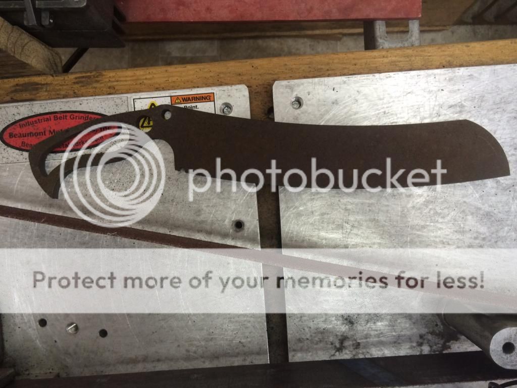

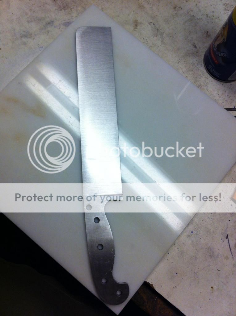

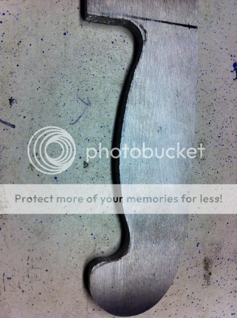

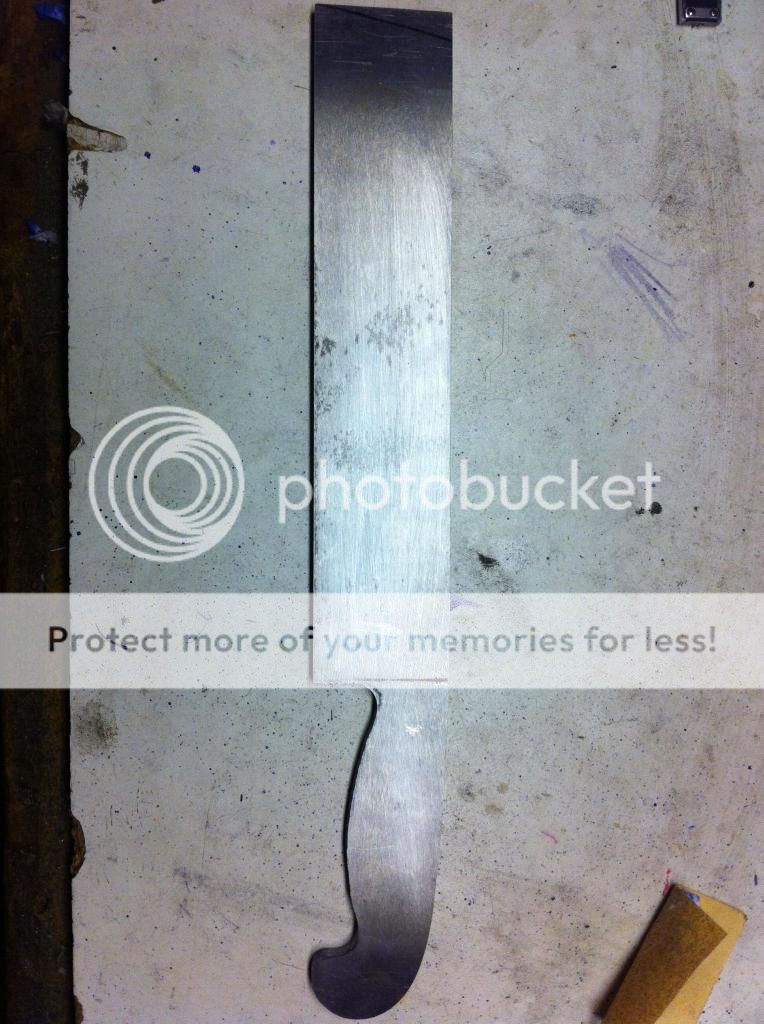

Alright so my first Bladesports style chopper has begun. Jose Diaz is generous enough to sell me one of his Cane Toad Chopper blanks and I wanted to do this one as a practice before I start that one. Knife steel is 0-1 and it's .25in thick. I have the handle most of the way shaped and just need to figure out where I want to set the plunge and how i want to contour the "tip." I also might need to figure out where I want to put the front lanyard hole.
If anything jumps out to you guys as things I might want to change please let me know. The actual blade profile has not been formed yet as I was going to see what you gents had to say about it. There's a little wiggle room on the handle for grinding but obviously can't add back on. It fits my hand pretty good but has a decent amount of room on it to. Should i skeletonize the handle? Also, does anyone one have any recommendations as far as a target HRC hardness for when I send it for heat treat? I had planned to send it to TruGrit(I usually use them and I get 50% off on my next batch) but am wondering if I should break down and send it to Peters because they work with Bladesport knives a lot...
Anyway here are some pics, let me know what you think.

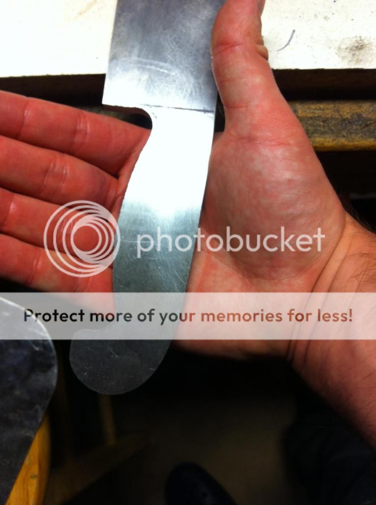

Probably... Grind the blade the way you want and temporarily put handles on it so you can see what the balance is like. Then if it's not tip-forward enough you can start drilling/skeletonizing/tapering the tang until it feels right.
Good advice James, thanks. I will do that.
Do you have any recommendation as to what hardness I should shoot for with this guy? I've done O-1 choppers around 58 hrc in the past but I wonder if I should aim a little higher being that it will need the edge retention.
It is hard to tell from the picture how tall the handle is. I can tell you from experience I had this weekend not to make the handle of a chopper too round. The handle I designed was a little short so I made it more round/fat. It did not chop well at all.

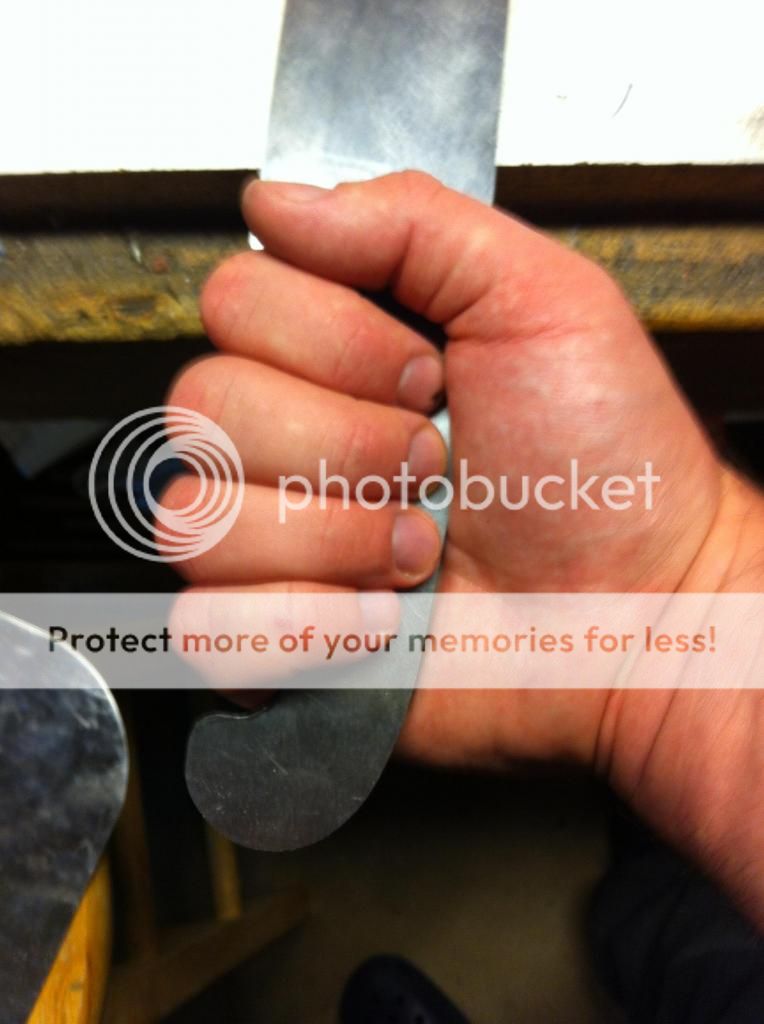

I designed the handle after the handle on this knife. The one on this bladesports chopper will have more angle in the handle though:
I've been researching a lot into designing this blade and you're right Dan, Donavon and other bladesports guys have been awesome in providing their insight. Here's a great video from Dan about handle shapes:

I should be grinding the pre-heat treatment bevels tonight. It looks like, for a full flat grind, I will need to grind them at around 4 degrees. I'm planning on doing a 15 degree(30 inclusive) edge from there and then possibly convex the shoulder of the edge bevel a bit.

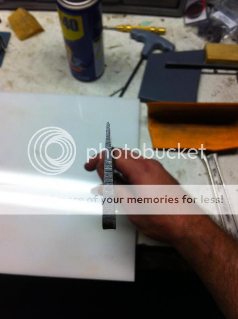

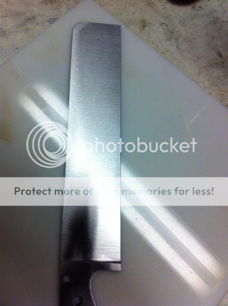

I finished the pre-heat treat bevels last night, here's a couple pics.
I still have a little profile work to do and will probably put in a sharpening notch. IIRC bevels were right at around 3.8 degrees and went just under full height. I'm thinking I will probably cut some holes in the handle to lighten things up.

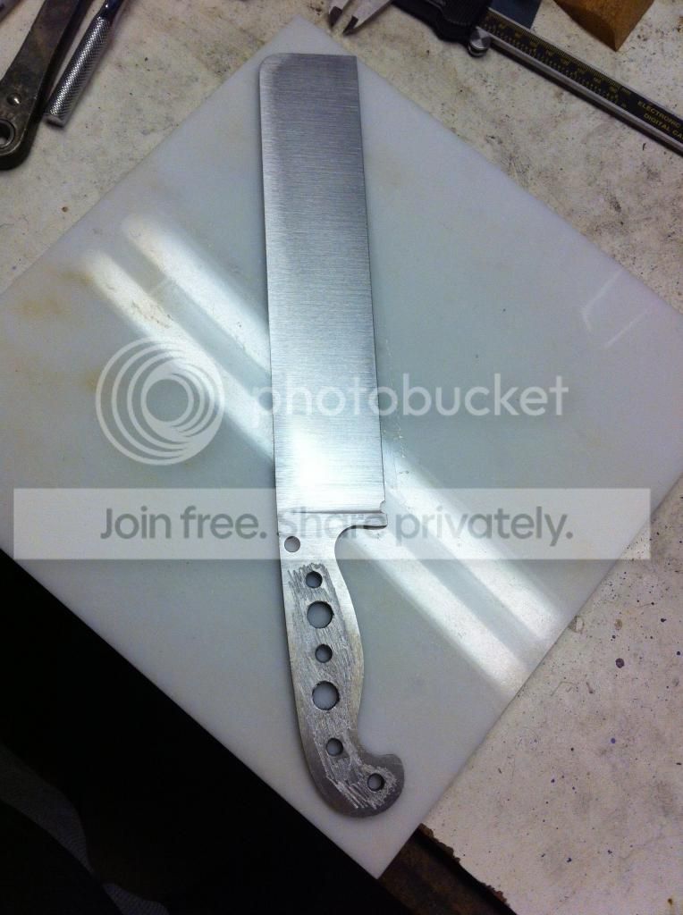

ETA: Pre-heat treat work is done:

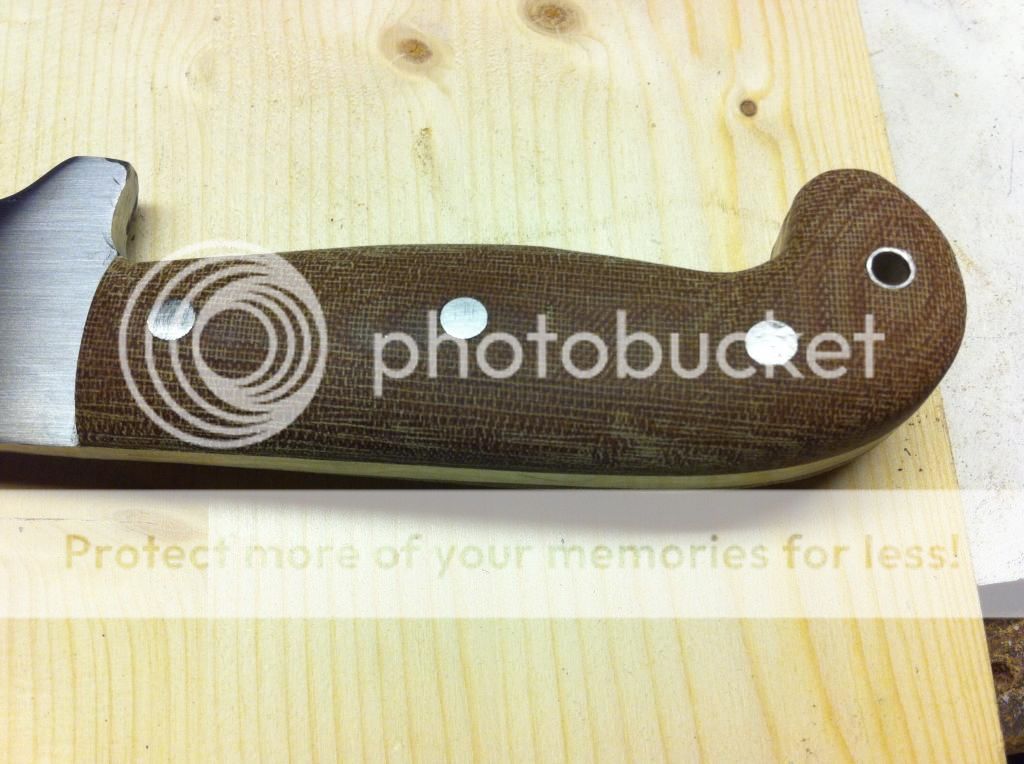

I've hit a little bit of a snag guys. I planned on using horse stall mat for the handle but I'm wondering what to use for pins. I spoke with Jose Diaz today(my Cane Toad Chopper is getting shipped tomorrow) and he said that rubber O-ring material works good for pins. The problem is that I already drilled the pin holes out to 1/4in thinking I would just use stainless steel pins. The only O-ring material I could find was 3/16in.
Another issue is that with the Cane Toad Chopper Jose is sending me the entire tang is skeletonized aside from a lanyard hole and a 1/2in(I think) hole towards the front. I'm not sure if I should even bother with pins or just use a tube for the lanyard and a bunch of G-Flex. Here's a pic of it:
Anyone have any ideas as to what I should use for pins? Hell, I think some of the guys might not even use pins. If i use hard pins I wonder if it will effect(create a hot spot) the grip when it's squished?
Glad to see your project is moving along. Looking good.
Bladesports requires at least one pin through the handle. As far as the hot spot you mentioned, the rubber I use doesn't compress enough for the pin to be felt. I put two in mine. One at the front for a lanyard and one about 2/3 the way down the handle. And I use 5/16" tube for both.
