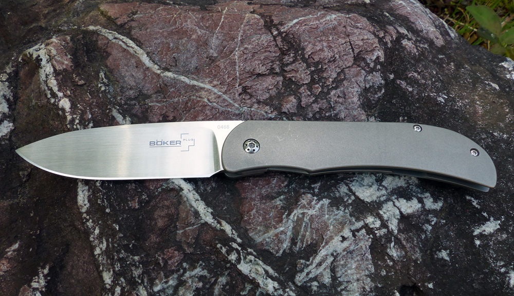

I just got my first Boker knife, Boker Plus Exskelibur I.
Here are my first impressions.
Specifications:
Blade length: 3.50"
Closed length: 4.69"
Overall length: 8.12"
Handle thickness: 0.31"
Weight: 3.05 oz
Blade steel: S35VN
Blade thickness: 0.11"
I really like the Skellern/Burger design. It is very clean and concise yet functional.
And the knife is very slim and disappears in a pocket.
Mine has Ti scales. They are bead blasted and have a feel similar to that of Umnumzaan scales.
Each scale measures about 0.059” or 1.5 mm, and the knife itself is only 0.35” thick.
Very slim!

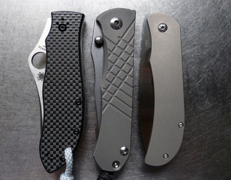

Here is a comparison with Manix2LW, GB1, and Umnumzaan (Exskelibur on the left end).

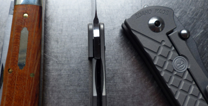

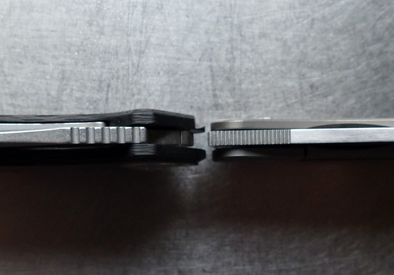

Side view with GB1 and Umnumzaan.
My blade is 0.105” (or 2.67 mm) thick. It is one of the thinnest frame-lock blades I have seen.

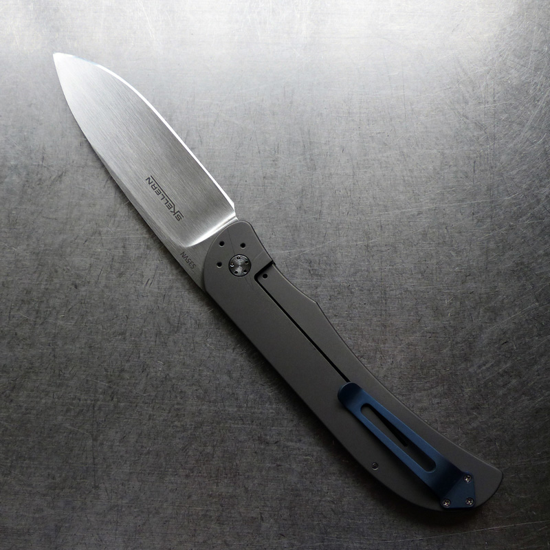

The blue anodized clip looks great and works great. It comes as a tip-down carry clip.
I moved it right away to the other end.

First, the screws are very tight and ridiculously soft! The knife comes with a torx screw. It cannot move the pivot screw. So I used my torx driver to unscrew the pivot. It became loose but did not come out and stuck in the middle. I also rounded the screw a bit during the process, although I put almost my entire weight on the tool. Since the lock side screw is not a torx but proprietary screw, I could not hold it. I managed to unscrew it by pushing the pivot against a rubber band. But it was ridiculously tight….. All other screws are also really soft and can be easily rounded, which I did on some (You can see my struggle on the second picture around the pivot area).
If you disassemble and clean a knife often, I would not recommend this knife.
(Update: I think now that it was due to overtightened screw. The knife was not priperly assembled, such that whoever assembled it in the factory overtightened the pivot screw to compensate for the misalignment. After aligning everything right, it is very easy to disassemble it without a special tool.)

A quick measuremts.
The blade thickness I measure is 0.105" (or 2.6 mm) with my caliper.
The thickness behind edge is around 0.015" or probably less.
Impressive......
For a comparison, the blade thickness of my Umnumzaan was 0.135", and the edge thickness was 0.027"

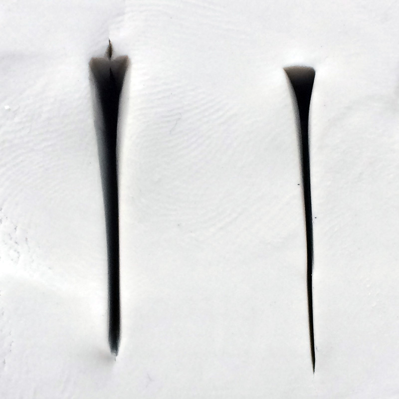

To visualize the thinness of it better, I stabbed clay to mold the blade shape.
The right hole is made by Exskeliber, and the left by Umnumzaan.
Although the shapes do not perfectly capture their blade grind, I think the difference can be easily seen between these two.
I will do more comparisons later with this technique.
