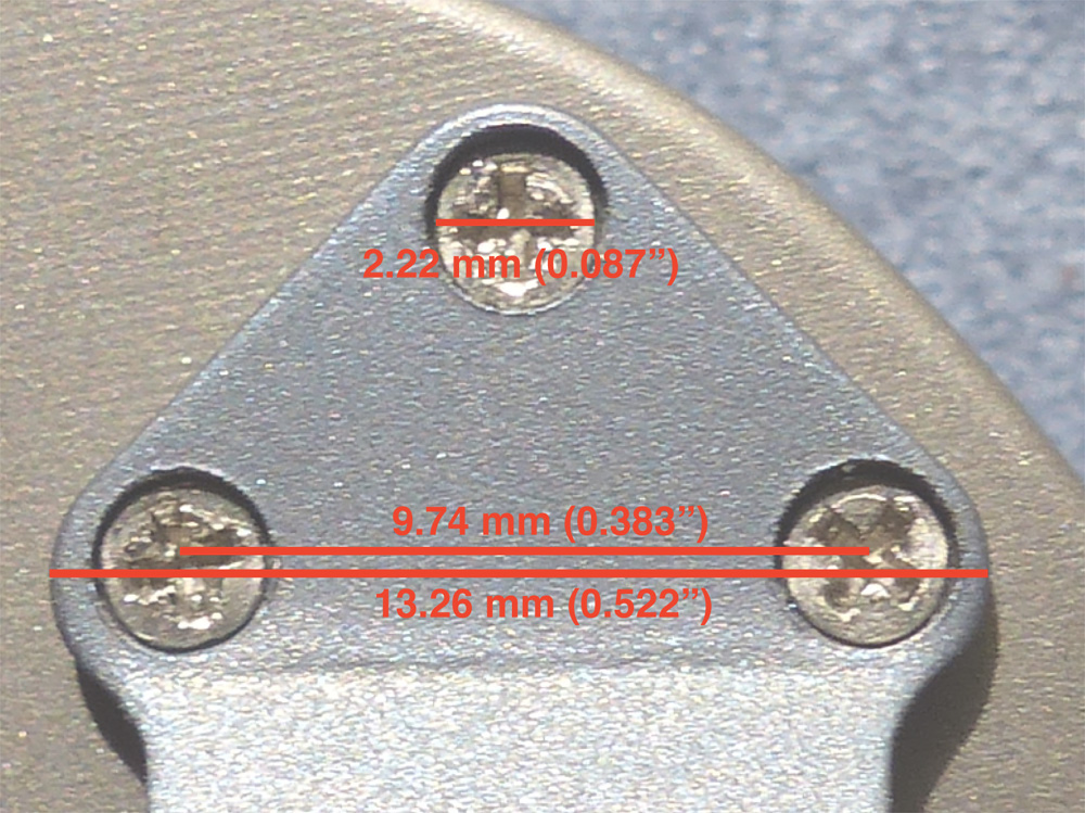

Oh I dropped one measurement.
The thread diameter of the screw was 1.48 mm or 0.058"
Seems like it is #0.

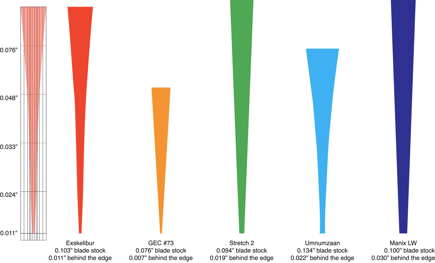

Just for fun, I modeled the hollow ground blade of Exskelibur I based on my measurements of the blade thickness at different points.
Measurements on Stretch and Manix were done where the blade widths are about 1", and the blade thickness indicates the value at that point, not the thickest part.
Edge bevels are not shown, but they are all sharpened at about 15 DPS.
Also, the flat part of blade is not shown for Exskelibur and Umnumzaan

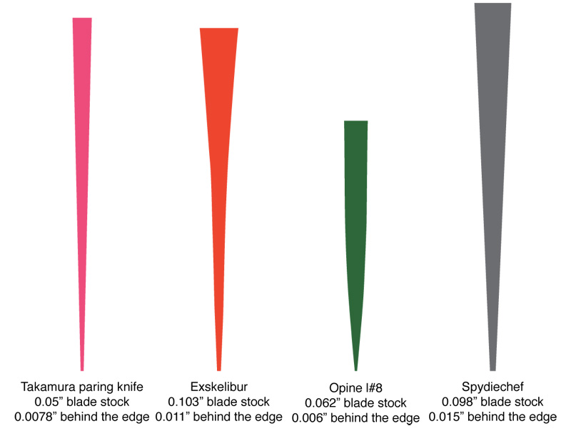

This shows why Exskelibur I is a great slicer. The blade shape really rivals that of a small kitchen knife. Spydiechef is on the thinner side of the spectrum, but still much thicker than my Takamura paring knife.
