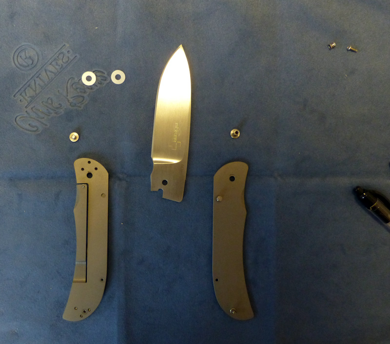

Disassembled.
This was my first knife with teflon (or nylon?) washers.
I was a bit anxious about their operation and durability.
Although I cannot tell anything about the durability yet, the operation is very good.
The opening is as buttery as my Umnumzaan.
I learned that the author of "The Tactical Folding Knife", knifemaker Bob Terzuola, speaks highly of teflon or nyatlon washers.
This relieves some of my worries on the durability.

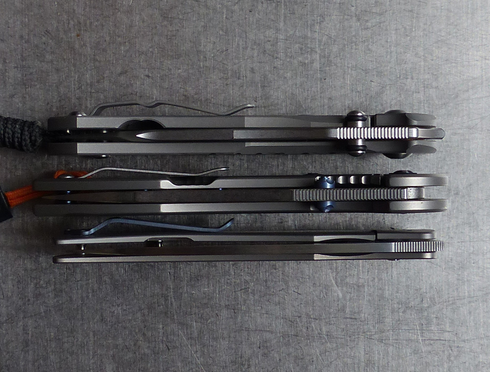

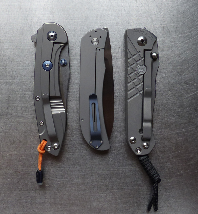

A few more comparisons with two Ti frame lock folders, Southard Told and Umnumzaan.
Hope you can appreciate the very simple construction of Exskelibur.
The lock bar is much thinner than the two more robust folders compared here, but is as thick as a liner of Spyderco GB1, i.e. not really flimsy.
