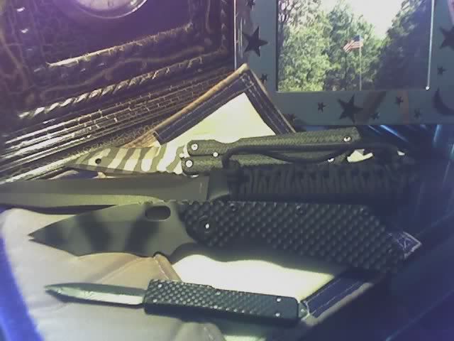

I would pick :
http://i108.photobucket.com/albums/n3/Darkestthicket/collection.jpg
the lil beauty in the center, using the triscula grind for its intended purpose and advising the Cop I had, and could point to wound marks showing the fact that i tried to de-escalate rather than just go stab happy for a kidney or something, a couple of terzoula scrapes on the arm should be enough to prove need of additional force as necesariy as my assailant had proven more than willing to stick around while i had only defended myself and more than likely proove that said assailant was more than willing to do more than triscula scratch level damage to me. (cant find appropriate word, scratch doesnt do it justice) I think odd looking self defense blades when used properly can actually help a self defense case. They shouldnt be maligned for their odd looks.
